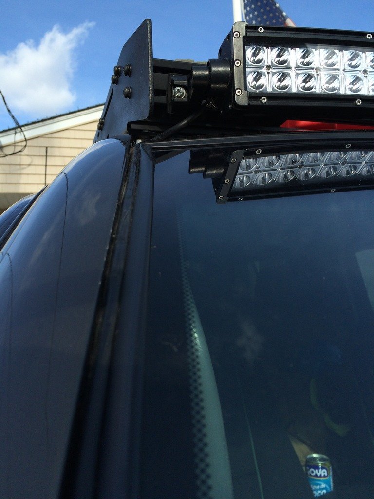

    Chux how do you have that light on your cab rack wired?

    The light bar? I ran the wire down the pillar and into the engine bay to power it off the blue sea fuse panel, then ran the wiring for the switch into the cab.

    Down the pillar near the windshield or did you drill a hole and run it into the cab?

    Down the pillar. You can see it in this pic, but it also blends in super clean.

    Did you just push it in there or did you have to remove that rubber stripping to run it there?

    Didn't remove anything. It's like the channel running down the pillar is meant for it, it's shaped like a gutter and just slightly smaller than the gauge wire coming off my light bar. I used the blunt end of a large file and a mallet to give it some love taps and set it in place.
