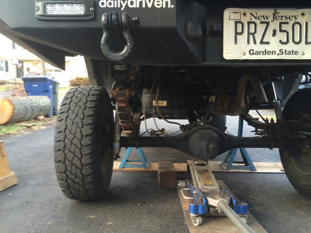

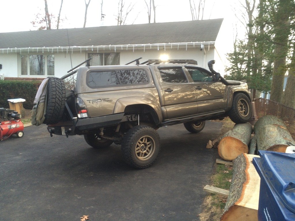

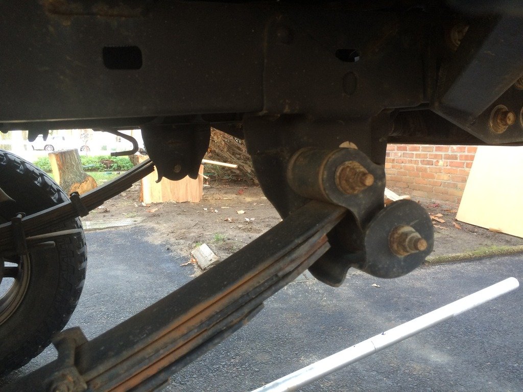

    Shackle flip
    FC8E36A0-BFA1-410B-A320-E7CC3994A383_zps_ff3fbde2d318f78f43cc17c7a93cc2897f411604.jpg
    Thanx @JLink for the help. Always fun catching up, drinking beers, working on the truck, drinking beers, bull shitting, drinking beers, working on the truck, bull shitting, and working on the truck. Total install time 6 hours, actual modding time 3 hours. :D

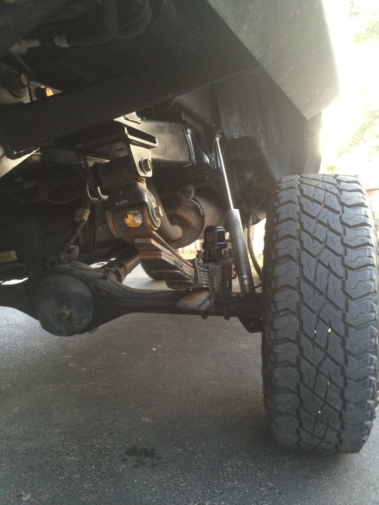

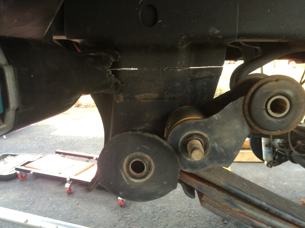

    To start here's the before..
    09C141AE-B0E8-4EA7-851A-ACBFF024C5B6_zps_01f3353a0afb63ce0e5cd459ed11295452300aeb.jpg

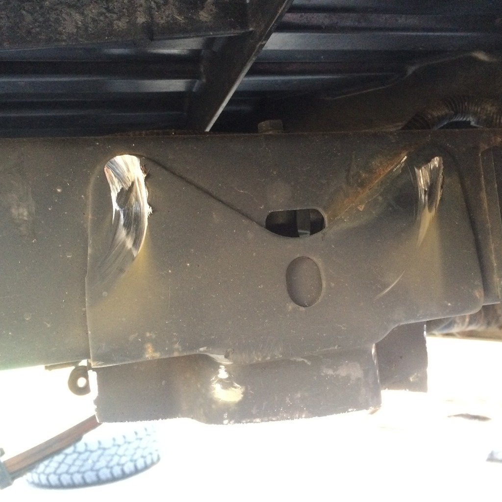

    Unbolted the shackle and cut off the bottom of the stock shackle mount because it was in the way of dropping the leaf pack
    9A0DD76E-97C6-4703-BABA-7D0220F44BDE_zps_1536360d2a0ce5c30a29a7eeb0689c184d161c44.jpg
    Ground off rivet heads
    EF353C0B-07CB-4191-9419-1FCC125BBC0E_zps_183b34b8e7ff05d6ca127c2cf18f95c4899d2267.jpg
    This is where we ran into trouble trying to air hammer out the rivets. We were using a small compressor on hand with a 3/8 hose. The rivets were more than reluctant to budge. Fortunately we we able to get a larger compressor with a 1/2 hose. Grinded the rivets a little more for good measure then with the new setup with the air hammer popped each rivet out.

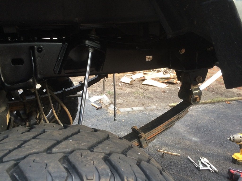

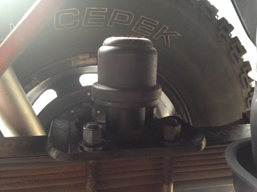

    Now just to bolt up
    6C23E324-F869-4706-8179-F91AF624A5E9_zps_e81a68743197a670b824e372d0e692d67578d3d0.jpg
    23A2422A-D9F5-4FE3-B191-FA15FAA82238_zps_0684f5aa150de236426170aa10b655e1abb1d578.jpg

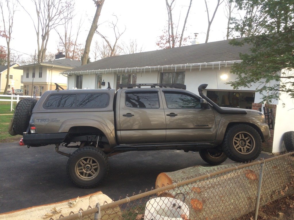

    And stretch her legs..
    3AF4AFD5-FE7F-4924-B4BA-C6164318B4A3_zps_cbbf3a370d27f110929c9f793598e08529dc513f.jpg
    D95E5D51-AE15-41B3-A0E1-51D19D356A3E_zps_582e8a775c97203b705d8dab788afc75ddad56fc.jpg

    Did it lift the rear at all ?

    Not sure, no measuements. And haven't eye balled possible rake on level surface yet.

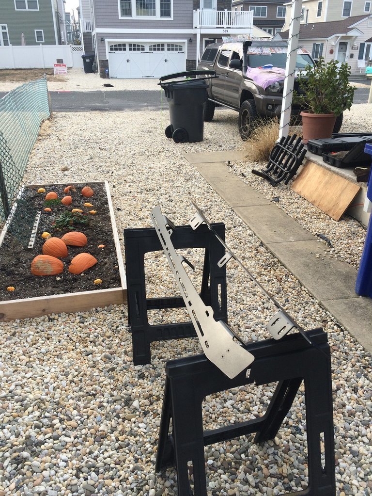

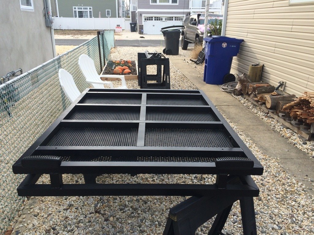

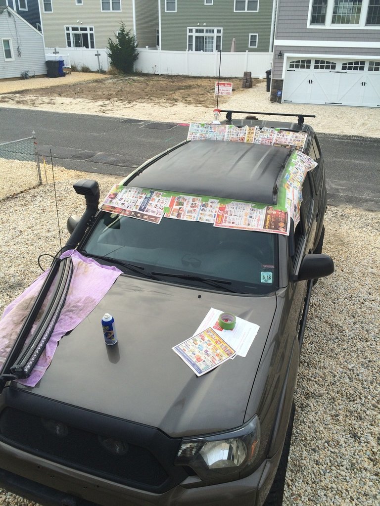

    Thanx @Blackout14 for the idea to derp the roof. The more I thought of it the more I liked it! The Prinsu rack is so low pro it's hard to clean any grim that collects on the roof, so this will be a nice protection barrier for the paint after long periods of time without washing or cleaning. I'm also thinking it will look pretty slick that any area of the roof that you can see around the roof rack and under the light bar will be blacked out.
    AF89BC25-CEB2-41E0-8188-E2DF13D00951_zps_083c563af288af66dbafcdcc0b8fdaf80095a177.jpg
    813888A4-B15D-454F-A565-35AB0A648C3F_zps_3b68a58a156ca6334a80355383cef78512e06cdd.jpg
    Can't beat a better day to paint
    542C5CFA-8278-459C-ACB4-3D4F8E071962_zps_ed42f7ad44bc7027169796945e459f331d580b3e.jpg
    0213855D-A9EA-4852-B853-9D95D33B1123_zps_ee605aebf216a5e2ea15e52344a6d5acb38c02e1.jpg

    :cheers: Looks good. Any change in the ride?

    Yupp that's what I got, I'll take the 3/4".. Never do mind rake and will help when I'm loaded with camp gear.
    Didn't drive it today. Should get a better idea of handling over the next few days daily driving to work.
