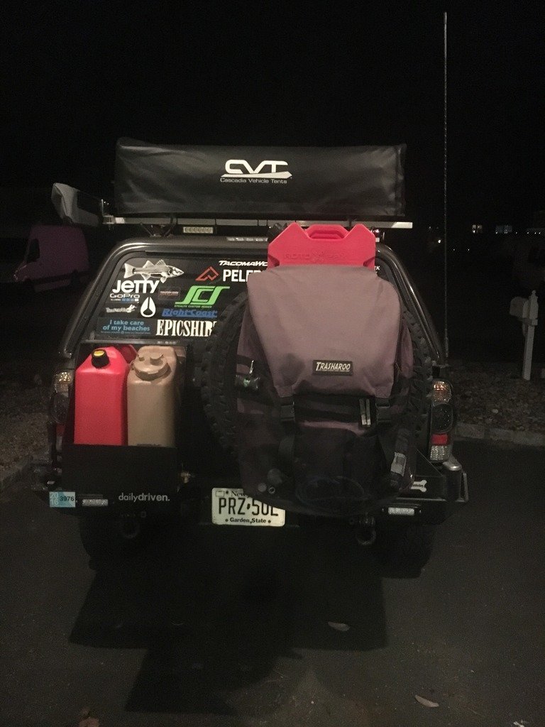

    Recently decided to do a little reconfiguration on my Prinsu rack.

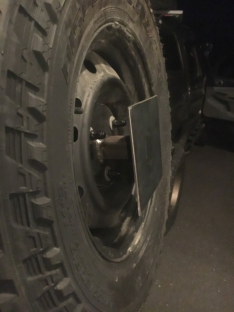

    Made up a spare tire mount for my rotos
    83292814-BDA4-492A-B438-3ED4AB696894_zps_f8eda7eccaece4d590d4986aeab37b0b69a0beda.jpg
    E8CDFFD4-B5FD-4249-AF47-ED5174639445_zps_9ee64d402da276d8b2997307125f0e42ee14c48f.jpg
    CCC18E2F-8AE6-4F78-9337-FA10B8D059DF_zps_5eba9e610a82bbcfad3e9d4c334c5b444faf27c1.jpg
    41EC7259-F3F9-4304-8014-CC6EB16510E1_zps_97d65b539f19de074a770c36dbf6fee0f229e7b1.jpg

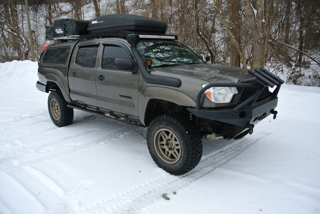

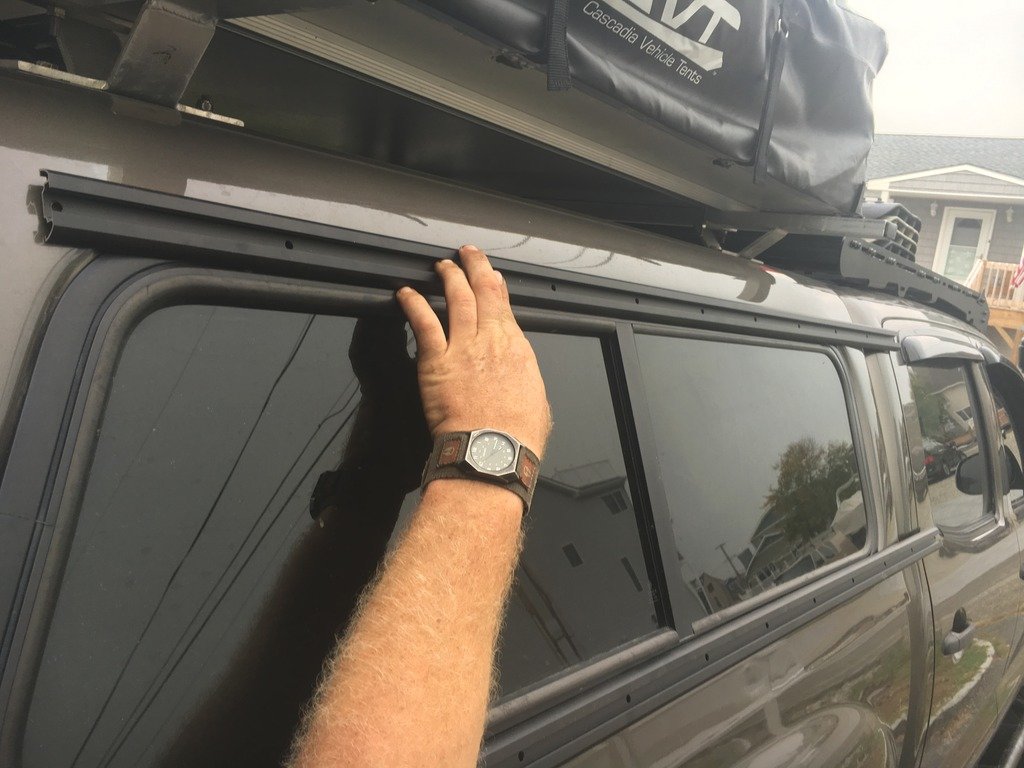

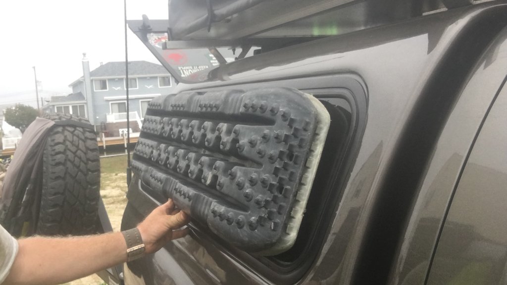

    The next move is putting my Treds on my cap window with roof bar tracking
    86214305-C474-46AC-9A0C-E3DB96DAF19D_zps_6016da55a63d6bd5728ecc9e22db1edbbae792df.jpg
    49EFC959-C411-4D0D-8760-110B2111FA72_zps_36c64c2e34c8264eedbeb2b8ddd073f8b17c9794.jpg
    Deleted everything on the Prinsu rack so I can put on a roof cargo box. Searched high and low for a Thule Weekender. It has perfect dimensions for the rack but unfortunetly they don't make it any more. Scored one on CL, drove up to Conneticut to pick it up

    That mount is pretty slick.
    You could also drill/bore holes through the mounting plate that line up with the lugs on the spare. That would make it easier to take off the spare with an extension going through the holes.

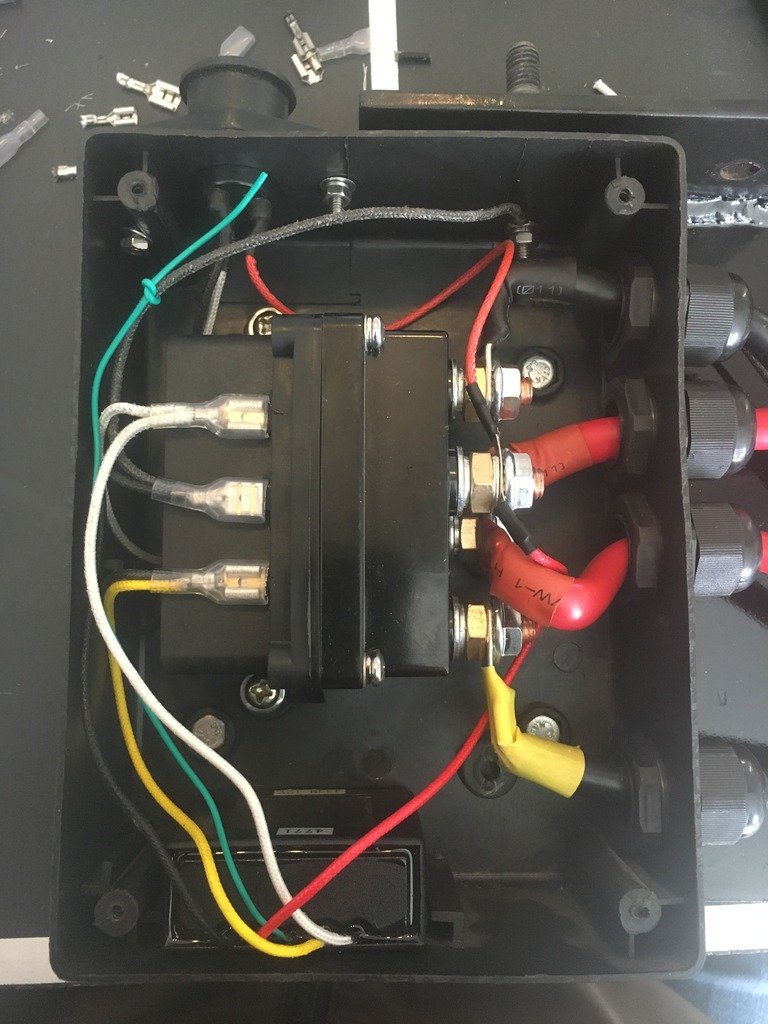

    I picked up an Engo 10K winch with from @SoutheastOverland
    If your not aware, a wireless remote is available and very easy to install (sold seperatly).
    Wired the receiver in the solenoid box

    Check your ground:boink:

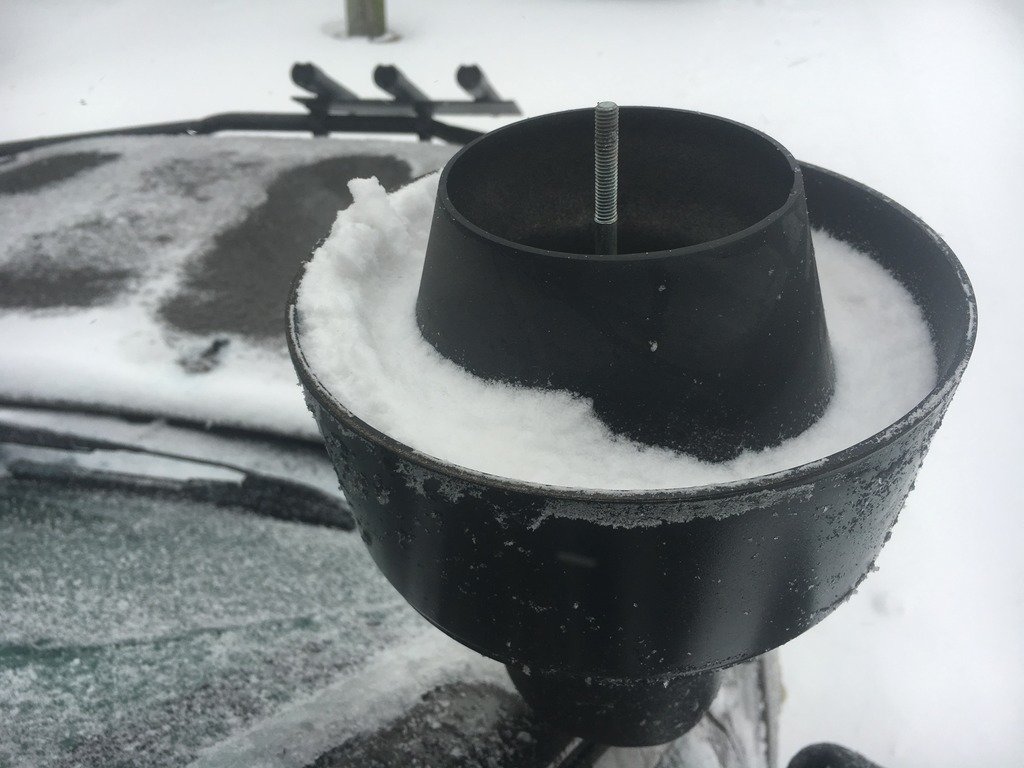

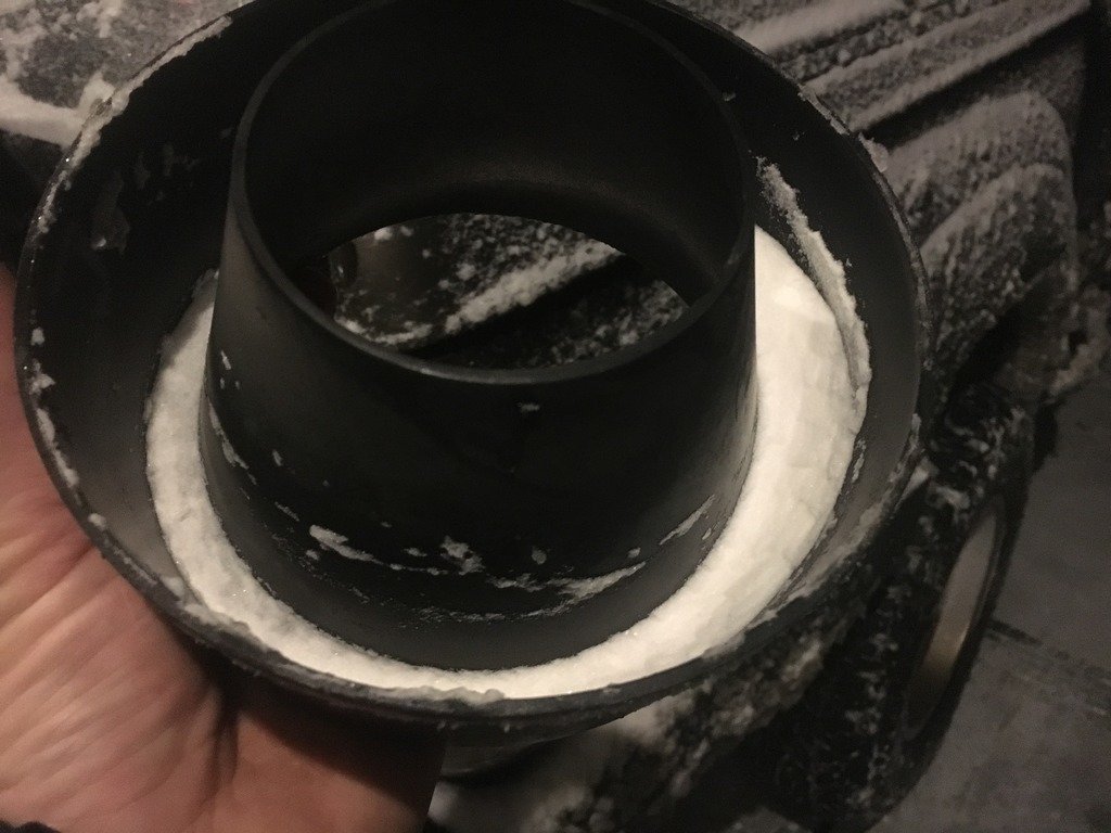

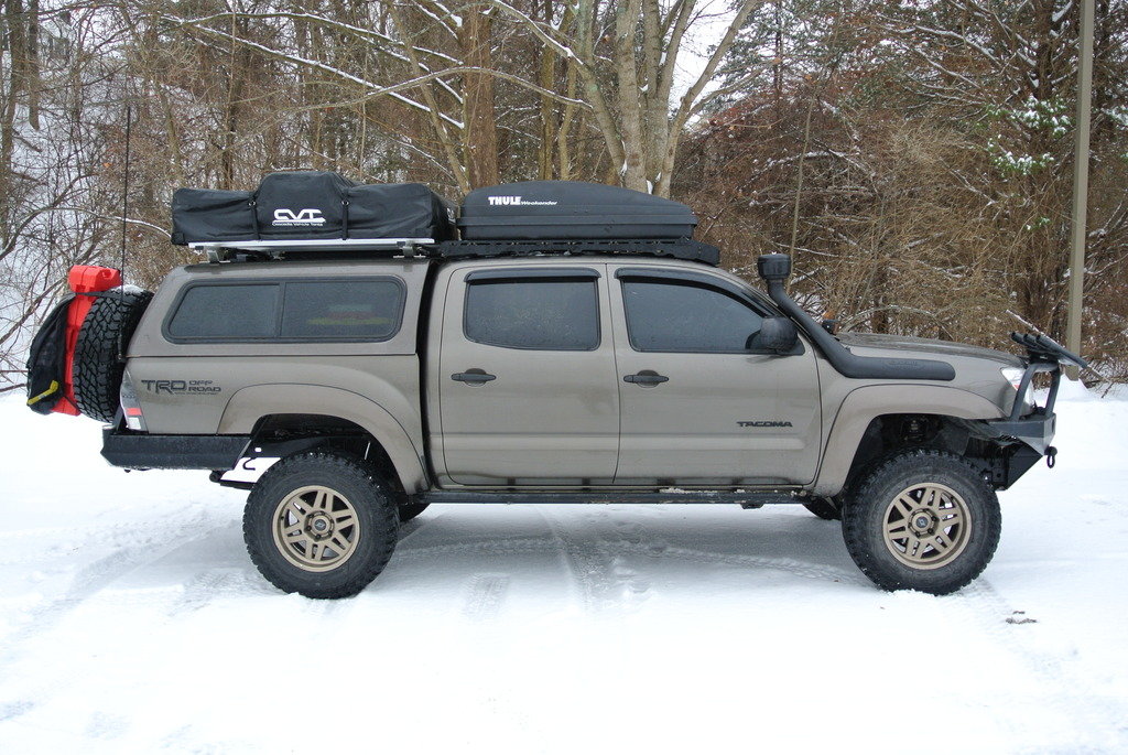

    Learned a prefilter is not that great in snow storm. Traveled over 2 hours round trip today..
    On the way to destination
    5AE232AB-0BE9-4389-99C6-B35EA14512BD_zps_2ae68a5b1df8b3a9f1e589f6f68ddee6bf1ab02f.jpg
    On the way home
    6D8A770C-8476-459F-AE92-2C85D566DFE1_zps_f9e928948ecf877fc05457ac18e86f361df5c65d.jpg
    After both trips there was a build up of wet snow on the outside of prefilter and snorkel body. Inside prefilter after both trips was light dry snow, and air filter was dry as well. I was shocked to see it full of snow first time inspected. After thinking bout what the prefilter does started to make sense. Second time inspected, I was shocked to see it not as full as the first time with the same weather conditions both trips. After further thinking the only variable that really changed was the amount of traffic. First trip having more cars on a snowy highway made my speed constantly fluctuate between 30mph and 50mph. Second trip I was able to maintain an average speed of 50mph. Seems to show the intensity of suction with a prefilter while being on and off the throttle Mostly being on it will pull anything in and collected in the prefilter, I have even had rain collected this way.

    I'm assuming that was a good thing that the pre-filter caught all that. In not that all would have been in the intake

    Glad im
    Not the only one it happened to today!
    Correct. If he had the regular snorkel head on and didn't turn it around or to the side or anything it would have gone into the filter...
    Also @Chux my bowl is clear! I can look into it while driving thats the only reason I even really noticed... the first time I noticed it was with the rain storm that was supposed to be snow last week. It filled my bowl up 1/4 way.

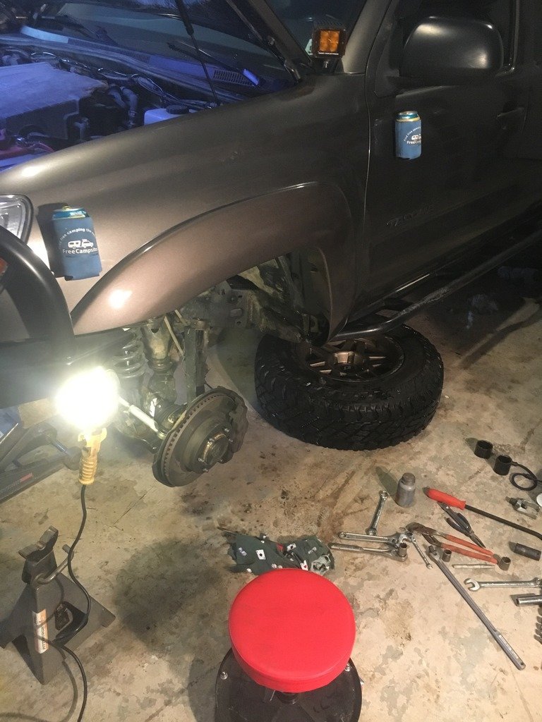

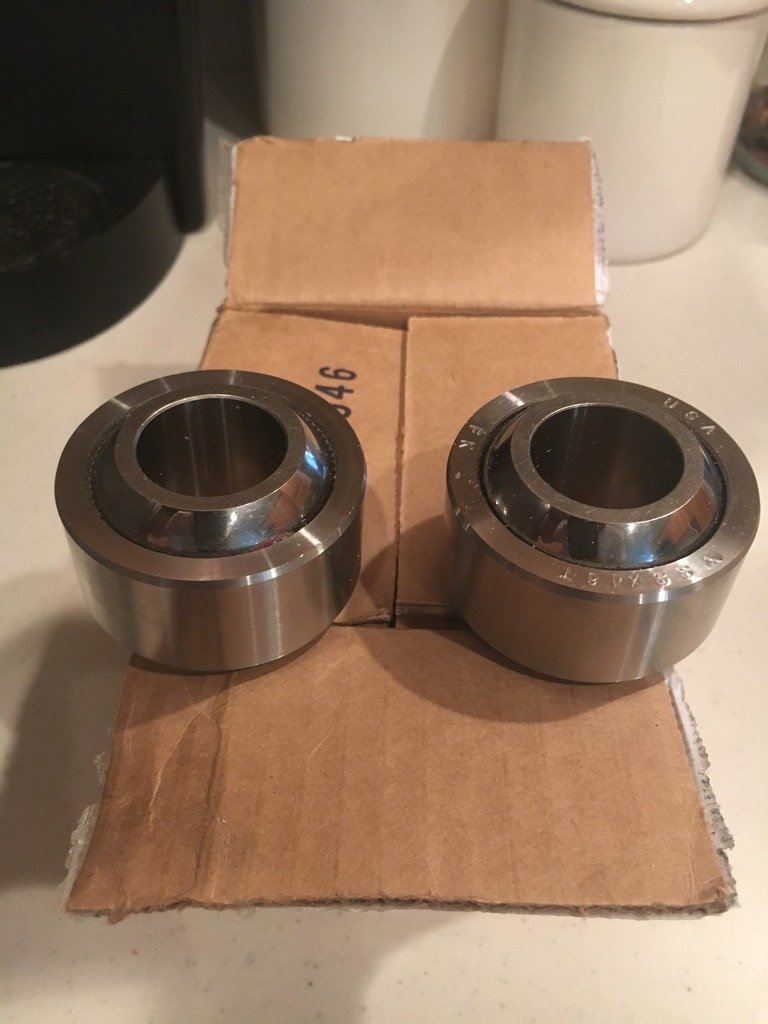

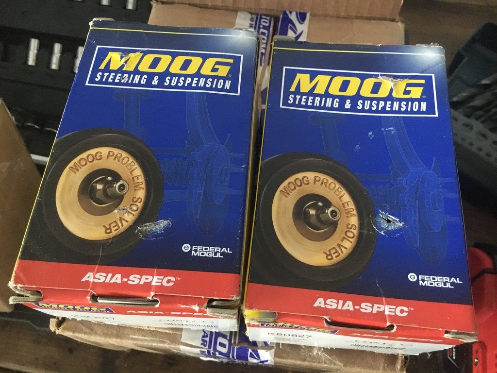

    Shout out to @Wheelspinner for coming by and helping me swap out LBJs. Swapped out to Moog for the grease fitting, my truck has sounded like an old creaky door for the longest time. A while back I bought a grease needle and injected the boot with grease but it was ineffective. A major concern as well were my uni balls that have slowly gained a lot of play in them and recently started hearing knocking. Swapped them out as well. Finished everything up and was able to get off road as the sun was setting.
