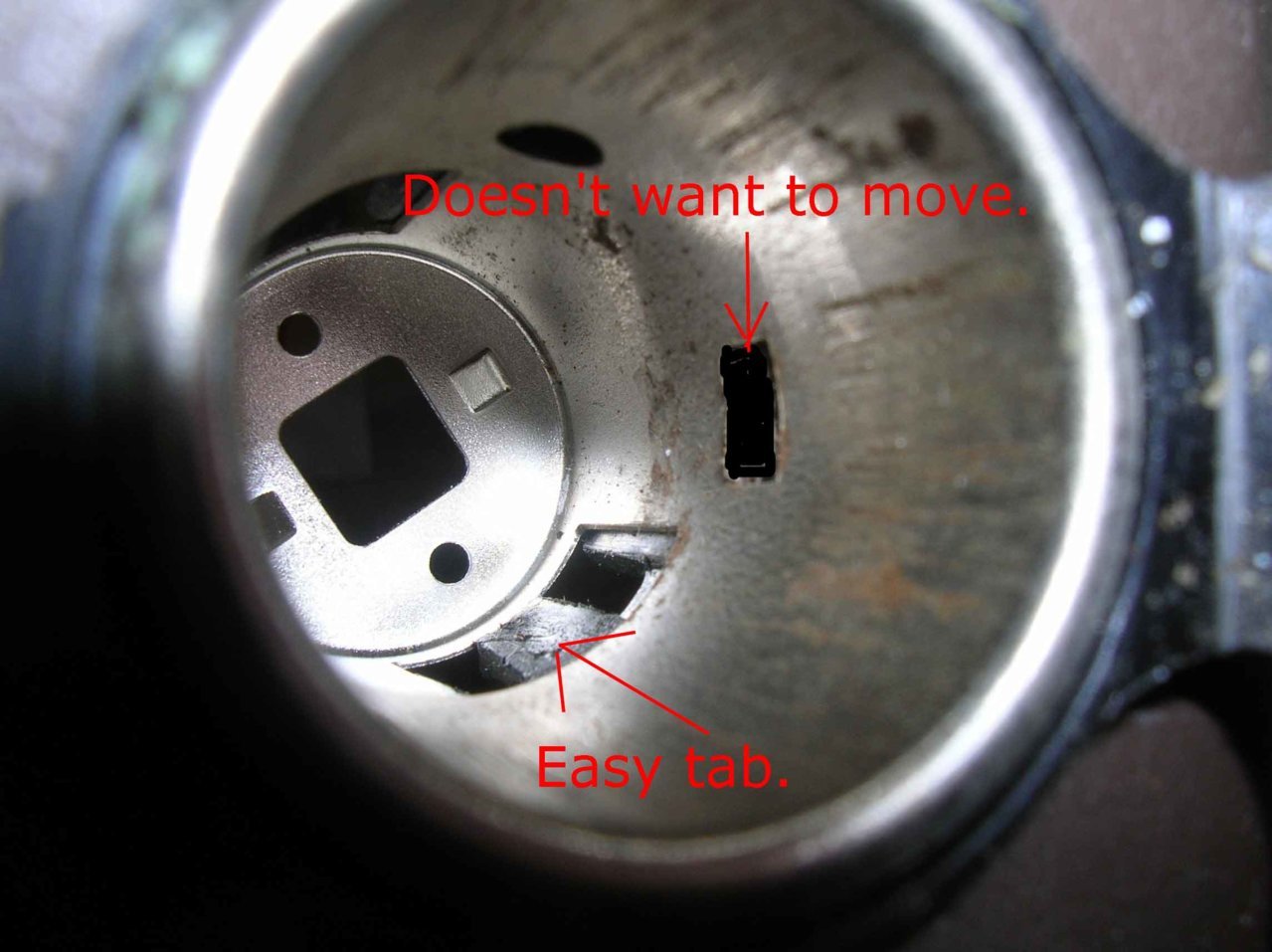

    I pulled the lower cover that mounts the cigarette lighters. There are tabs on the barrel of the lighter. But they don't flex. How do you remove the cigarette lighter from its mount?cig lighter barrel.jpg

    There are tabs on the inside that push out to remove the inner part. Then you can remove the black housing.

    Oh God those are a PITA. IIRC you rotate then push the metal out of the sleeve. Then the black plastic can be removed.

    There's a long finger tab at the bottom. Easy to move out of the way. However, there's a rectangle tab about half way down the barrel. It just doesn't want to move.

    I dealt with the same thing on my '03. Since I was replacing it with an aftermarker USB charger and hoping to not need it again, I ended up just twisting and bending the mess out of it until I got it out. There didn't seem to be any other way. It definitely won't ever be going back in.
