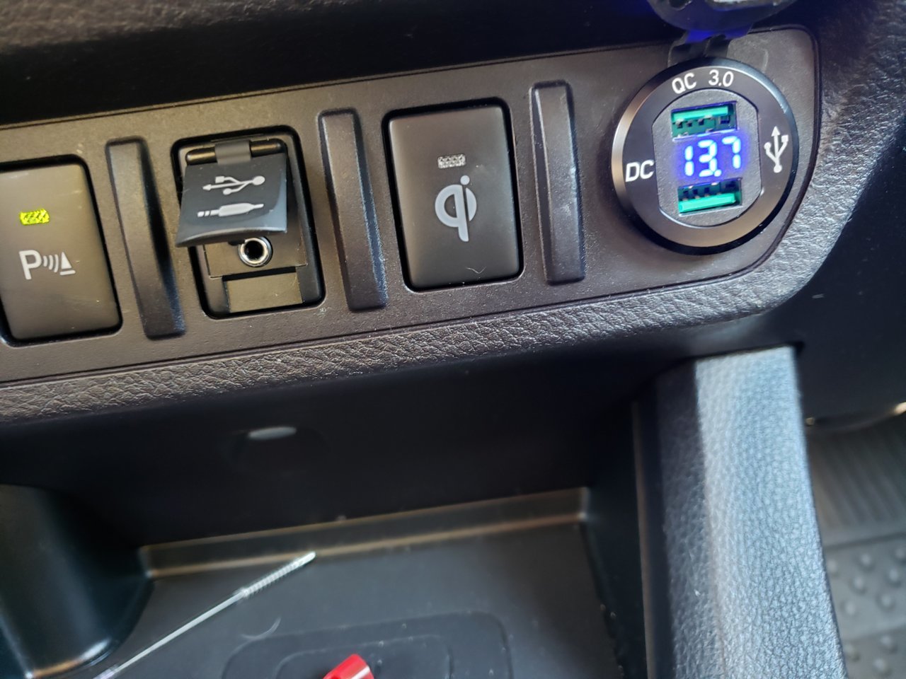

    Totally off topic but has anyone who does not have BSM tried to move the cig lighter all the way to the blank where a BMS button would be? I'd like to have the cig lighter all the way on the left so it's more in line with my air vent phone mount. Right now when my phone is in the mount and I'm charging it the charging cable interferes with my cup holders.
    I can throw up a pic with arrows if this doesn't make sense.

    It would be way easier to just put in one of these

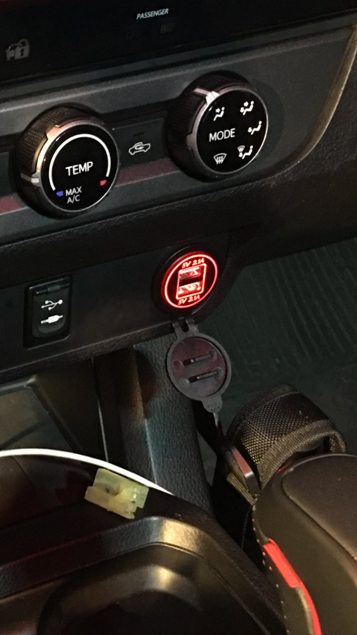

    How annoyingly bright is it when it's on? I have the same brand/design hidden behind my dash to power my wireless ram mount I built and that sucker is bright. It's a red ring lit one though.
    Also, what wires did you use? I'm not sure what to expect when opening it. Did you get to use the same red and black wires from the cigarette lighter or did you have to tap something else?

    It's as bright as my CH4x4 switches, which is to say, pretty bright.
    I would try to open it up and tweek the birghtness of the display but the whole unit appears to be glued into the aluminum housing which could make it difficult.

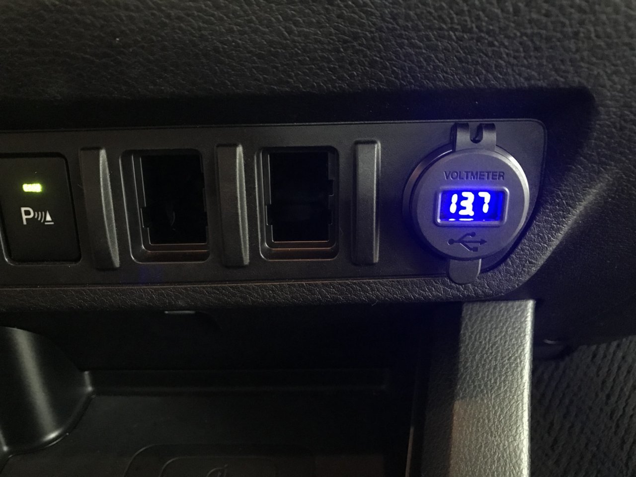

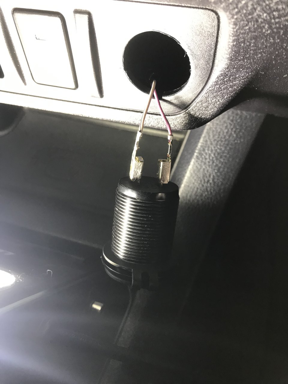

    Some of us (myself included) are just OCD about how we want things... I didn't want something sticking out of the socket. When I took the socket out, I just removed the metal wire plugs from the plastic bracket and attached it to the new USB charger, seemed to fit just fine.

    That works, looks good

    Speaking of OCD, you might want to think about putting some heatshrink or tape on those terminals if you haven't already.

    Yep, already done, that was just a test fit and I didn't take another picture after the heatshrink.

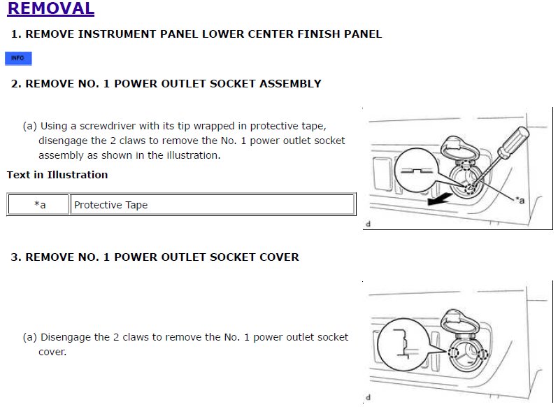

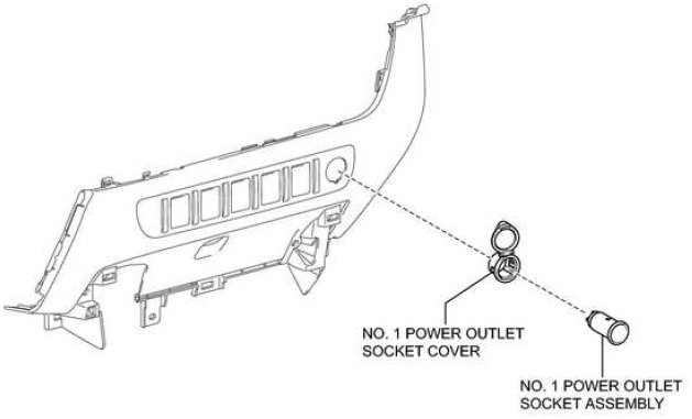

    Trying to push out the Cigarette lighter was one of the most frustrating experiences I have had working on this truck.

    Thanks for the tip on how to pry the sides to remove.
