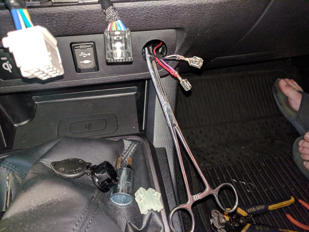

    Bumping this old thread. Any tips on how to remove the OEM power connector so I can use the spades? I've managed to get the two "top" pieces popped open as seen in the first picture in post 76, but for the life of me can't figure out how to "release" the spade terminal inside.
