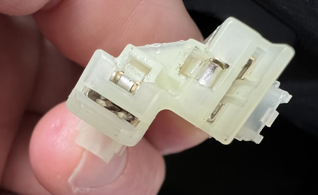

    This is the connector I can't seem to get the spades removed from.

    Lift that tang just above the connector that you can see in your pic. The connector will slide out.

    THANK YOU! Got it done!

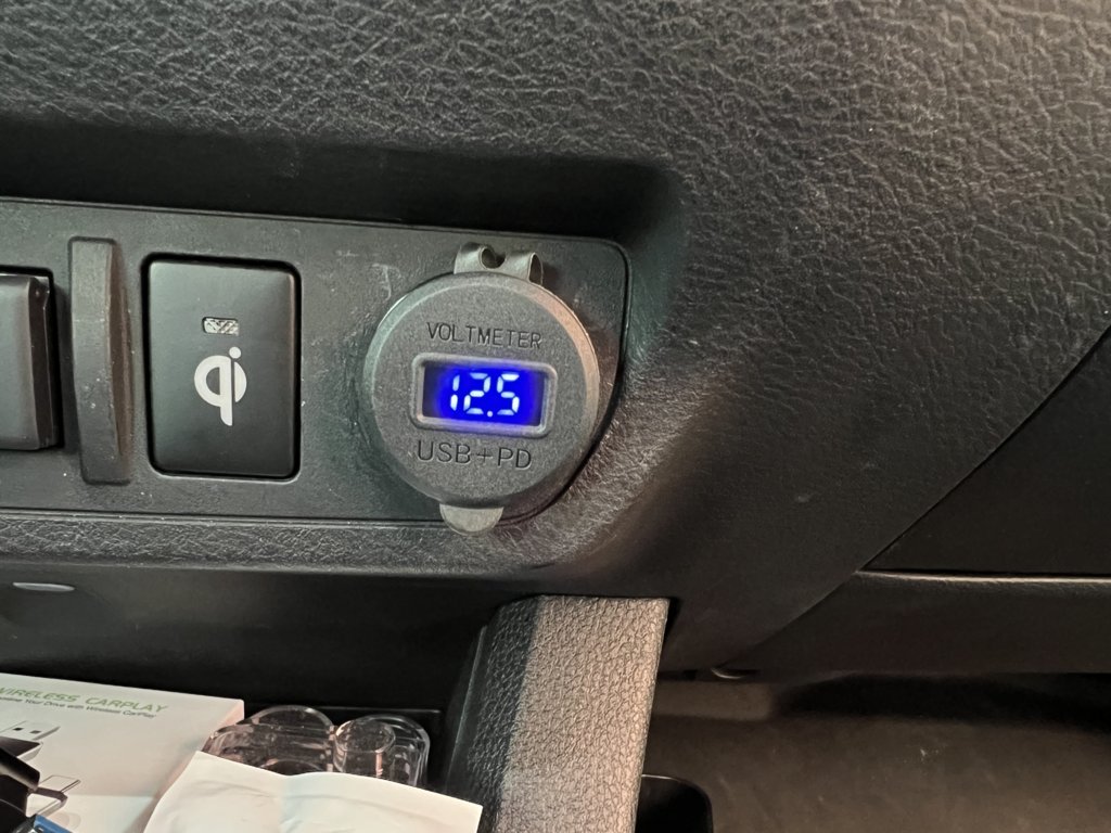

    I thought they sell dual usb chargers that are flat and push right into the cig lighter port ?
