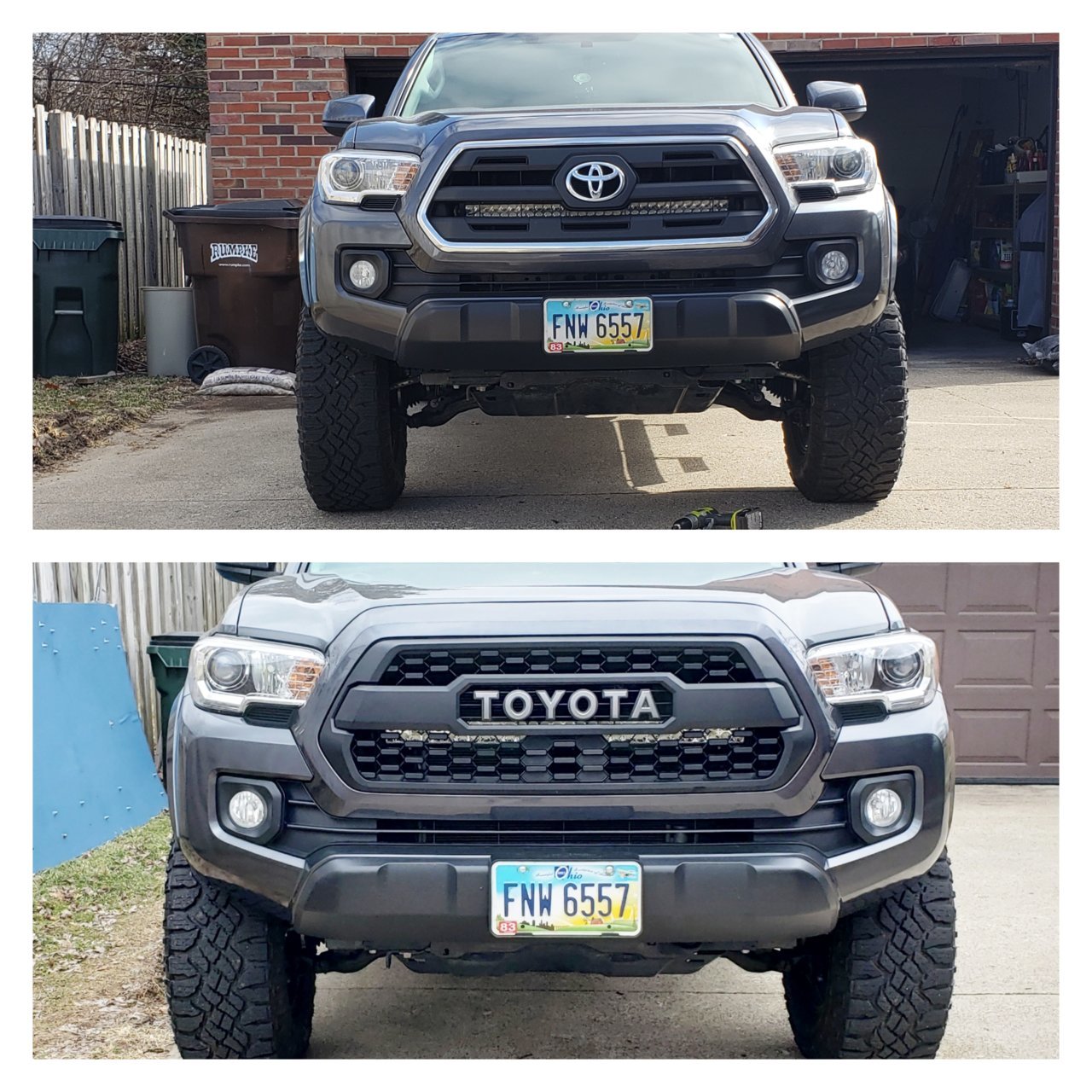

  15. Mar 13, 2019 at 6:20 PM

    Got my pro grill on :)
    presta24, nismoz33, dre5491 and 4 others like this.

  17. Mar 14, 2019 at 6:11 AM
    #8357
    09TRDSport4x4
    09TRDSport4x4 OCD Approved!
    Oct 13, 2014
    #140292
    1,093
    Nick
    Southwest Ohio
    Man, that Pro grill on the third gen looks so much better than the 2nd Gen Pro Grill. Not that it matters for us pre 2012s but looking good @Jordaneckert85!
