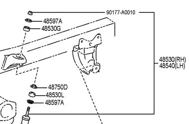

    So... before I placed my order for the new retainer washers, I figured I’d take a quick look at the install instructions Elka provided with the suspension. And, ignoring the poor English (pretty sure the dude who wrote these speaks French as a first language), it looks to me like I won’t need those washers:

    Right, only rubber bushings should be touching the top and bottom of the frame.
    Washer - bushing - frame - bushing - washer - nut

    The piece I pried out of the driver’s side was on the bottom and definitely had a lip. So I’d have to imagine it was 48750D from the diagram above. The question I have now is, should it have even been there with the 5100s? They had a washer, bushing, bushing, washer, nut combo just like the diagram but for education sake, now I’m curious if the second bottom washer with the lip should have been installed on both sides previously (not that it matters at all to me now).

    Technically speaking 48750D doesn't have the lip.....although the diagram makes it look like it does. I wonder if the bilstein shafts are thinner than OEM so they supply that washer with the lip to fill the ID/OD gap. Not sure just speculating.
    Yes, there should have been one on each side. Did you install them? Before you install the new ones double check that it's not stuck in the other side.

    I did not install them. A buddy of mine did it for me about four years ago. He was a certified mechanic at the time but typically worked on VW/Audi vehicles.
    I don’t think it was there but I guess it’s possible the washer from the passenger side fell off and rolled somewhere in the garage when I cut the nut off the top of the shock. I had already unbolted the bottom shock mount, so the shock just fell to the ground when I pushed the bushing through after I was done.
