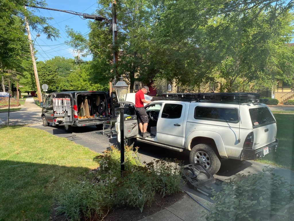

    It’s weird seeing some other person screwing with my truck

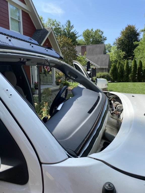

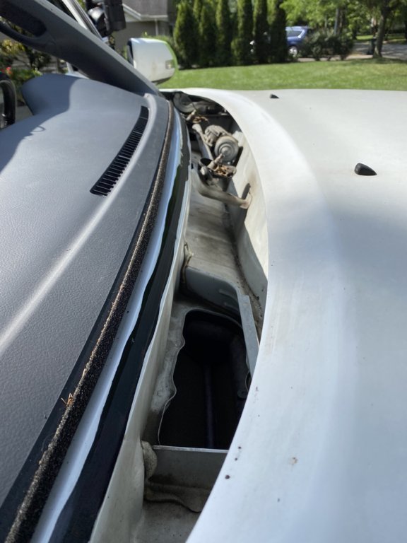

    So Roof Rack stayed in place. All went smoothly and glass looks fantastic! But the best outcome was while the glass was out, I stood through the windshield opening trying to find the source of the annoying defrost vent area rattle. I cut two pieces of 3/4” clear tubing and wedged into the open cavity at the front of the dash, normally inaccessible with glass in place - below the dash lip and just above the metal body:
    and the rattle is silent!!! Gone!!!
    Cab is quiet!!!
    It’s wonderful!!!
