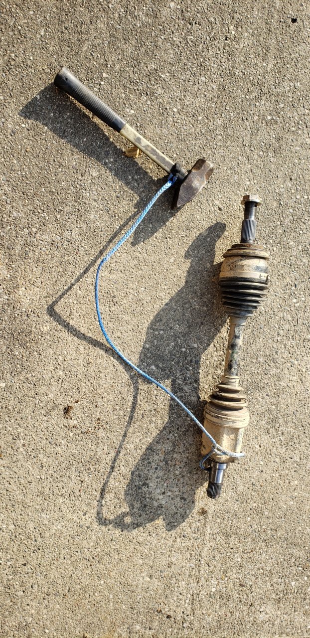

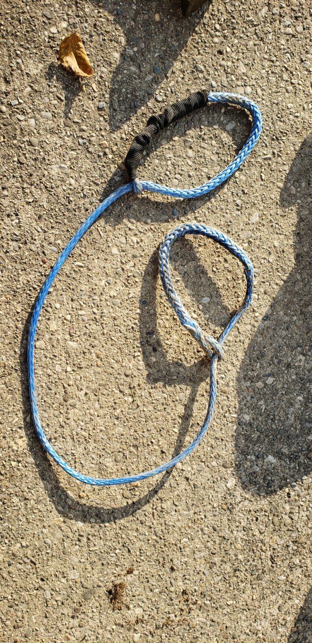

    All the ball joints are relatively new and have no play in them. The steering rack seems fine. I looked at how the spindle supports the bearing, and it's really just held in by the front part of the hub that bolts in. The alignment was perfect. So really everything points to a bad quality bearing. Hopefully the one you get is better than the one I got. RockAuto is returning it for store credit given that it lasted so few miles and that it's my second Beck/arnley.
    On a side note, my homemade axle puller worked amazing. I'll definitely have to keep it in the truck for any trailside repairs. Also only took 30 minutes to get the old bearing off and axle out. I'm getting a lot faster at this.20201006_172235.jpg 20201006_172204.jpg

    Would been a lot nicer if my axle had came out that easily. Beat, banged, pulled will a puller, took it to a shop and they lifted the truck, banged, pulled, and finally got that sucker out. That little clip works well sometimes lol

    Read somewhere here, that you need to be sure the circlip opening is facing DOWN when installing them. Maybe so, maybe no.

    I read that too. I took two swings with the hammer and it didn't budge, so I rotated it 90 degrees took two more swings and it popped right out. Not sure if I hit it harder, or I rotated it so the opening was facing down. Either way it took just a few seconds. The last time I pulled one of these it put up a heck of a fight, so I'm definitely happy with my rope.
