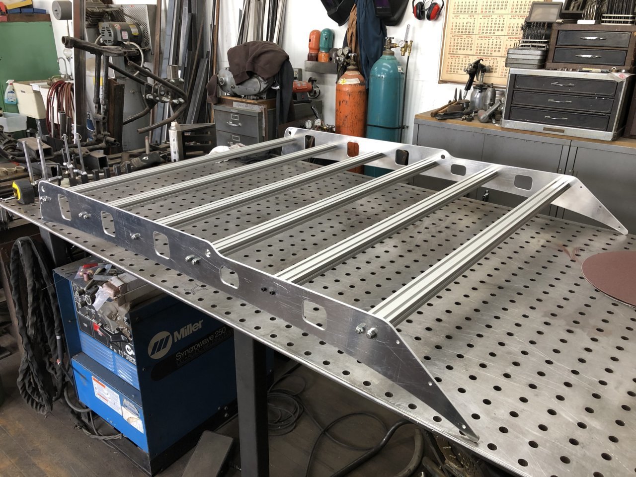

    Some photos from the mounting mock up on my 05’ DLCB roof rack. I’m waiting on powered coating. Wasn’t completely happy with what is on the market and my daily work needs plus extra fun needs. Working on a long bed cap as well.
