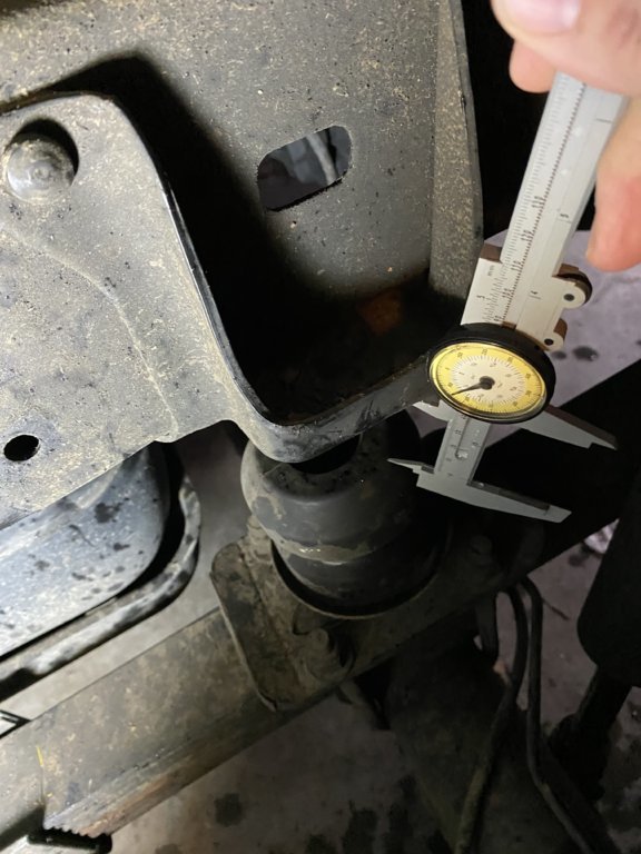

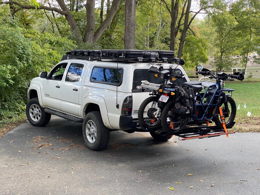

    So question asking for ideas and suggestions...
    I have Dakar HD springs, u-Bolt flip kit and Timbren bump stops. Unloaded there is 1 7/8” clearance
    But when I put on my two bikes, the bumps are touching the frame perch above due to the weight squatting the truck
    So, thoughts to carry the weight better?
    1) add another leaf to the Dakars
    2) replace Timbren bumps with AirBags
    3) some other idea from y’all...

    What do you need done? What suspension parts?

    Being that you're a mostly road truck, I'd bag it. I see the rear plate bumper, and the weight of the bikes cantilevered out, exaggerates it even more.
    I think @mwc273 would have the most insight on carrying heavy weight in the bed. I've seen a serious load packed into his bed and topper!

    yeah, I’m thinking bags are my answer also.
    I did inquire to Timbren if they have a rubber spring to replace the bumps and am waiting on a response.

    UPDATE! Timbren just called me and is shipping me a rubber spring set to try and give feedback on...that’s pretty cool!!!
