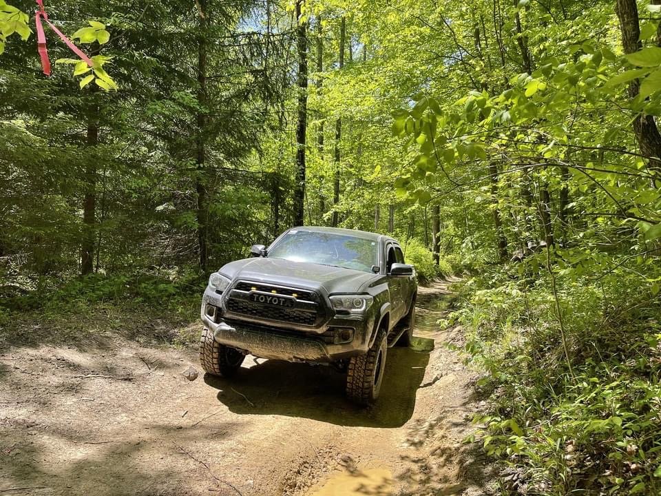

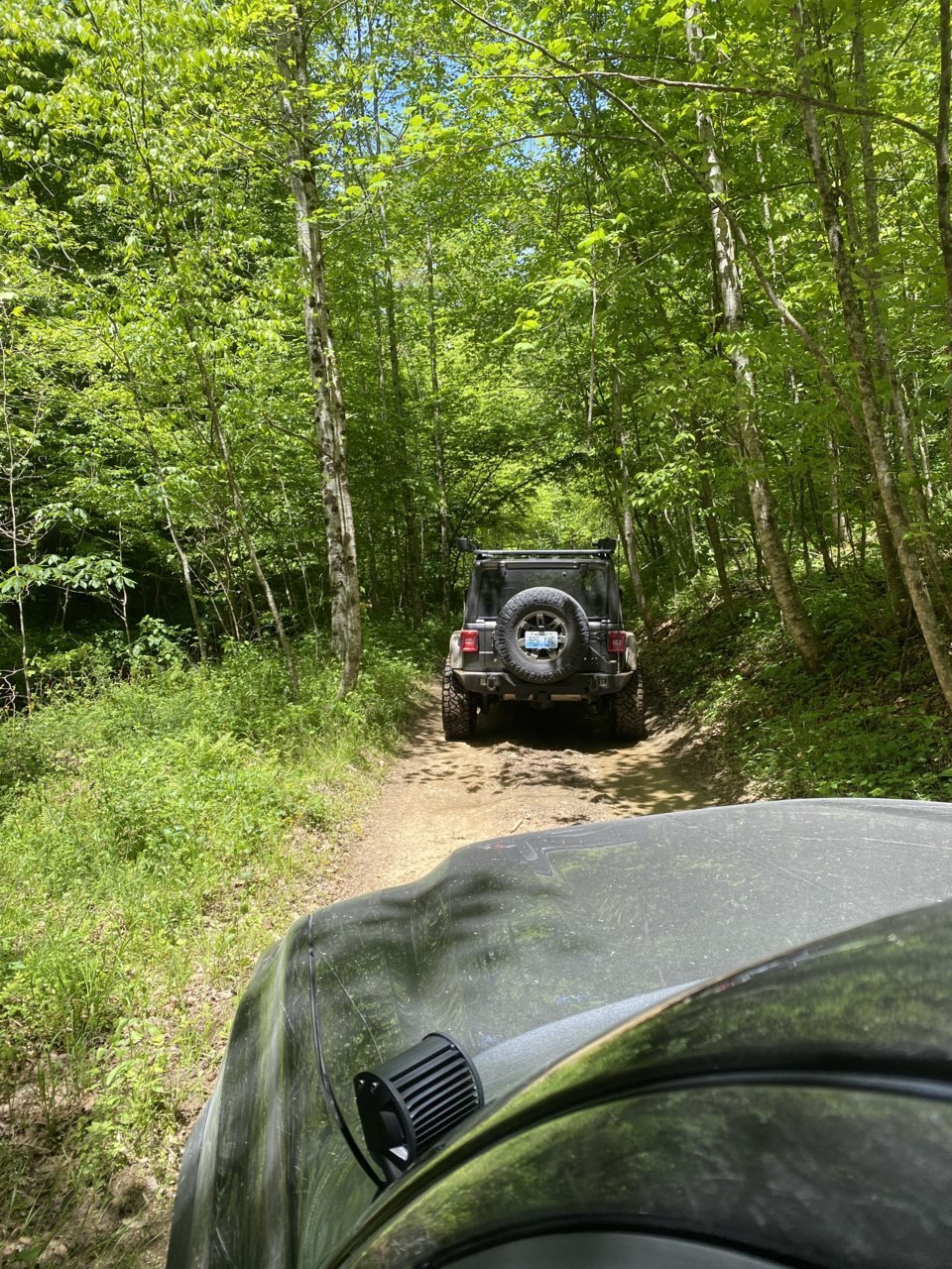

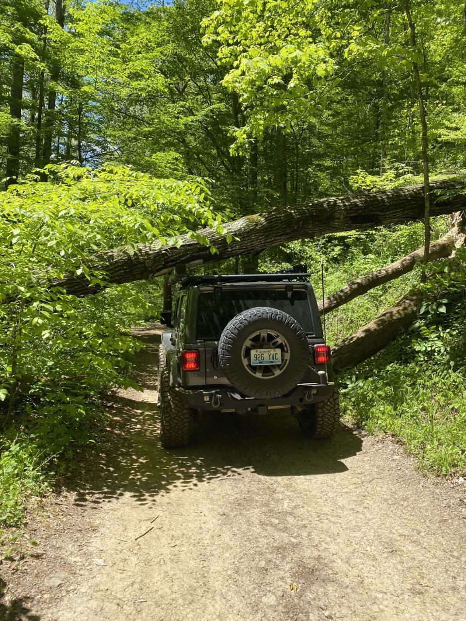

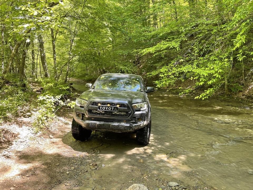

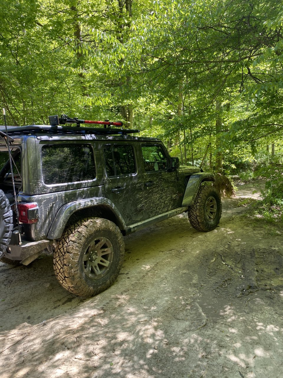

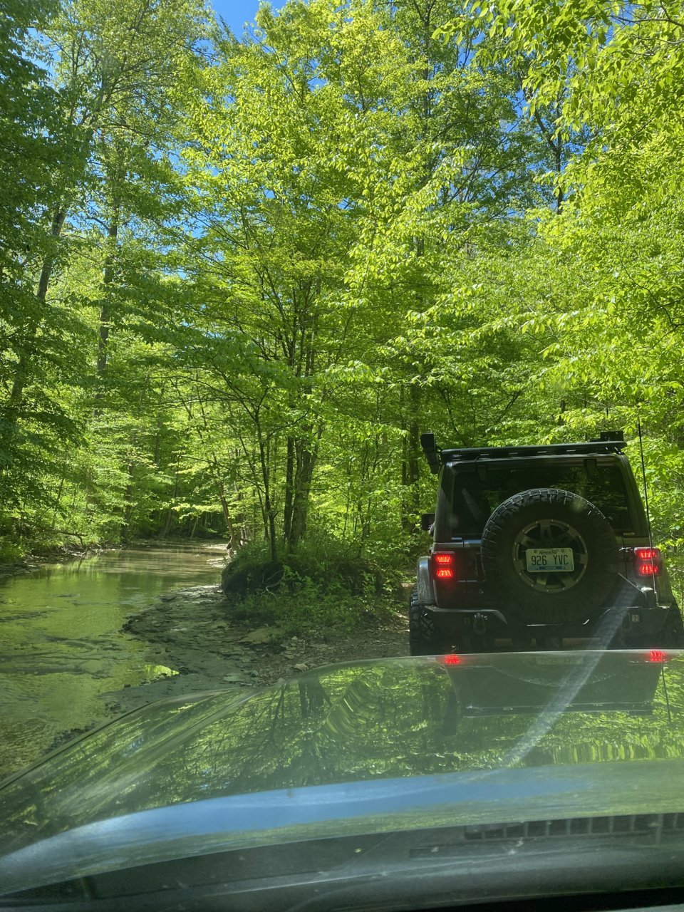

    Ran spaas creek and pumpkin hollow yesterday with a Jeep buddy. Neither trail was very challenging and pumpkin hollow was much shorter than I expected it to be.

    Is it bad that I looked at that giant red oak log over the trail and thought "that's a great log for firewood, time to get the saw"?

    No because I thought about it too lol. Apparently it’s been there for a little while. I’ve seen it in videos online
