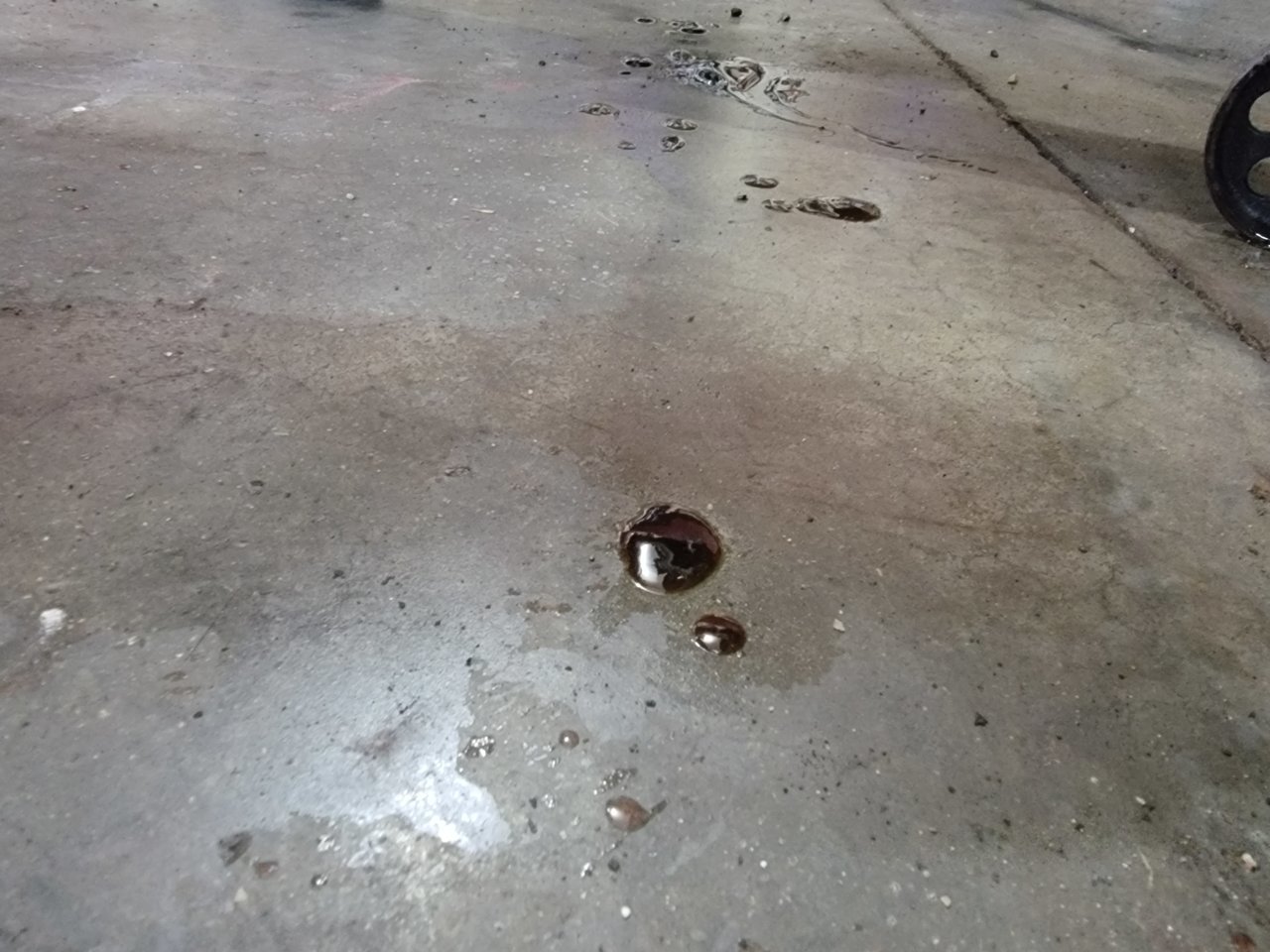

    This is definitely inner CV joint grease. Have it all over my garage floor now after accidentally seperating a CV when pulling my Sienna transaxle.
    Smells fine, tastes like garbage tho. Your diff oil has an unmistakable manly ass smell.

    well, I hope I am wrong and it is inner CV grease but to me the puddle looks more fluid like. I’m curious though that it is both sides. I guess adding the lift would change the angle on both sides which could create a change in the inner boot…
    Nick, only way to know is get under and investigate. Sorry Brother, I know the timing of this sucks.

    See, that’s what I was thinking too. I smelled it again today and it has literally no smell. It’s also got a hint of a red color to it which makes me think it’s grease versus fluid.
    It also doesn’t leak all the time. It’s almost as if the boot has to be oriented the right way for it to actually drip on the ground. Sometimes it’ll sit overnight in the driveway and leave a small puddle and other times, it won’t.
    Yeah, the timing literally couldn’t be worse. Just got notice today that the closing on my new house is June 16th and I still have so much stuff left to sell/donate/trash/pack before I’m ready to move. Literally every free moment I have right now is tied up in this process.
    I will climb under there and investigate tomorrow before I pick the kids up. If both inner boots are torn then it’s most likely grease. I’ll also wipe it up and spray it all down so I can see exactly where it’s coming from the next time it leaks. And I mean, I’ve had the driver’s side axle out once so I know I can replace them, I just need to limp it another month or so before I’ll have time.

    So this house sale and move are still kicking my ass, and I haven’t had time to get under the truck yet…
    But, with that said, it has stopped leaking on the driveway. I’ve driven it on a few short trips the last two days, mostly hauling kids back and forth and not once has it dripped on the cardboard I’ve put down. This leads me to believe it’s axle grease and worries me that the driver’s side is about dry now and that the passenger side may have already dried up.
    I will confirm if the boots are torn sometime this weekend but I assume they both definitely are. If that’s the case, what’s my best option? I’ve heard CVJ axles are better than most and better than OEM for lifted applications. Ideally, I’d prefer to put something in there that won’t get destroyed by the lift angles too quickly. Any input or experience with replacement axles?

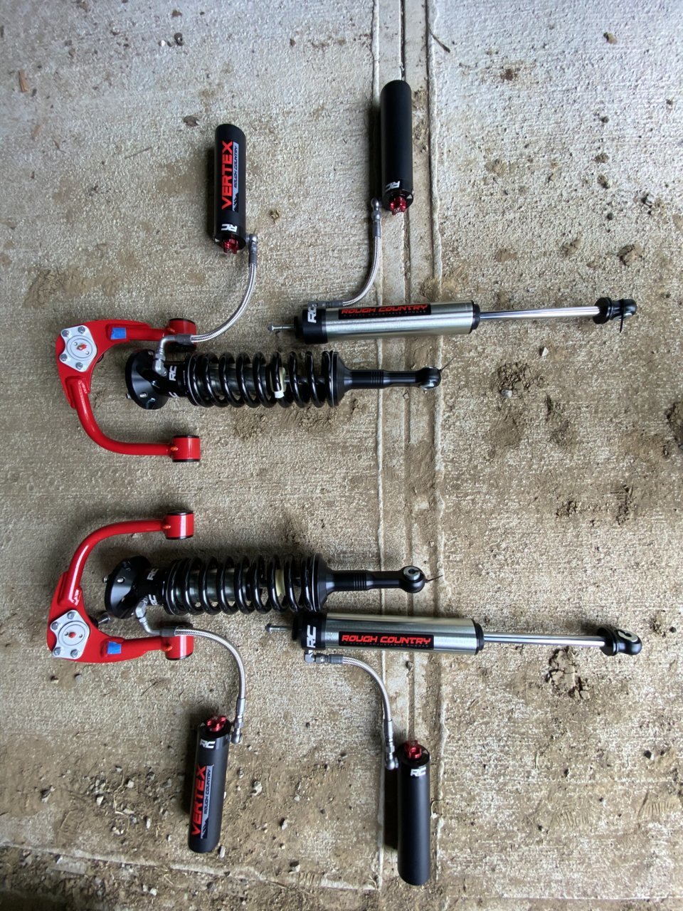

    Got all the pieces finally. Now just need time to install. Hopefully it’s better than other RC stuff
