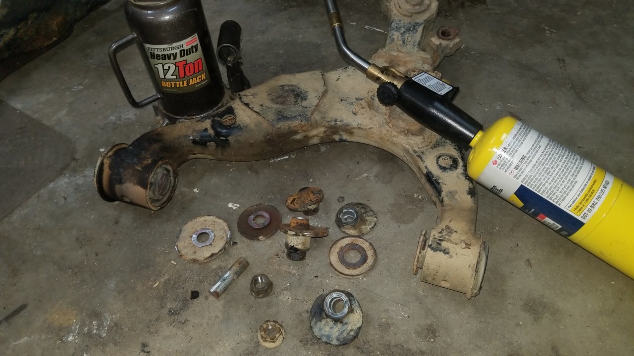

    Man fuck those LCA bushings.... Time to return these whiteline bushings and just order a new Moog LCA.

    What happened?

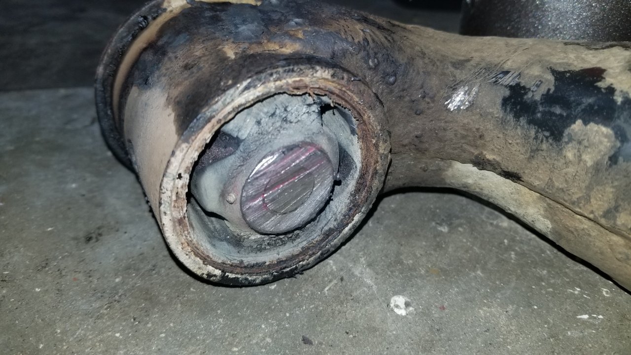

    Ongoing saga of repairs and finding reasons for mods.
    Found a bent alignment tap. Suspected it was due to a frozen bolt (which it was).
    Ordered new alignment cam bolts, lca bushings, and total chaos cam gussets to fix it all.
    Tried to press out the old lca bushing with a 12 ton Jack and map torch. No luck. My truck had some serious undercoating, which maybe is contributing to the stuck bushing.
    My goal is to do most of the things that will require an alignment so I can get it out of the way: UCA, 877, LCA, alignment cam gussets.

    Welcome to mods, where one bolt turns into a 12 hour ordeal for no good reason other than "because fuck you, that's why".

    It usually can be taken care of with a wire brush on a drill. But it also seems like it traps rust in making it fuse into one solid block. I've generally been able to apply extra torque and break things free, but it's generally a pain.

    Translated to:
    "Buy plenty of cut-off discs, have a torch, buy spare bolts, keep hammers close by, several cans of penetration fluid are needed."

    Yeah once those LCA cams seize up...game over. Just buy a whole new LCA. I sawzalled both of mine out not long ago. Wasnt too bad.
