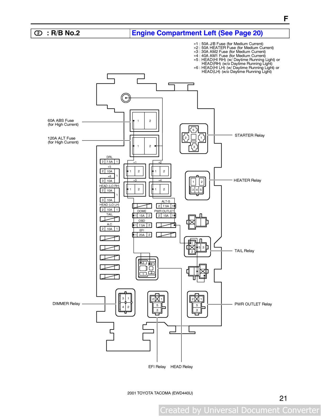

    Don't start replacing more stuff, you need to find where your losing power at. The parts cannon is not the answer, get a test light and do some checks.
    Does your check engine light come on with the key on?
    Do you have good power at Pins 1 & 5 at the EFI Relay with the key on?

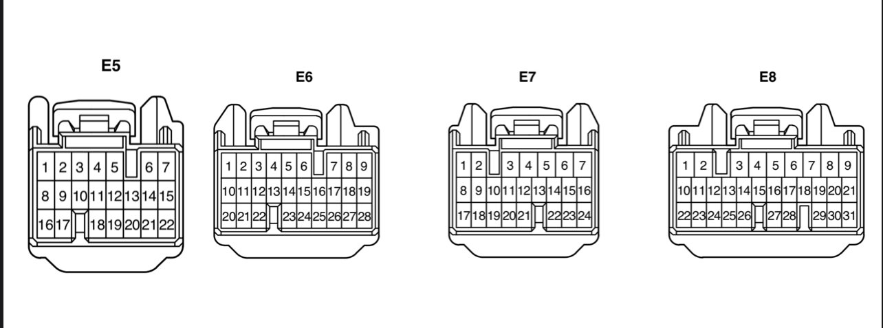

    Here are the ECM connectors if you test powers and grounds.

    EFI pin 1 and 5 have power. I checked the B+ at the ECM and no power. I jumped the EFI pin 5 to 3 and made sure power is on. Still no power. Checked J/B 3 plug 3E at pin 1 and no power from EFI pin 3 with the jumper. A break in the wire at connector IF1. Replaced wire and now we are running. Now I am stuck in first gear and also while pressing the breaks all exterior lights come on. Thanks for the input and suggestions!
