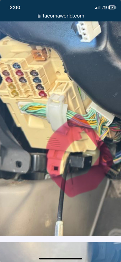

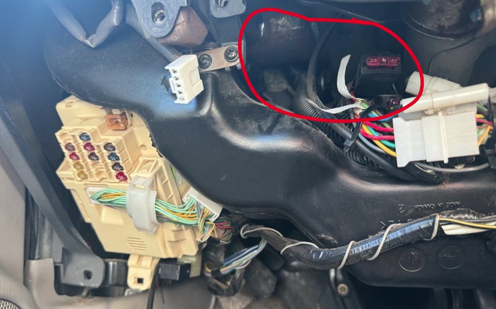

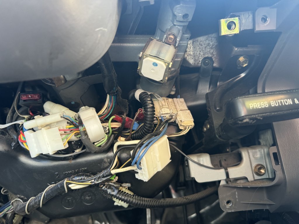

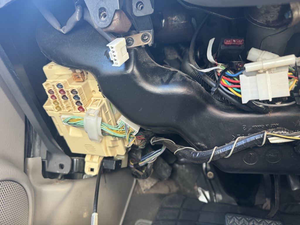

    Old thread, I know, but it's still a mystery where the Open Circuit Relay is on my truck - 2001 Tacoma (4cyl). Removed all the panels and can't find it. Some say it's green, other say it's under the fuse bank. Any ideas? (Problem is the same as others' - fuel not getting to fuel rail after hard braking). IMG_4068.jpg IMG_4067.jpg

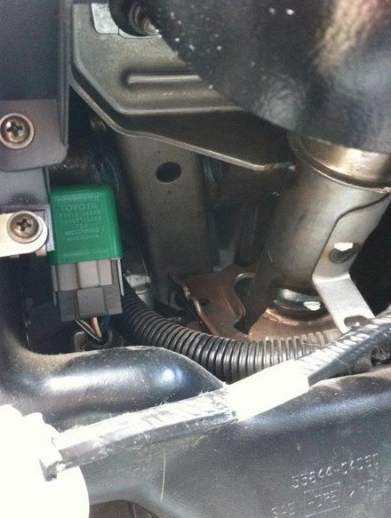

    So i literally just replaced mine this week after a crank/no start situation. It was right here in this area where you appear to have some random fuse holder?! Any idea what that's about? Part of an alarm system?
    Here's where it should be. just to the left of the steering column.
    EDIT: I have a 99 and noticed you have a 2001 so your location may be different. thanks Toyota.

    Well, I realize now that the pic i found on the internet actually came from this thread so you've probably already seen that...
    @themattman67 you may need to consult the 2001 FSM to find it.

    Been a while but I think it is this one:

    Yep - the big green Circuit Open Relay just isn't there. The small black RY302 Relay on the lower right corner of the fuse block may be it, but replacing it did not fix the problem. Still crank/no start. What else could be interrupting power to the fuel pump?
