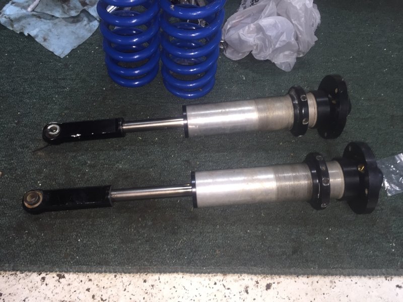

    Aaronarf came over and helped me rebuild the coilovers, revalve, and converted to ext travel. Just need to get the springs put back on. Although I think the truck is going to stay on jack stands till I get everything else lined up and taken care of.

    Scale of 1 to 10 where does the difficulty of this rate.

    Easy, there no reason you should send them x-country for rebuild, except for nitrogen charge.

    Told you man! What did you reinflate to?
    +2 kit will run you some $$$ and I think the race series lowers are perfect for a MT setup. But I'm kinda biased. :)

    Stock length is what I'll go to at some point. Less stuff to deal with like axles and shit

    Man...all or nothing.
    You need UCA/LCA anyways....no brainer in my eyes.
    Agreed. I was surprised how simple the disassembly was.

    Haven't pressurized them yet but will go to 250psi. Would like to baseline off of what it was previously (assumed) since I changed some compression shims.
    Going to +2 to get matching front and rear travel. Should be F'ing happy there!
    You need all kinds of shit. Yeah axles sound like PITA at first but once done its a no brainier.
    X2, nice to have an extra set of hands to hold my shaft while I worked on the other parts.

    Ifbs +2 makes you happy, go for it! It's obvious its functional crawling with it just by watching Arfs video

    +2 is sweet, I've had my eye on it for a couple year. Now is the time, everything else is working friggen great.

    Starting over with new uppers, lowers, COs ,axles and brake lines is a lot of monies. It would be cheaper to buy a truggy and tow it ;)

    Definitely man, I'm 99% sure he'd take you through the process too, they've got a shock dyno and everything.

    Damn! This process looks like it went fine but I'd love to meet the guy. Shocks intrigue me, especially the valve tuning portion.
