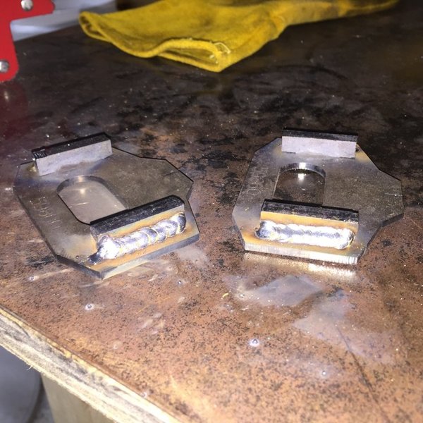

    Cam tab and spindle gussets showed up today. Need to track down a set of instructions for the spindle gussets though.

    Mine didn't have them either but my buddy figured it out. TC is closed this week also

    My cam tabs had them, not sure who removed them or they just don't pack them.

    Cam tab gussets are worth the labor.

    I might just weld the stocks

    The stocks are fucking tin! It's 95$ for these and they are chromolly.

    He just welded beads on the outer edge of factory tabs. Screw that though. TC ones much beef.

    I've welded the stocks. Considering that one has a tab completely missing and I'm already doing the work of pulling the LCA it was a no brainer to just go ahead and beef it up.

    If the LCA is coming out anyways do the TC... if it's not then use a bead to gusset the stock crap...it's a no brainer.

    Yep, it'll make for an easy transition when I get aftermarket arms. And it'll be a good foundation for when I decide to say fuck these cams and solid mount the lowers.
