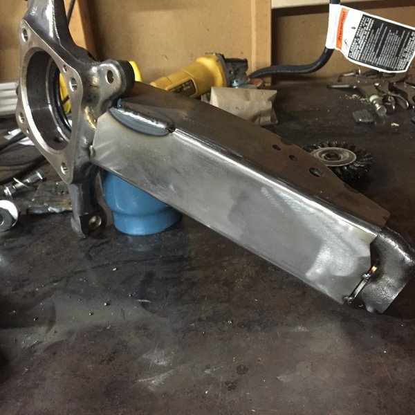

    Tacked the first spindle gusset up tonight.
  13. Jul 1, 2015 at 3:35 PM
    #2153
    AaronArf
    AaronArf Well-Known Member
    Nov 12, 2011
    #66926
    4,218
    Aaron
    VA Beach
    2023 LR OR DCSB
    Lookin good. You done yet?
  14. Jul 1, 2015 at 3:37 PM
    #2154
    ckeene9
    ckeene9 [OP] Well-Known Member
    Sep 20, 2012
    #87325
    10,848
    Chesterfield, VA
    '12 DCSB Supercharged 4x4 TRD Sport
    See Build Thread
    Getting there. Just started stripping the 2nd spindle while this one cools a bit.
  15. Jul 1, 2015 at 3:37 PM
    #2155
    odomandr
    odomandr Well-Known Member
    May 14, 2011
    #56643
    5,876
    Andy
    Fort Collins, CO
    2010 DCSBTRDOR silver streak mica 2023 T4R Ltd blizzard pearl
    Icon, SPC,, ARB, BAMF, Warfab, SCS, Michelin, Leer Stock
    Not a bad stack of nickels there Chris.

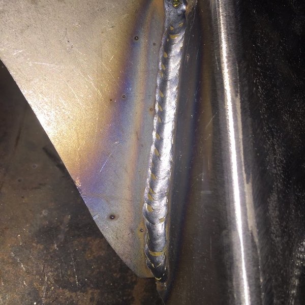

  16. Jul 1, 2015 at 3:46 PM
    #2156
    2ndGenJonny
    2ndGenJonny Well-Known Member Vendor
    Jan 3, 2013
    #94306
    18,457
    Jon
    Gilbert, AZ
    Someone can stitch!! Nice job
