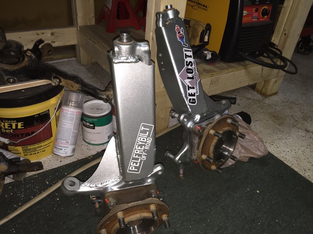

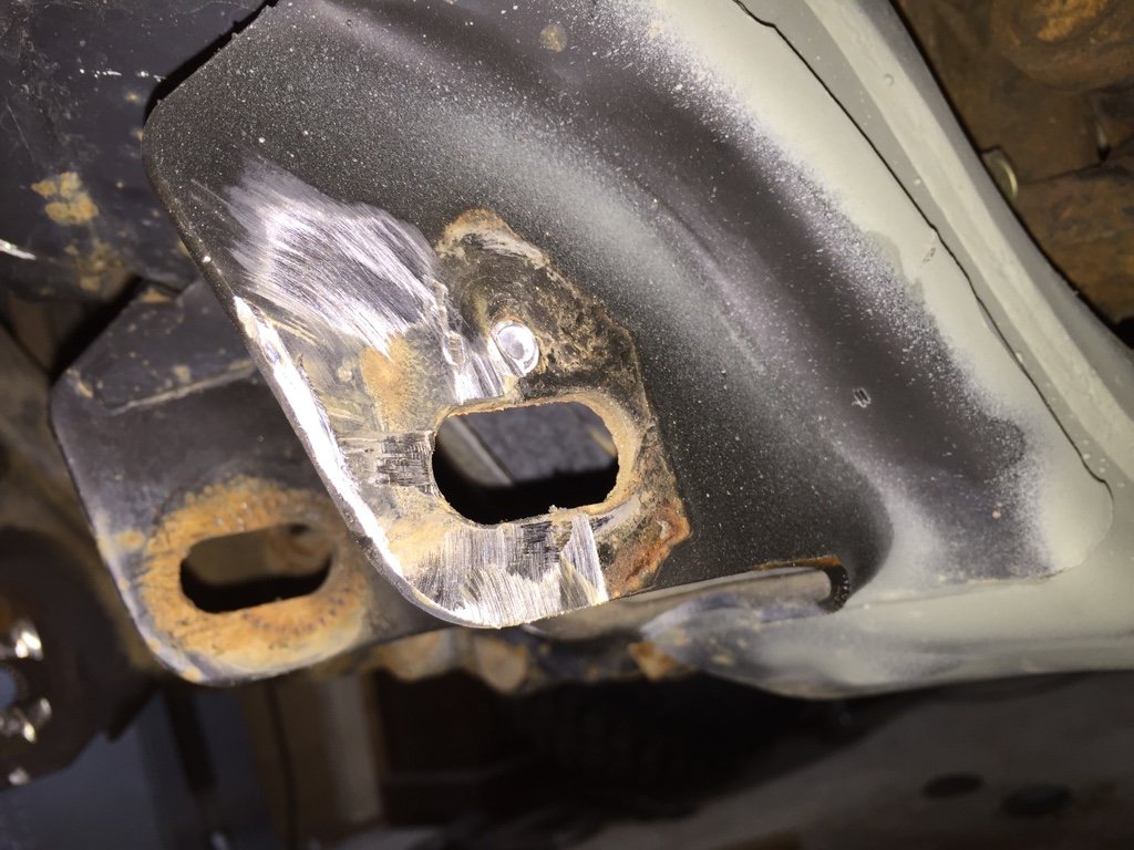

    Cam tabs are about done. Found a better way than drilling the spot welds and its 20x faster. Hammer the tab over, then get a cutting wheel in there carefully to cut the spot weld, tab pops off easily from there.
    Arms should be here mid-week :woot:
    Spindles ready to go.
