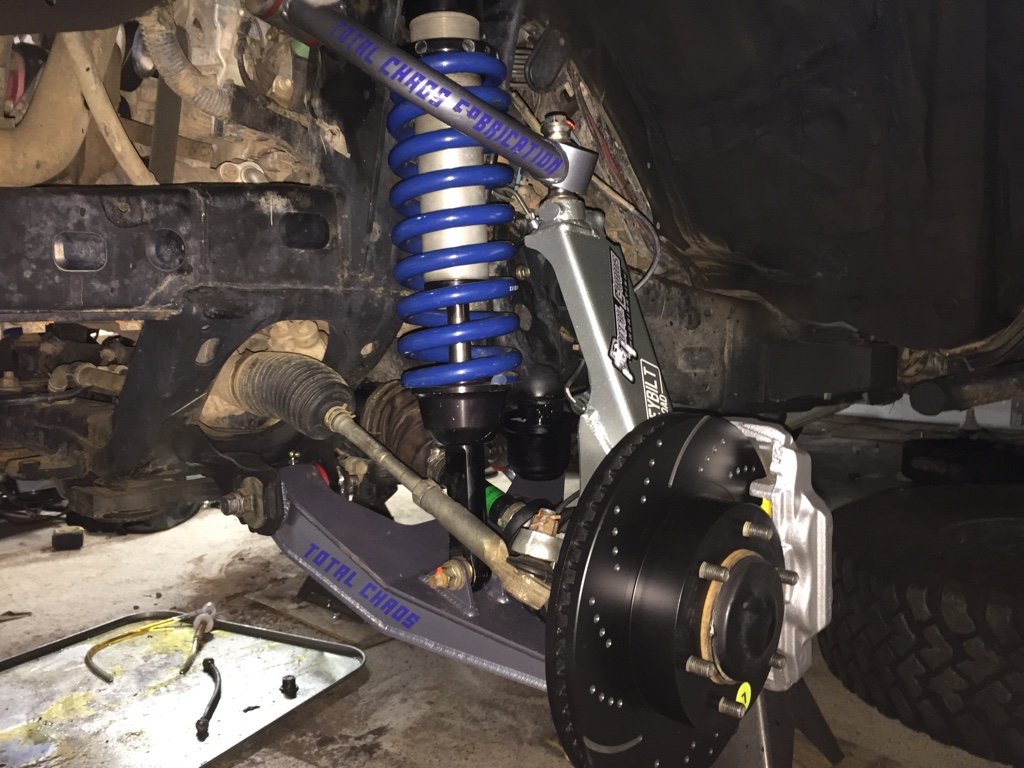

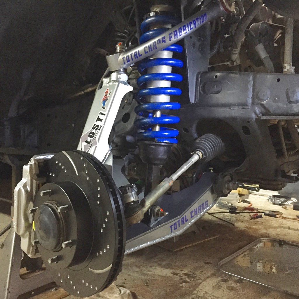

    sure the tc lowers have more range of motion, but you aren't using it vs a ball joint lower. if you have aftermarket uppers, stock lowers, and extended travel coilovers, at full drop, your coilover is the limiting factor. so then you ask, well if I have more travel in the system that I'm not using, why not get a longer shock? reason you can do that is because the shock manufacturers have done their research. if you unbolt the lower shock mount, you will see that the suspension will go down further. and that's great, until you spin the tire and realize that almost immediately after you go beyond the extension of the coilover, your CV starts to bind.
    so to sum it up, aftermarket lowers are for strength, and serviceability. while you can see potential for travel increase on paper, when you factor in other pieces to the puzzle, you cannot get usable extra travel from them without harming other components.

    This, I can maybe squeeze another .5" out of the shock before the CV binds. Not worth the headache of taking the shock apart.
