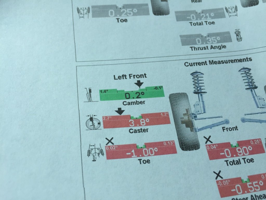

    out, as in the inner tie rod is threaded all of the way into the outer? temporary solution until you can figure out what's actually wrong, is to cut a little off the end of the inner tie rod, so you can thread it further. not sure if they are heat treated though, so to be safe, cut it with a saw, not a grinder.

    Yes, fully threaded in and need to thread more in.

    I have the exact same problem. I'm going to shorten my tie rod extensions.

    Sorta, still gotta figure out how to cut it straight...

    Band saw or chop saw.

    When I had my DB Taco we had to trim the tie rods to get it to align.

    Anybody know how many turns a degree is?

    Chopped .4". Much better, eyeball says it's close and it should be close enough for a road trip.
    Also, alignment at Firestone confirmed my hunch of 1* caster gained with these LCA.

    Hey noticed you were having an alignment issue. Is your guy plugging into your OBD connector and reflashing your steering? My guy didn't used to, but when I got one on my way out to Moab the guy at big O Tire told me our trucks need it. Since I got back I have my guy not skip that step anymore and my wheel being off isn't an issue anymore. Well sometimes because my LCAs are effed up, but once that is fixed I don't anticipate an issue.
    Before that I had the same problem with the TRE being maxed out, but the wheel need more thread.

    I didn't reset the computer but guess I should've. I trimmed the TRE :eek: since I needed to go on a road trip that night.
