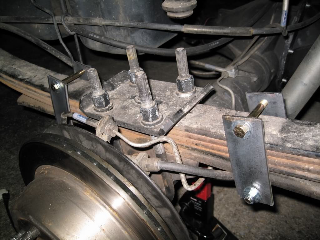

    It's so easy a caveman can do it. Get a good C-clamp and hold it all at the kingpin, pull the leaf-clamps off and let the c-clamp out slowly. Repeat in reverse to repack after you've removed leaves.

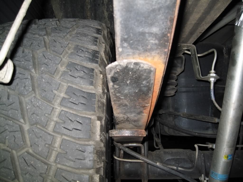

    Leaf "clamps" not leafs... What scares me is pulling something that is meant to hold the integrity of the pack... All that stress on just the main leaf when drooped out is no bueno.
  5. Sep 21, 2015 at 8:13 AM
    #2465
    snowmanwithahat
    snowmanwithahat Well-Known Member
    Jan 11, 2014
    #120444
    1,555
    2013 Spruce Mica DCSB, TRD OR, V6, Auto
    Oh, ok.
    Yeah I wouldn't do that either, but only because the springs might shift. I think the main spring can support the weight of the axle drooping completely on its own. On my XJ I have problems with lower leaves "pivoting" and popping sideways. Basically popping out and rubbing on my boggers. It didn't ruin the tire, but did significant visual damage to the sidewall before we noticed it. Had to flex it back out on a rock and take a rubber mallet and beat it back in... Ended up using muffler clamps to get off the trail and keep them in until I could get a better fix in place.
