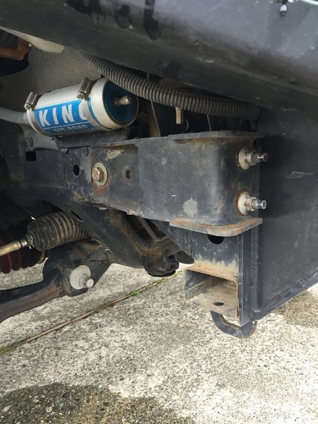

    Yeah that's what I mean, Pelfrey frame reinforcements don't reinforce those and the others do.
    I'm running both Pelfreybilt and Brute Force Fab frame reinforcements

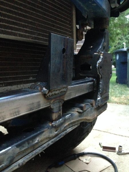

    I think you're missing the point. All those are bandaids the real fix is beefier frame horns. Those gussets you bought still only holding back 18 gauge steel. Here was my fix to the issue.
  10. Mar 20, 2016 at 7:55 PM
    #2570
    2ndGenJonny
    2ndGenJonny Well-Known Member Vendor
    Jan 3, 2013
    #94306
    18,457
    Jon
    Gilbert, AZ
    Beeefy

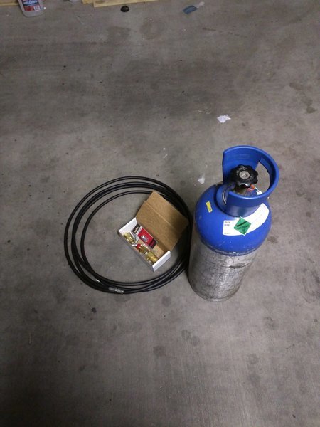

    I was looking at the powertanks but they are just too fucking expensive. So I built this 20# for 200$. I used it for the 1st time Sunday. Went from 18-40 psi in 16 seconds per tire.14581765780261612641388.jpg
    I went with a 20ft custom cut hose at a Hydraulic line shop. This hose is a bit more than that polyurethane coiled one that you get with the powertank but definitely keeps the pressure.
