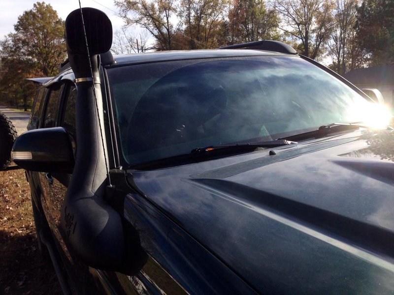

    Another skewp on the truck :cool:

    looks good

    Thanks! Everything didn't quite line up being a '12 but a little dremel work and I got it to fit well.

    looks like shit! The antenna is going to restrict airflow into your sorry ass airflow!

    Can't restrict that huge ass skewp! Now to see if the intake temp will be less than the ambient.
