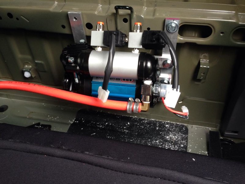

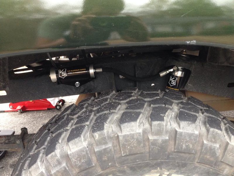

    Mounted and plumbed. Just need to do the wiring :frusty: and run locker lines.

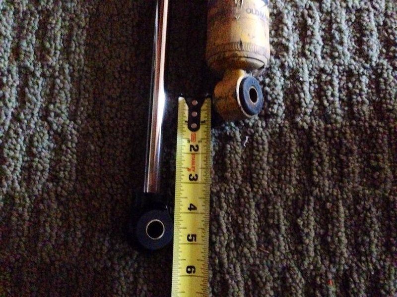

    Hmmm they might be too long when fully collapsed :(

    Not sure yet. May keep them.

    So how much do you want for those used shocks you have there buddy? The ones that are too long, not the OE ones.

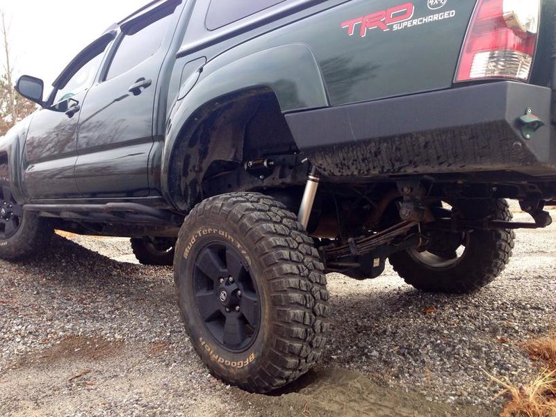

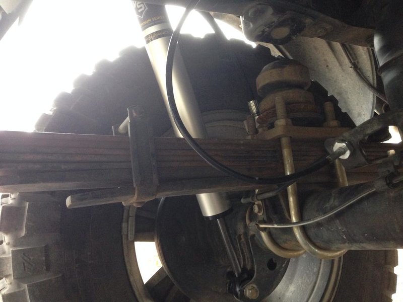

    Not too long :D Just under 2" before the bumps hit and have 3.5" of stroke left at ride height.

    At ride height.

    Bump stops are crucial to long shocks. I told you they would work as long as you have long bumps. Now take us a picture of that shit all dropped out! That's the gooey part!

    :drool: Had about 1/4" of shock showing on the other side with the bump compressed.
