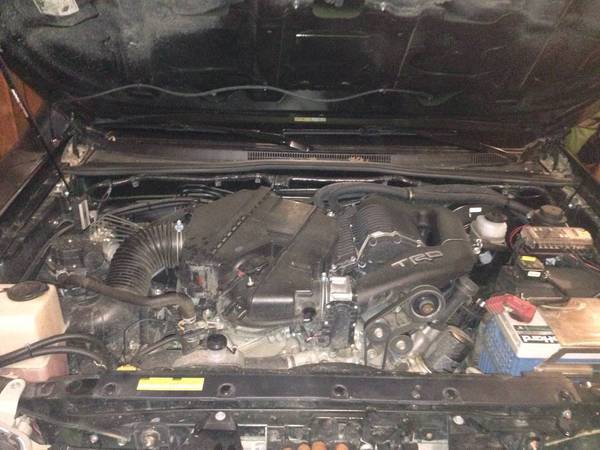

    Dang, glad mines under the hood.

    Mines going there next. Just need to source some wire and lugs.

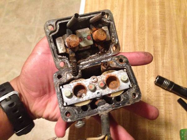

    Well its a land Cruiser with a diesel so I've got that going for me.
    When you replace it do what I did when mine started shitting out...Fill it with a good di-electrci grease and then use some Chaulk along with the gasket to help seal it up. The more and more I read about these ShittyBilt Solenoids the more it was evident the solenoids were crappy at best and need to be sealed.
    Just my .02...Do a search about the XRC8's solenoid issues and the threads on how to seal them up.

    Glad I'm getting the new version with the waterproof ones :D
