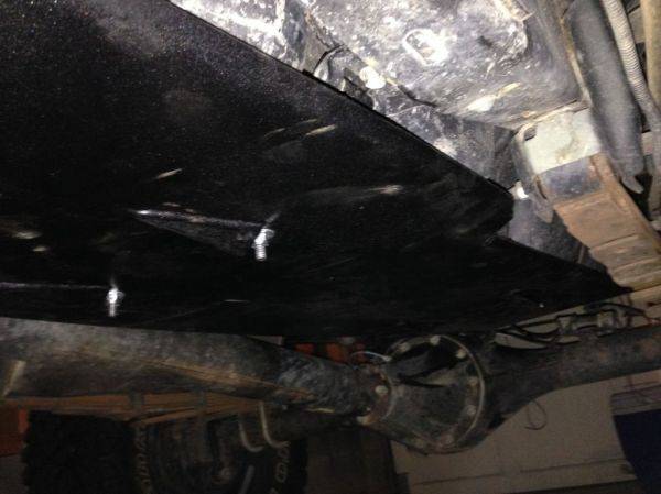

    Pelfreybilt skid is on. Modifying the straps is not hard at all.

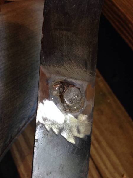

    what size hardware you use ? cap head or standard bolt ? Just need someone to tack mine after I drill the holes

    I used standard hex head, plenty of room in the notches of the tank for it.
    5/16-18 x 1" but as you can see they stick below the guards quite a bit. 3/4" length is probably a better option, enough length for easy install and not protruding below the gaurd much if it all.

    Sweet. thanks for the info, gonna do mine soon. maybe Paul or Brent can tack em for me. I need a little welder, tack welds don't need to be pretty ;)

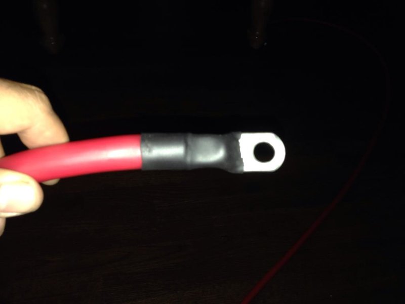

    Winch relocation in progress. Need to order different heat shrink though, 1/2" isn't big enough for this 1/0 wire.

    Stretch it out ! Use Two screw drivers
