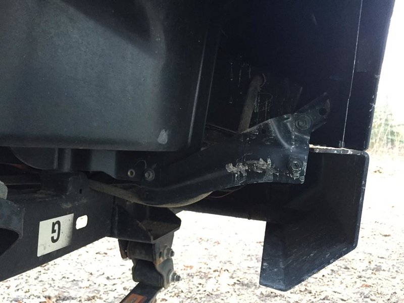

    couple questions.....
    1)hows visibility with that camper and spare on the back?
    2)When you trimmed your fenders in the rear did your remove that metal support bracket in the 12oclock position?
    3)bc you have the HC bumper and the fenders trimmed did you have to support the rear quarter panel where it meets the rear bumper? mine is flapping in the wind at HWY speeds...

    Rear fender/bedside support

    thats awesome..... i threw all that shit out unfortunately.... may hit the junk yard

    Just grab some flat stock aluminum and bend something up.

    did you do that from the beginning or did you see the need for it after a while and did it later?

    Did it within a week of cutting the bedsides.

    /\/\/\ This. I made my supports with a piece of scrap aluminum I had around, think the piece was maybe $5 at the local metal shop. Bent 90*, drilled at each end and used a strip of rubber to keep from scratching the paint.
    29DB0B68-037F-421C-BD54-DEC503BAA4EC_zps_f2143c7a8fcf89906d891d45c6412ac65a770cc5.jpg
    Front one I just cut and rewelded to shape.
    58C8C13F-05E5-4D55-88C9-4D38D45D66CE_zps_639b1bf0235fdf7e56a673bcbffa780e92fa9cff.jpg
    I did have some kind of crappy support at the top of the wheel well that was bolted in the bed. The screws were rusted in and stripped so I just cut it off and chucked it in the scrap pile.

    I didn't even bother redoing the front brace. I also have a short bed though and there's not much there to flap in the breeze.
