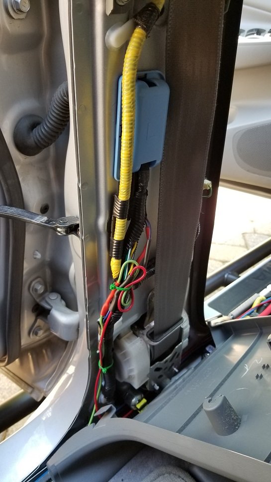

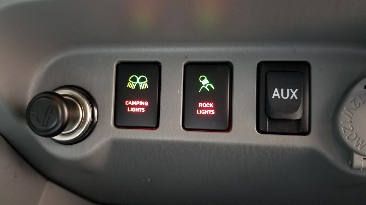

    Perimeter lighting control using OEM keyless entry remote. Double click on remote unlocks all doors and powers up perimeter lights (single unlock click unlocks driver door only no lighting), one click locks all doors and powers off lights. See video above.
    positive pulse latch on/off relay setup:
    5/2018
    positive pulse lock/unlock source:
    5/2018
    ***tie into rear left door lock positive pulse & unlock positive pulse wires
    disable function button (camping lights):
    6/2018
    *** Air on Board small push button switches for OEM locations, Green and Red, highly recommend perfect fit no mods
    5/2018
    ***short time after video taken I researched on TW the manual procedure for disabling the beep

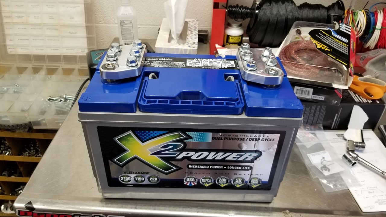

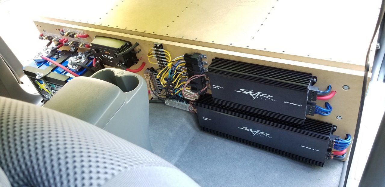

    Secondary battery selection (based on TW research).
    X2 Power 31 series AGM battery
    Jim's Machineworx Bolt Down Style- 5 Lug Battery Terminals
    6/2018
    ***a lot of research done on TW and other sources to decide what location to mount this secondary battery, ultimately I chose a location I've never seen posted online

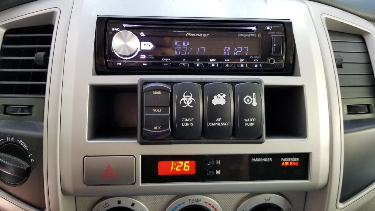

    I now have 12 months til my MT/ID summer 2019 Overlanding trip. This is where my Overlanding build takes a strange detour :)
    I knew I wanted to update my stereo all along just did not know to what level. I began with the idea of a new head unit, door speakers, and an amplifier.
    Pioneer DEH-S6010BS
    Image Dynamics ID65CS's & ID65's
    Skar Audio RP-150.4AB
    7/2018
    ***DIN pocket switch mounting mock up, ebay dual battery digital voltmeter, OTRATTW switches

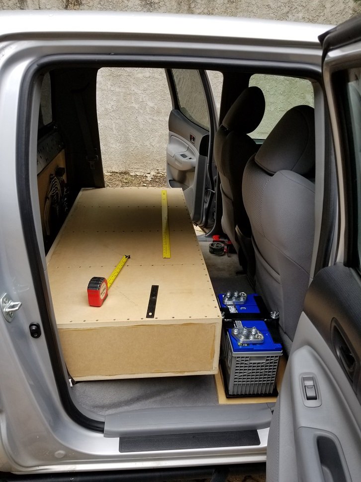

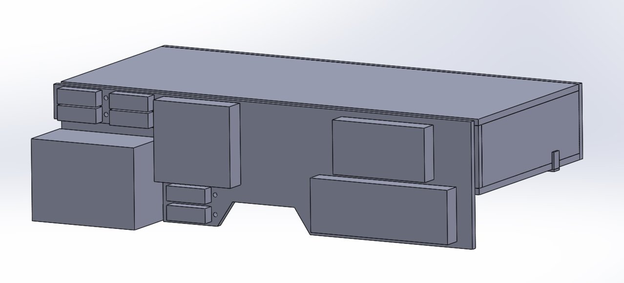

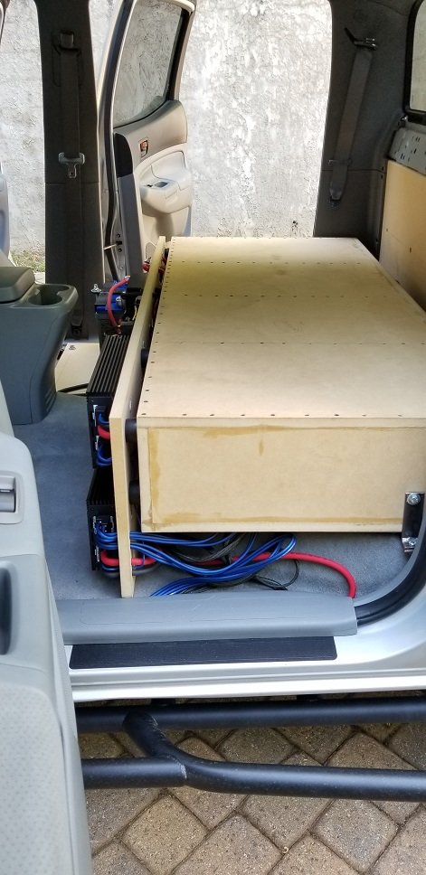

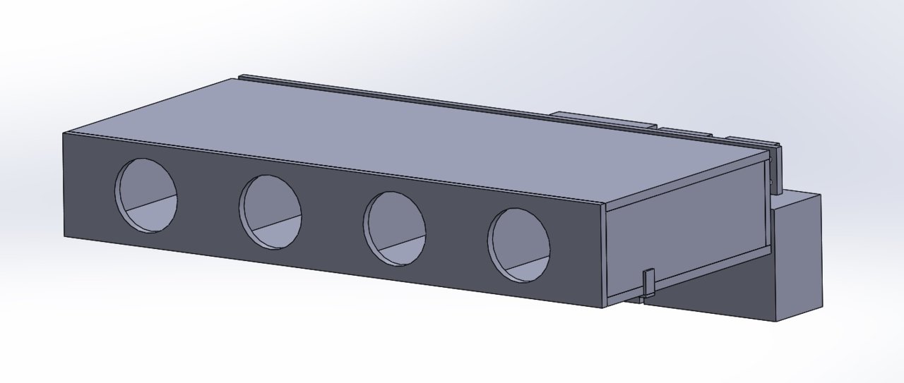

    Based on my needs for a 2 week overlanding trip I decided to remove my rear seats, to build a platform to mount an ARB refrigerator and open up for gear storage.
    Once everything was removed I was better able to visualize what the platform may look like, for my needs it would need to be at min 6" tall for clearance of other items. That was quite a bit of unused volume under the platform, I debated using it for storage but integrating access would be problematic with a refrigerator and gear sitting on top.
    ***Disclaimer*** This is where things start to go silly. I've got a year til my overlanding trip and I'm bored I need another project. Keep in mind everything I post next (from the last 6 months) will be temporary/modular installs. Strictly for fun if not academic, to learn something by doing something. Initially I thought I could integrate it into my Overland build but weight and size was prohibitive. Plus as you will see things got out of control. :) The "final" install will actually be coming out of my truck in the next month or so. ***Disclaimer***

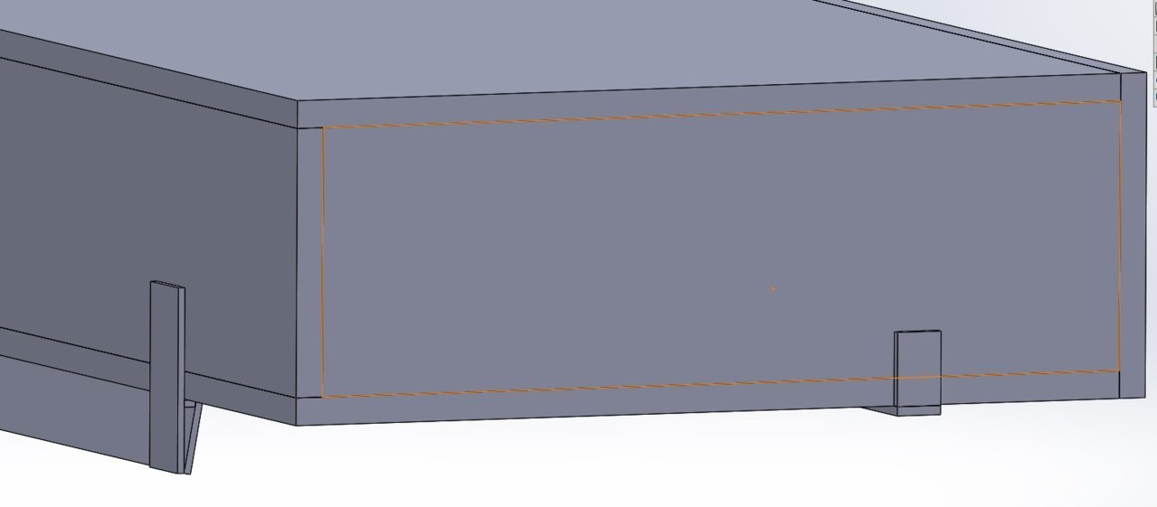

    Why not use this unusable space as a platform and a subwoofer enclosure? Off to SolidWorks to model a bunch of different ideas, this is what I ended up with.
    ARB refrigerator platform subwoofer enclosure w/ amplifier, power distribution, and control rack:
    7/2018
    *** mounting brackets utilizing existing threaded hole positions on the truck side and t-nuts on the box side
    *** (4) rear firing 8" subwoofers
    Casper66 likes this.

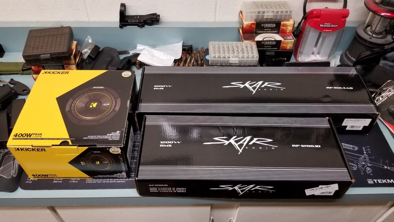

    Buying more amplifiers and subwoofers.
    Skar Audio RP-1200.1D
    Kicker 8" 4Ω SVC 44CWCS84
    7/2018

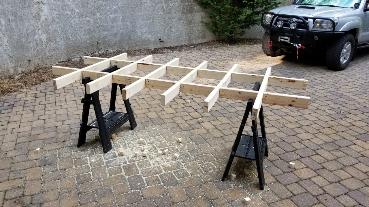

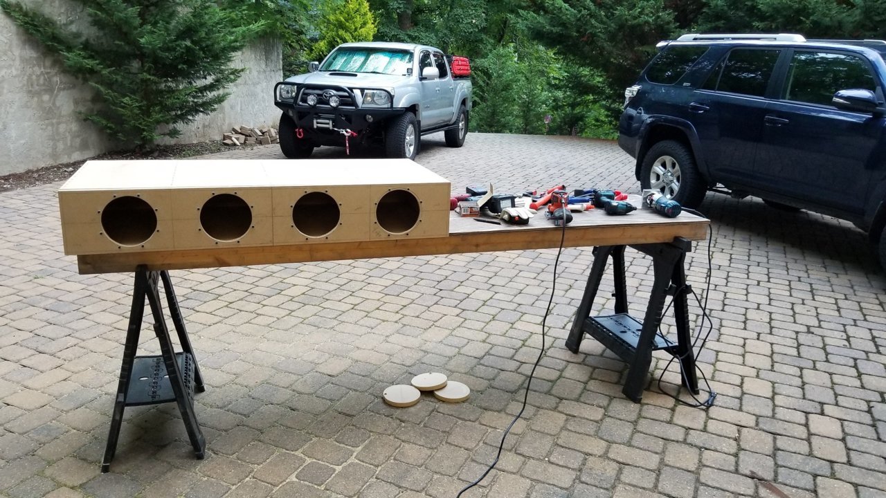

    Time to make some sawdust.
    Cut table (2x4's, Bluehawk saw horses from Lowe's):
    7/2018
    ***a cut table greatly aids in making straight cuts in MDF, not sure how I got along without one in the past

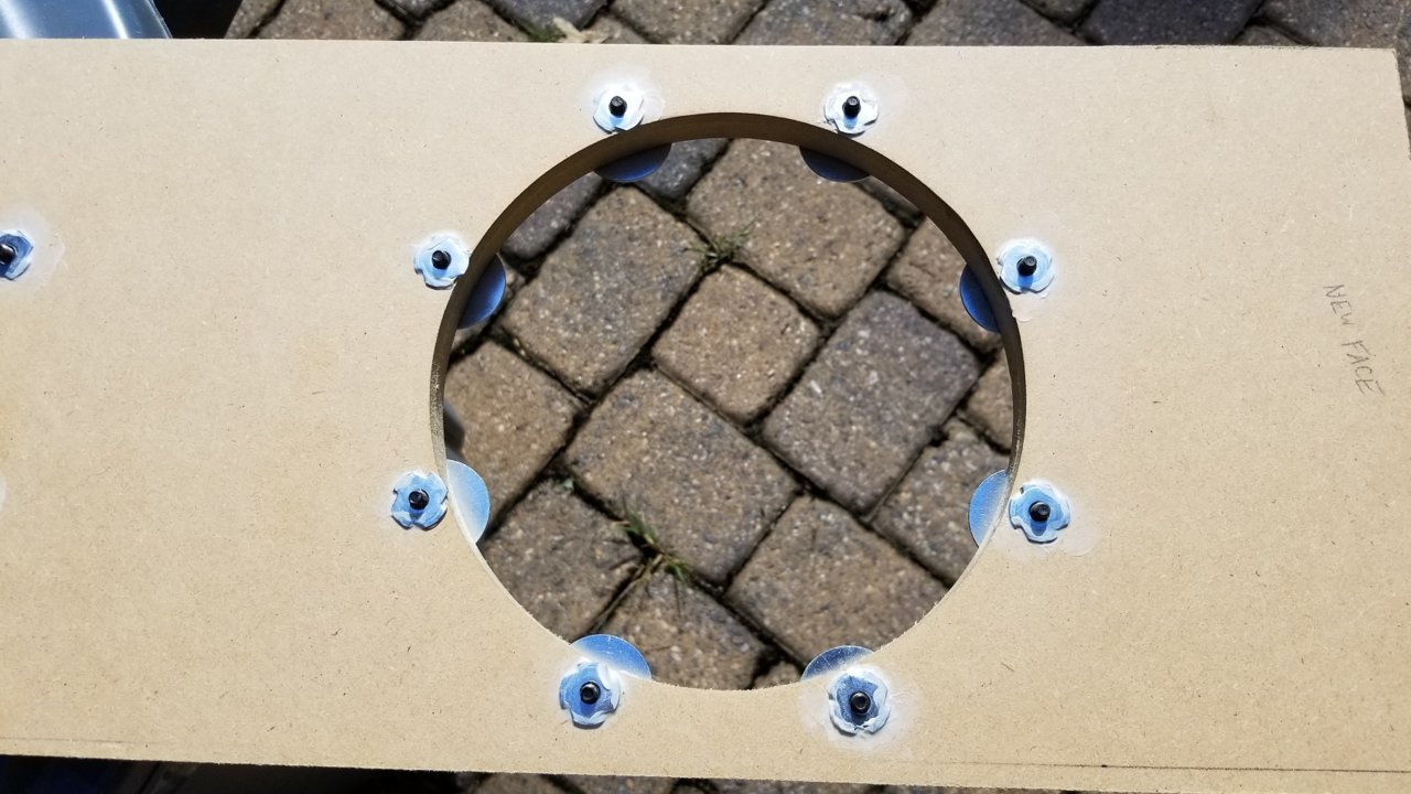

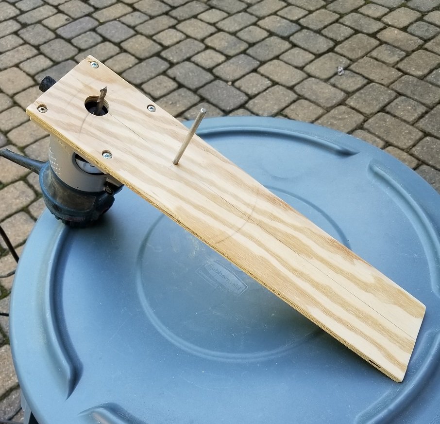

    router hole cutting jig (1/4" plywood and steel rod):
    7/2018
    ***absolutely worth the effort it took to make one, perfect holes
    t-nuts for bolting subwoofers in place:
    7/2018
    *** never liked the idea of using sheet rock screws to mount speakers (extremely time consuming uugghh)
    platform/subwoofer box complete:
    7/2018
    ***first carpentry I had done in over 10 years

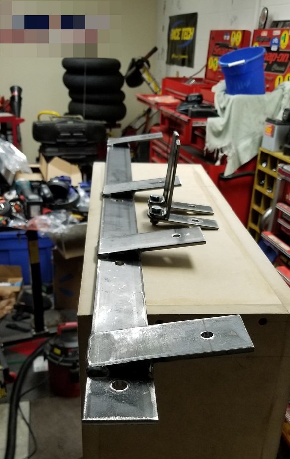

    steel mounting brackets fabricated:
    7/2018
    The install.
    7/2018
    ***CTEK DS250SA DC to DC charger (Aussie approved)
    ***left unfinished as I had no clue if I would love it or hate it
    Loved it! :) (to much as you will see)

    Behind the passenger seat, using a battery tray kit then fabricated a heavy duty retaining bar from flat bar and angle iron (bed liner), tray mounted to MDF board bolted through rear passenger seat mounting points. Rock solid mounting.
    7/2018
    I'll work on a schematic of the relays. See below.

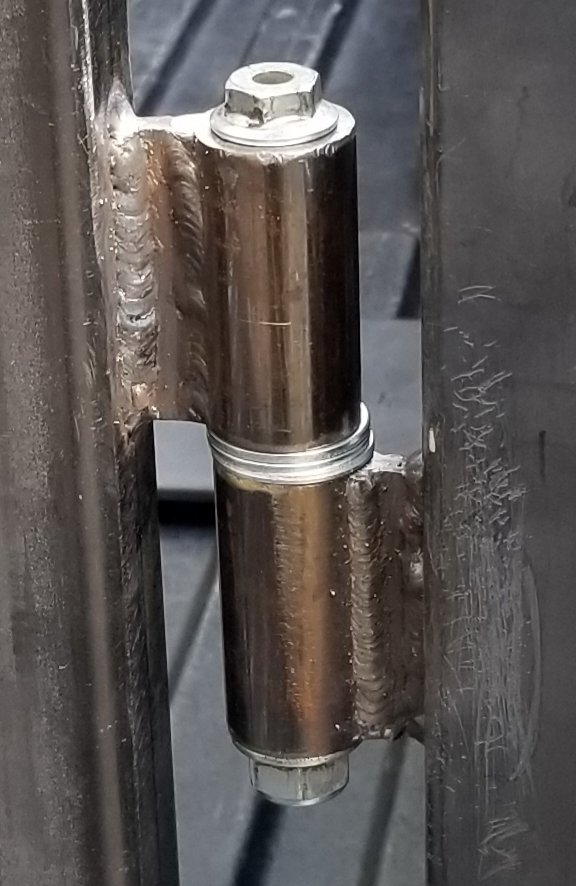

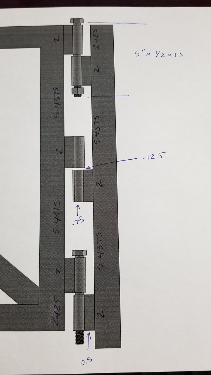

    How did you make those hinges for the tire gate??? I would like to see some more detailed photos of them. I am going to be making some swingout tool boxes and haven't figured out a sturdy hinge for it.
    Casper66 and pabstsmeared like this.
  19. Feb 19, 2019 at 3:38 PM
    #59
    ckrockets
    ckrockets [OP] i don't own a couch
    Feb 16, 2008
    #4757
    332
    Kalispell, MT
    2010 Tacoma 4X4 TRD sport DCB short bed
    It's basically a super heavy duty piano hinge spaced out with multiple pins.
    Spacing was super critical in the design.
    With the bottom two pins (bolts) inserted into the gate side a helper has to hold the pins up while you move the hinge into alignment then they drop the pins. The top pin can be inserted last. Pin/bolt length is specific to the design. I used Solidworks to design the hinge which helped tremendously, it can be done on paper I'm sure.
    I'll post some more close up shots of my SolidWorks model.
    ***The stand offs were 0.25" plate, the tubing was 1" (0.25" wall), super slow wire feed high heat penetrating welds maxed out my 120V welder capabilities.
