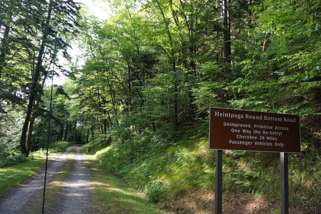

    One of my overlanding routes would take me along this ridge line. Took this photo on the motorcycle trip in July 2017.

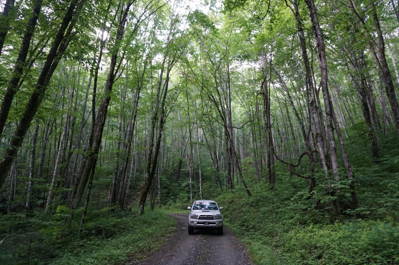

    This is probably the closest thing (but not even close) you can get to real Overlanding in the Southern Appalachians. In my humble opinion there is no Overlanding in the South East. Off-roading, 4X4ing, mudding, rooting, mud bogging, generally tearing your truck up (on privately owned land) ok we've got that but not Overlanding in the purest sense. The public land here has plenty (100's of miles) of National Forest MVU dirt roads but they are on continuous lock down.

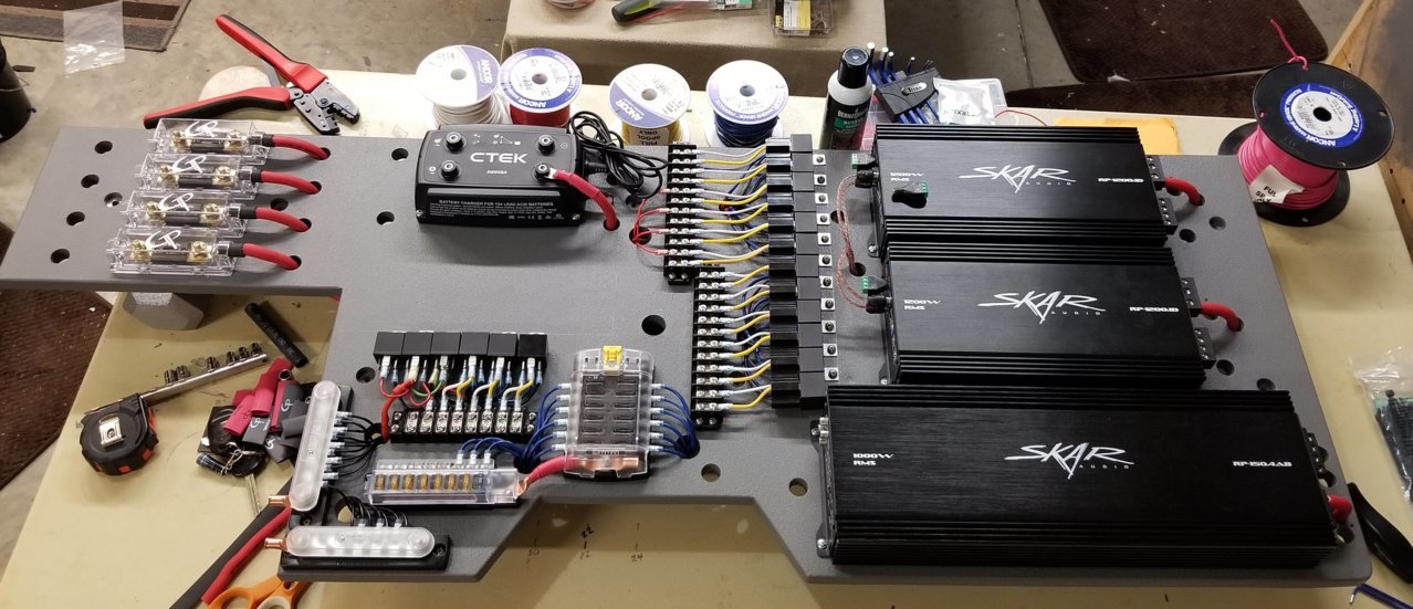

    That amp/distribution rack is off the F'ing chain!

    Thank you, I put alot of thought into the layout, to much :) Here's a straight on shot just before install, more details can be seen.
    The empty spot below the CTEK is for a CTEK smartpass at some point. For up to 140amps of recharging with starter battery assist. The main CTEK has an MPPT input for solar panels, future mod.
    ***The rack can be removed from the truck in this exact configuration so it's basically a modular install.

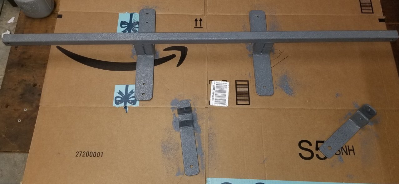

    Was able to get the metal fabrication done on the rack today before the rain started again.
    3/3/2019
    ***radiused corners, dressed welds, and deburred
    ***degreased and first lite coat of Duratex (color matched to interior)
    2 hours to surface dry so I can put the final heavy coat, then 5 days to cure.
    This stuff is great I highly recommend it.
