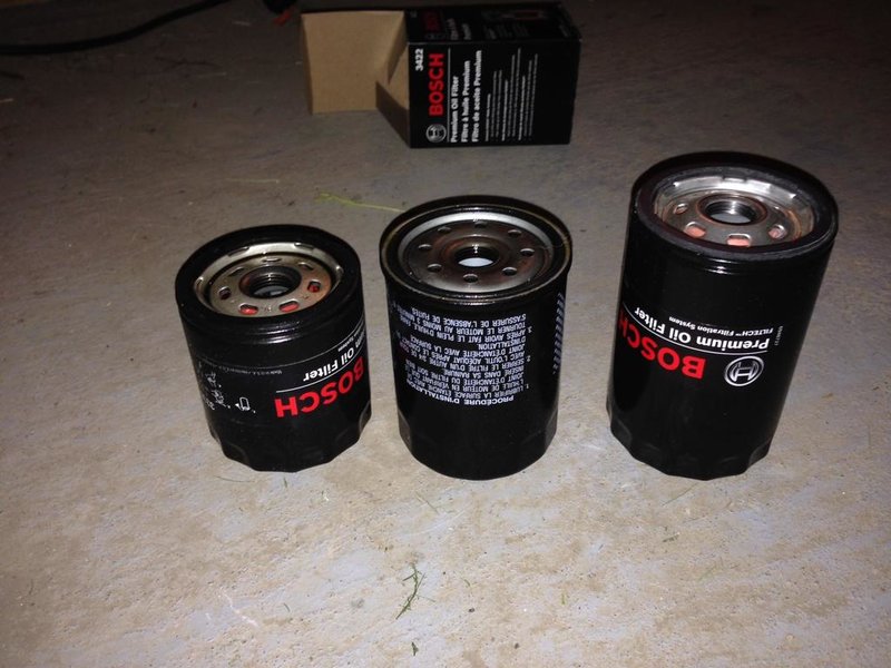

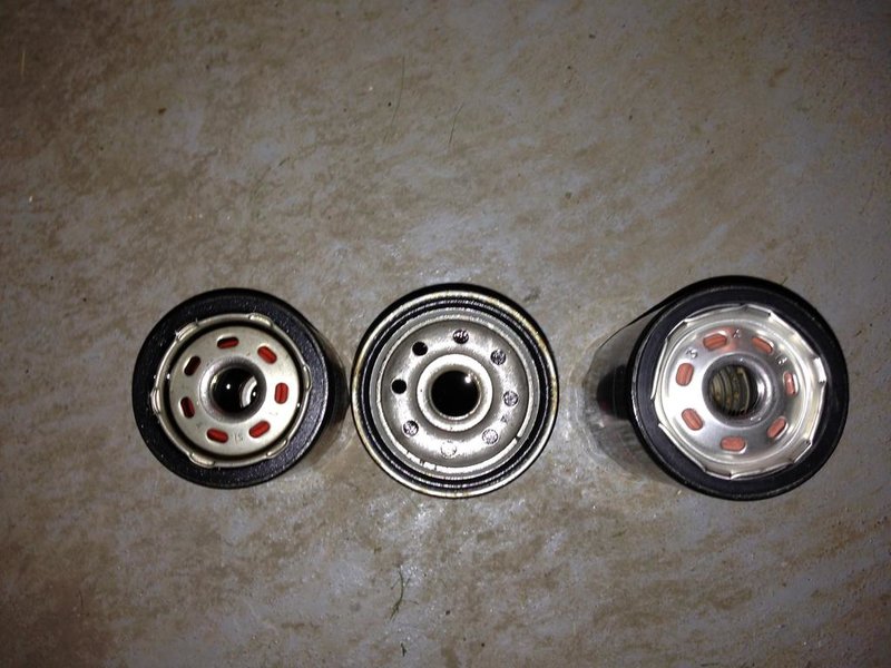

    There is nothing wrong with the Toyota filter, but I was able to grab a dozen of the OVERSIZED Bosch filters that fit my truck for $2.50 (Canadian dollars) a piece at wally world on sale. Sadly wally world is going back to fram :(, so once these are done I may go back to the Toyota filter based on price.
    For anyone who cares to listen and comprehend there is literally no important difference, other than size, between a Bosch OVERSIZED filter (I'm not talking about the one listed in the book as replacement, which is filter number 3330, I'm talking about the OVERSIZED filter 3422) and a Toyota OEM. I'll open one up tomorrow just to prove it. I did attach some pics of the outside canister just so you guys can get it in your head that there is a really good alternative to the Toyota filter. BTW in the picture the backflow valve on the Tacoma OEM failed, but I chalk that up to getting a bad filter. Anyways, There's lots of youtube videos of the guts of these filters, and the common complaint in all videos/forums is that the aftermarket filter has less media, because it is physically smaller, than the Toyota OEM filter. When you buy an OVERSIZED version, you are buying a physically bigger filter than the Toyota OEM and you are getting more media surface area and can surface area, which works to your engines benefit by enhancing oil cooling a smidge and increasing filtration, especially under high stress conditions.
    I agree with you that a Toyota OEM filter is way better than any filter that's listed as being a direct replacement from ANY aftermarket manufacturer. However, by going to a larger filter with larger surface area (both media and external) with no ascertainable difference in; filter media, media linkage, back flow valve, and material construction, you are getting a superior product that will give superior results in the long run.
    I've backed up this argument with some pics below. Tomorrow if I have time I'll even cut these bad boys open to prove my point. The filter on the left is the 3330, the middle is toyota OEM, and the third is 3422.
    I'll get off my soap box now lol. Sorry I just get really frustrated that no one can see this for some reason, other than those of us who dug around to find the larger OVERSIZED after market filter for the Tacoma.

    Check my above post and be amazed bro! There are advantages to going with a larger filter especially when you want a cooler, longer lasting, engine.
    Seriously, I read that whole thread you talked about when I first changed my oil and anytime someone tried to bring this fact up they just got ran over by a :crapstorm:.

    Agreed on all points! Sorry I just get tired of all the knocks on aftermarket filters. When I can buy a Bosch 3422 filter, which i consider a mildly better filter than the OEM part, a block away rather than driving a half hour to my stealership or waiting for a box in the mail I made an easy decision. I think It's a worth while discussion point, I guess tomorrow when I hack them open we will see the difference. Maybe I'll start a whole new thread.
