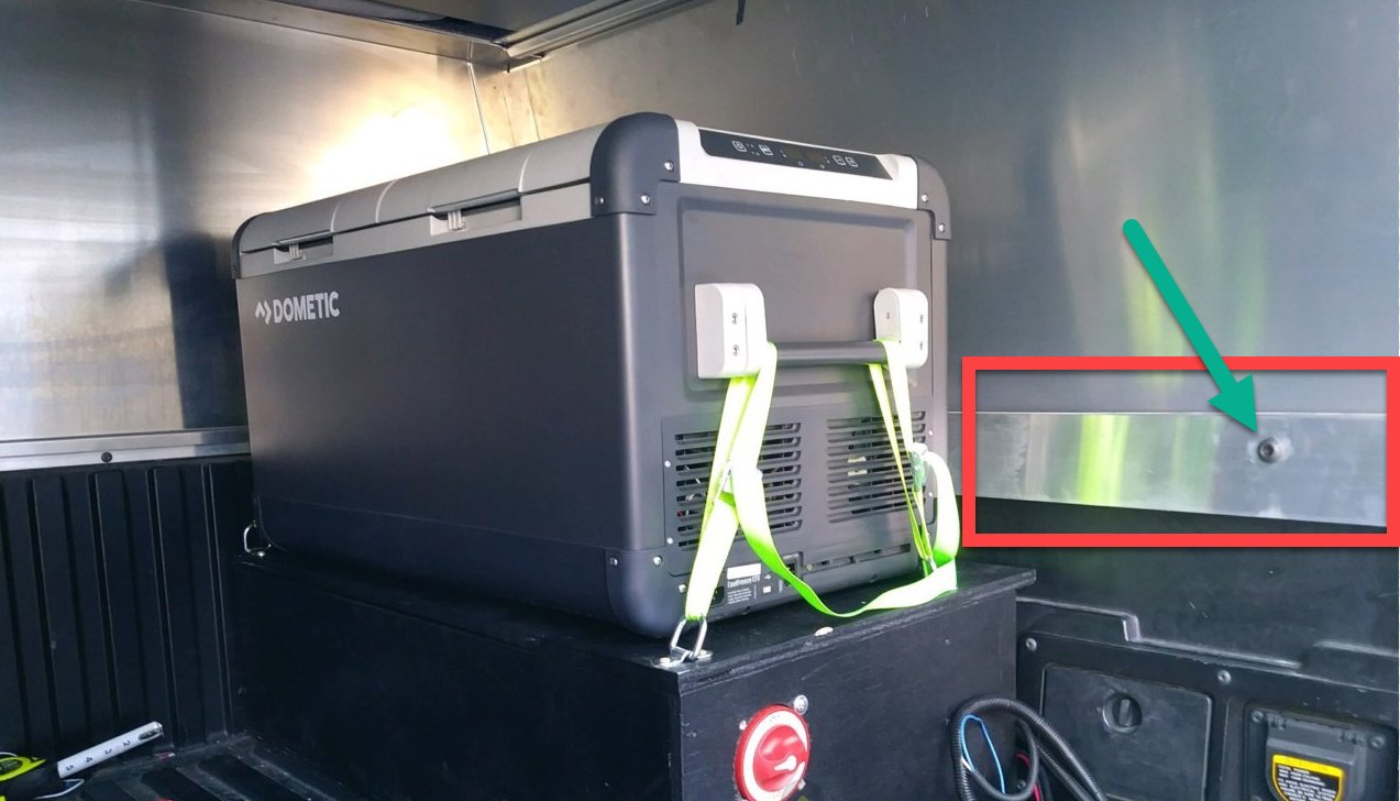

    Taking off the plastic on top of the bed rails and adding a couple bulb seals is how AT mounted my AT Habitat. The flat surface, I've read, is easier to seal (even with the holes). Some type of tape can be laid down flat over it all, then the bulb seals added. Next, I'd suggest thinking about using plywood in place of your Clamp. Screw a strip of plywood (4-6 inches?) to your 2x4, hanging down over the Tacoma's bed track. You can get large square nuts to slide into the track, and then bolt through your plywood into the bed track.
    AT used aluminum angle iron, but the 2x4 and plywood would take it's place so you can stick with wood construction. Drilling the holes perfectly to line up could be a challenge, but if you are taking this project on I'm sure you can handle it. I'd also refrain from drilling those holes until your camper is finished, with as much weight as possibly compressing your bulb seals, as you obviously won't have a screw/clamp to compress.

    Easy to deal with the hole locations. Put the plywood on the bolts before screwing to the 2 x 4. Build up the whole cover so the seals are compressed. Then screw the plywood to the 2x4s.

    I wouldn’t use plywood for the connectors unless you want to see the traffic pile up the wreckage of your cap causes in your rear view mirror. Plywood just isn’t strong enough to use in this application. Only use clamps if you provide a lip for them to engage and are fastidious about checking them. A metal strap to the bed rails with bolts and lock nuts is best and you still want to check them.

    You are really being dramatic. Plywood could be fine for this - depending on thickness, number of fasteners, etc.

    For the shell, yes. But I would still use steel for the straps that connect it to the bed.
