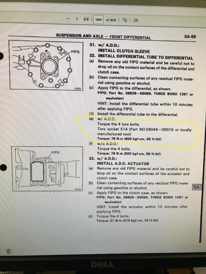

    My '97 V6 Taco 4WD w manual hubs used hex head bolts, but FSM calls for E14 torx bolts w/A.D.D. HTH
