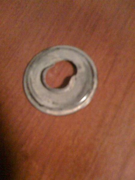

    I had the EXACT same problem. Squeaks and rattles when hitting any sort of bump, coming from the front driver shock. Turns out, they put the washers and bushings inside the strut backwards from the factory. A bushing had gone out and a washer was busted. I got new bushings and washers, had them put in and no trouble since.
    Heres what the washer looked like after it got busted and worn out:

    YES! It squeaked like crazy. Get under the truck and push up and down on side where you hear the squeaking ( to make the shock assembly move up and down). If you hear it, i'd check out the nut that screws down on the top of the strut and see if it's screwed down all the way and if everything seems tight. You could actually feel the washer under the nut on my truck and make it rattle.
