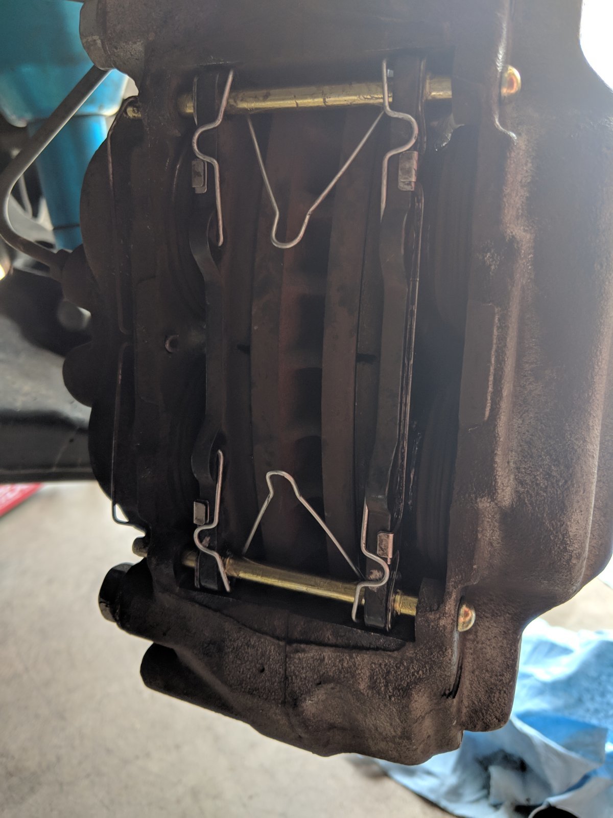

    So lifted the truck and rocked the front driver tire and could here a clack going forward and backwards. Tried passenger side no sound. Got underneath and had wife move the tire and when I held the brake pad the noise stops. Going to try the dual brake pad clip mod and see if that keeps the pad from slapping and if that is all that was causing it. Will update if it solves it or not.

    Just got done adding a spring to the top of my caliper so I got one on top and bottom of the pads. Wiped the pins down light with anti seize and now no more clanking going forwards and backwards. Did the passenger side while I was at it.

    Check out this thread they talk about the noise. Mine if I jacked it up and moved tire forward and reverse quickly you could hear the click clack noise( little quieter without load) but still loud enough to hear.
    https://www.tacomaworld.com/threads/front-disc-brake-click-clack.609528/
  12. Feb 5, 2024 at 3:02 PM
    JMoore2651
    JMoore2651 [OP] Well-Known Member
    Jan 22, 2024
    #442214
    56
    John
    2020 Quicksand Tacoma TRD
    Bilstien 6112 600lb spring 5160 rear with HS 3 lead aal spc uca Ecgs bushing oil separator ARE overland cap 285/70r17 on black rhino Chamber wheels Blacked out rear chrome bumper corners
    Also here is a good picture of putting two clips on the caliper. Mine only had one on the bottom. I have not had time to pull tire back off so this is from that other posted. Credit to @2WD for great photo.
