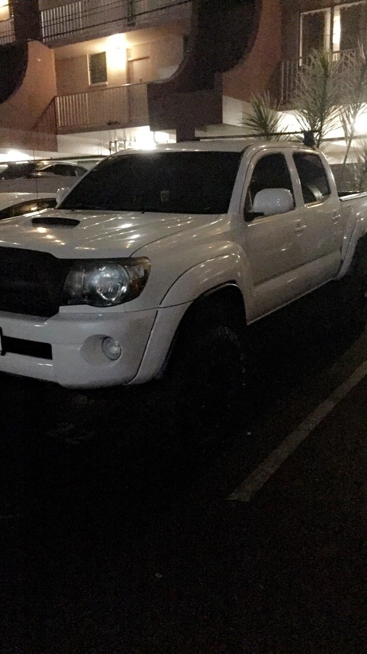

    2011 white Toyota Tacoma lifted
    Hi need help , I have a lifted Toyota Tacoma 2011, and when I drive between 25-30 miles and around 40 miles I get this clanking sound . I don’t know what it is. Any answer would be thankful.
