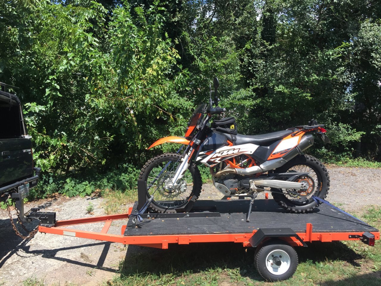

    Looking good! I ran into the same problem loading motorcycles on my old truck and soon to have the same issue with the new truck. I bought a cheap 4x8 trailer to haul motorcycles. Makes it easier to load since it's lower to the ground. Might be something to consider if you have the space.IMG_3564.jpg

    Right on, that’s a likely scenario once I’m settled in the new city. A lot easier to load up solo too.
