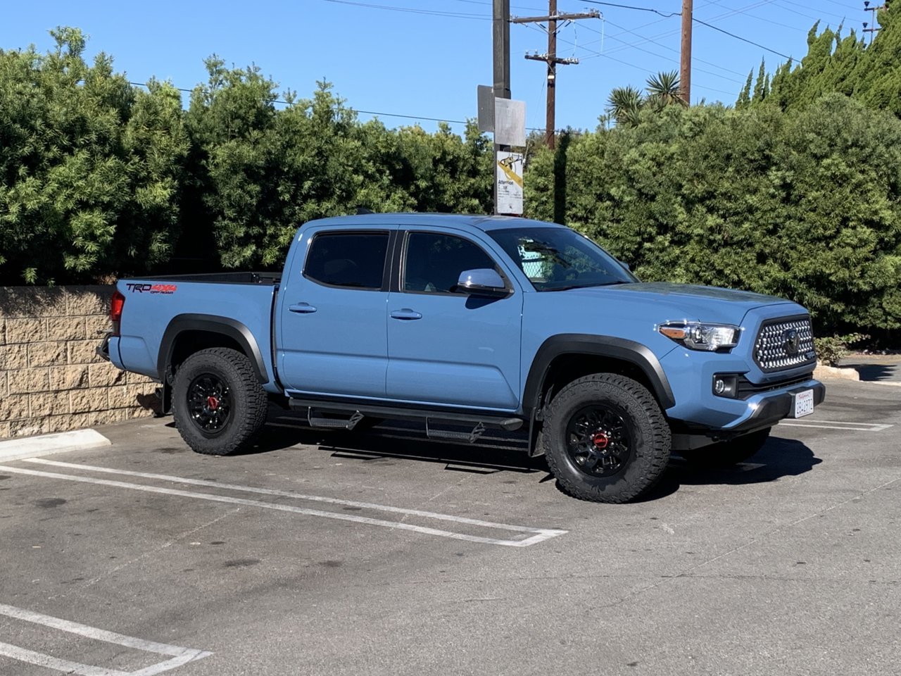

    This is my set up with GY Ultra Terrain AT tire with a Pro suspension. Love the ride and look...DsjvlVG2Su2YZIVuwzRS%Q.jpg
    blaklabl and Jim125 like this.
  10. Dec 13, 2021 at 9:27 PM

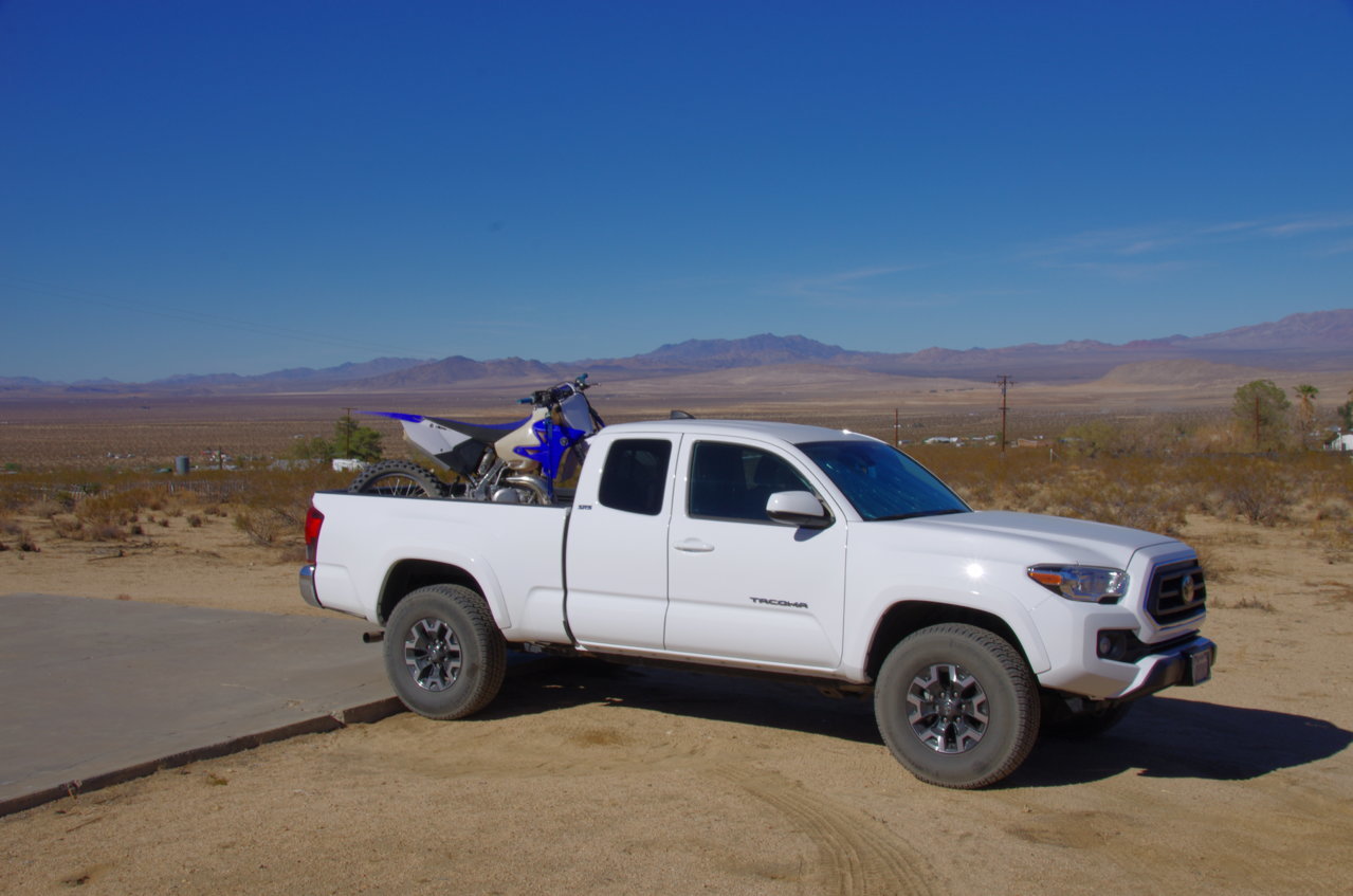

    2020 SR5 AC V6 4x4
    Michelin LTX A/T 2 in 265/75/16.
    No serious off-roading for my Taco (that's what the YZ is for), but I like this LT tire and still get 19 MPG hauling the bike(s) around.

    Great looking truck Moes! Obviously well planned choices. The stance is perfect and a great looking tire setup. Love that color!

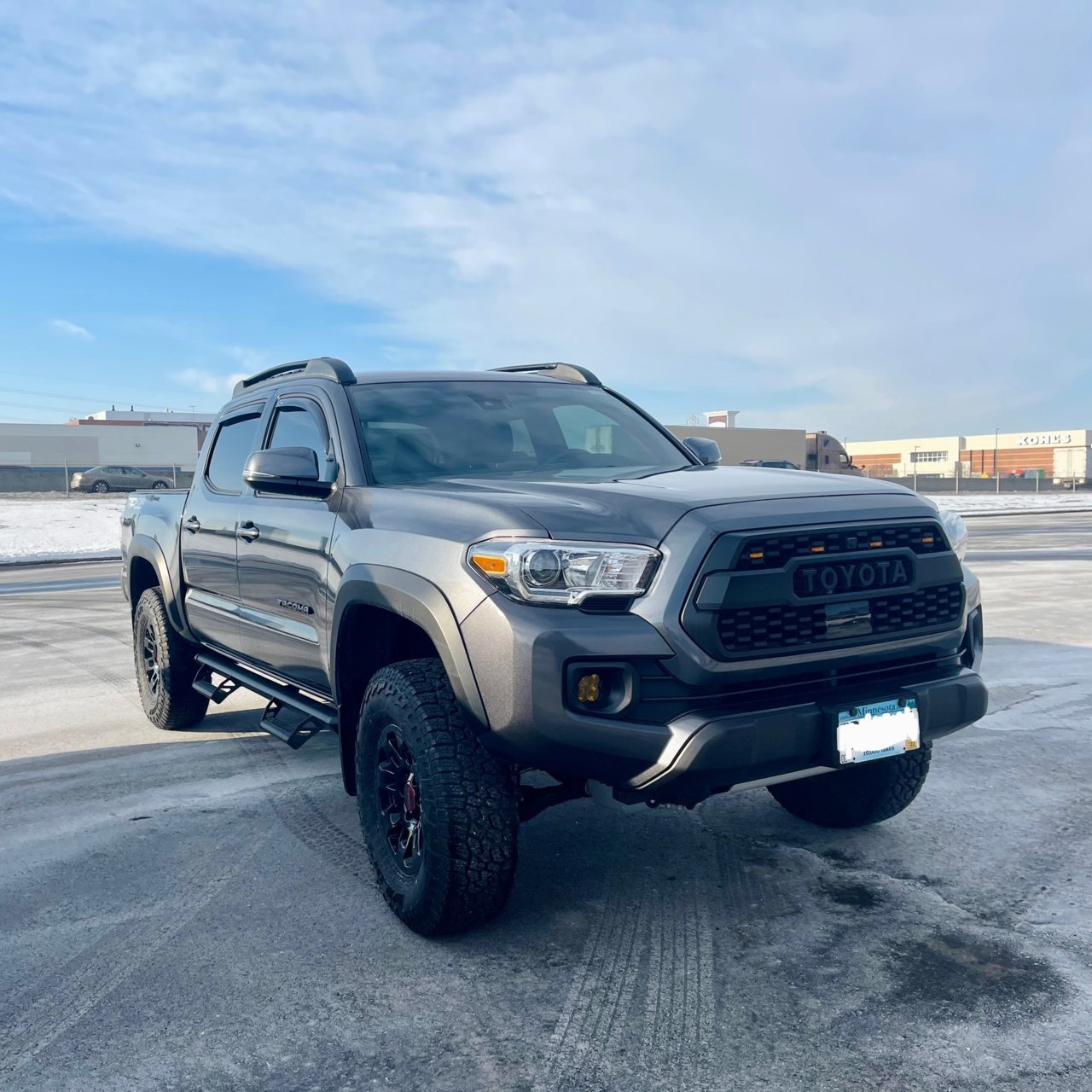

    Wife's 2019 (Manual) came from the showroom with 265/70/16 BFG KO2 and we upgraded to 265/75/16 KO2 last September. If there was any performance hit, it wasn't noticeable. Funnily enough, her "range" hasn't really changed after every fillup, even though the truck is actually travelling 3.3% further. So I'm thinking that since she spends most of her time on the highway, we might have improved her fuel consumption a smidgen by making the effective gearing taller in 6th. (Final drive ratio goes to 2.95 from 3.06)
