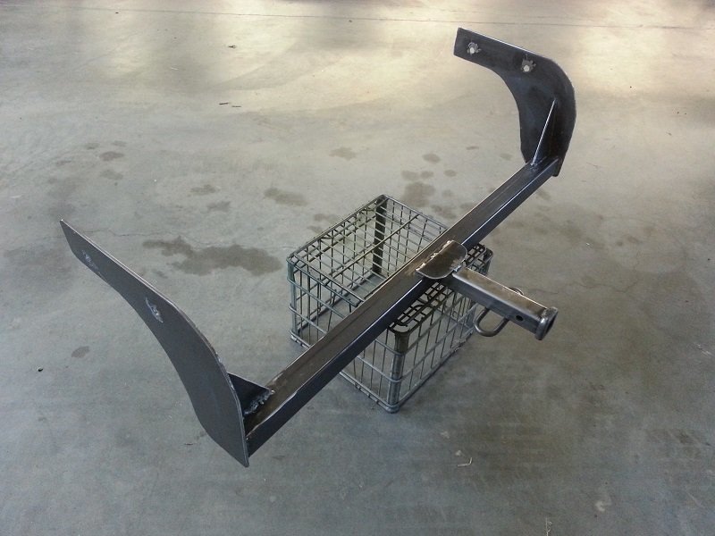

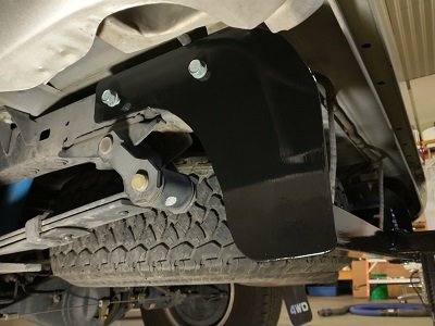

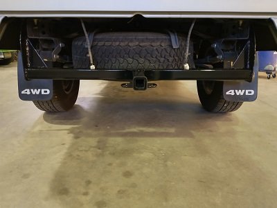

    I finally found the time to build my own. I purchased a 12" x 1.25" receiver tube online:
    https://www.amazon.com/dp/B001GN6MQQ
    ...and went digging through the scrap pile for some flat steel and a piece of 2" tubing.
    Initially, I planned on using 1/4" plate and 3/16" tube, but I decided that the above would be overkill and would guarantee that if anything was bent due to an accident it would be the truck frame instead of receiver. I ended up with thinner 3/16" plate for the sides and 1/8" tube for the cross member, which also saved a little weight.

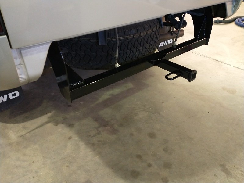

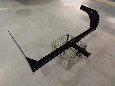

    Painted up:

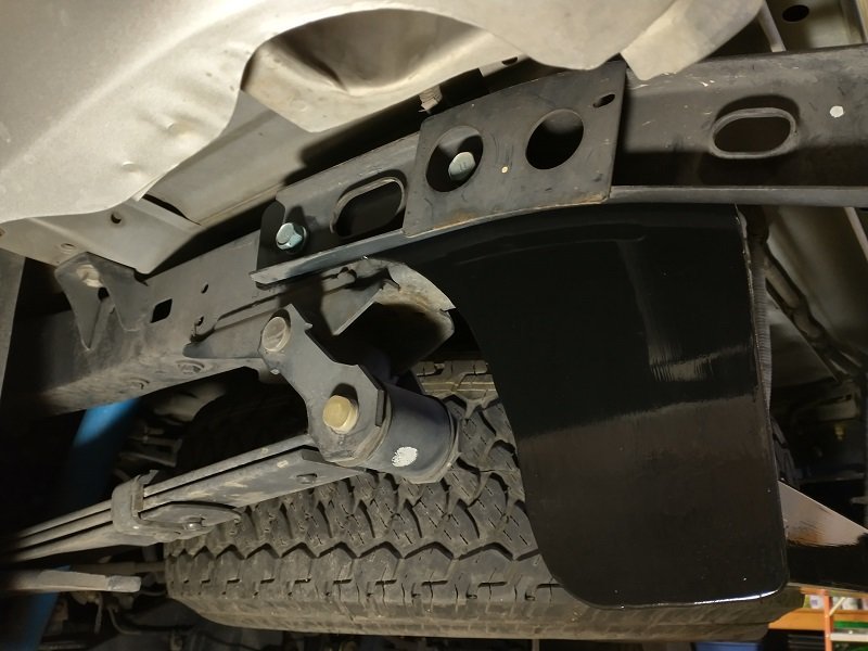

    My experience has been that most aftermarket receiver hitches bolt to the bottom of the frame. The Tacoma offered precious little room for such a mount. So instead, I extended the side plates up where they could be sandwiched between the frame and bumper-mounting brackets on the side of the frame. I used the existing bolts and it mounted up fine.
    Without bumper brackets:
    With bumper brackets:

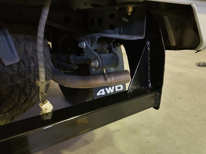

    Of course 3/16" plate could allow for a bit of side-to-side flex, so I added triangular gussets to prevent:
    Ready for the bumper to get re-installed:

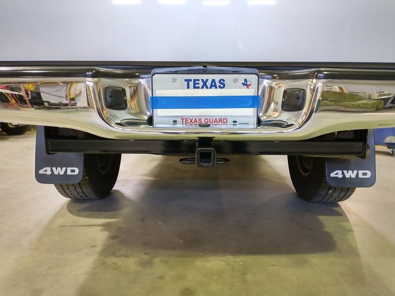

    Done:
