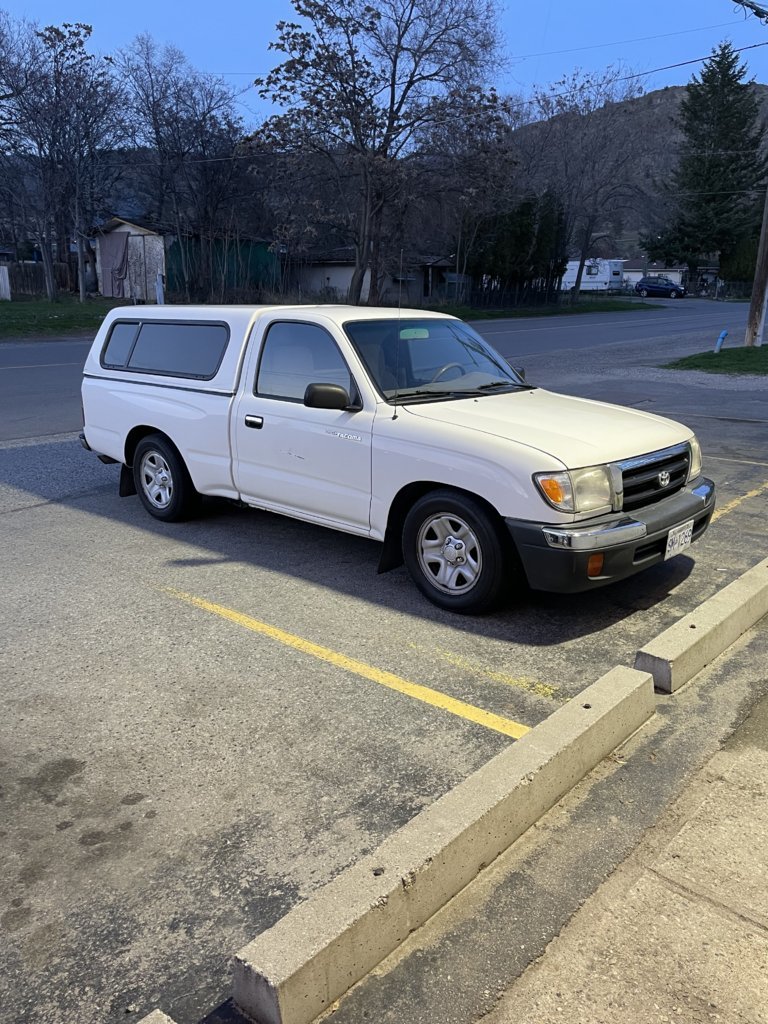

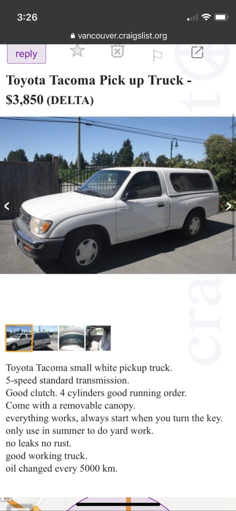

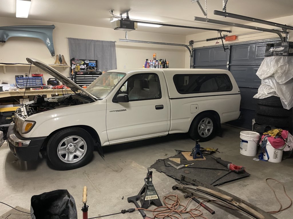

    I've been wanting to build a single cab for years. So long in fact that the style of most builds has changed dramatically and it seems most get towed to wheel. My goal is to build a street truck. No trailers. Drive it to the trails, wheel it and drive home, go for ice cream etc. Because of this a certain amount of simplicity, redundancy, and of course mechanical sympathy from the driver is required.
    I picked up a fairly good condition 1999 Tacoma 2wd a few years ago with the intent to solid axle swap it.

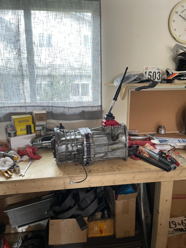

    I’ve been keeping parts from my 1985 truck and a few parts trucks for a new build for about 10 years now, while I went to school, got a red seal, bought a house etc.

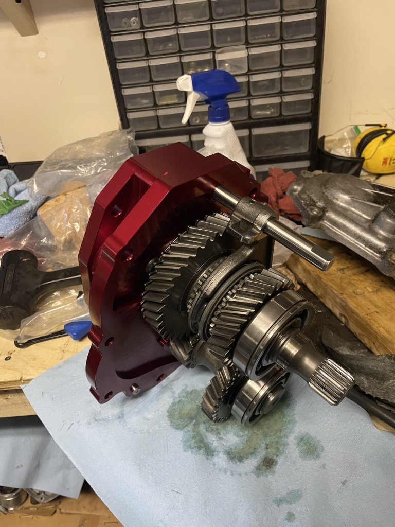

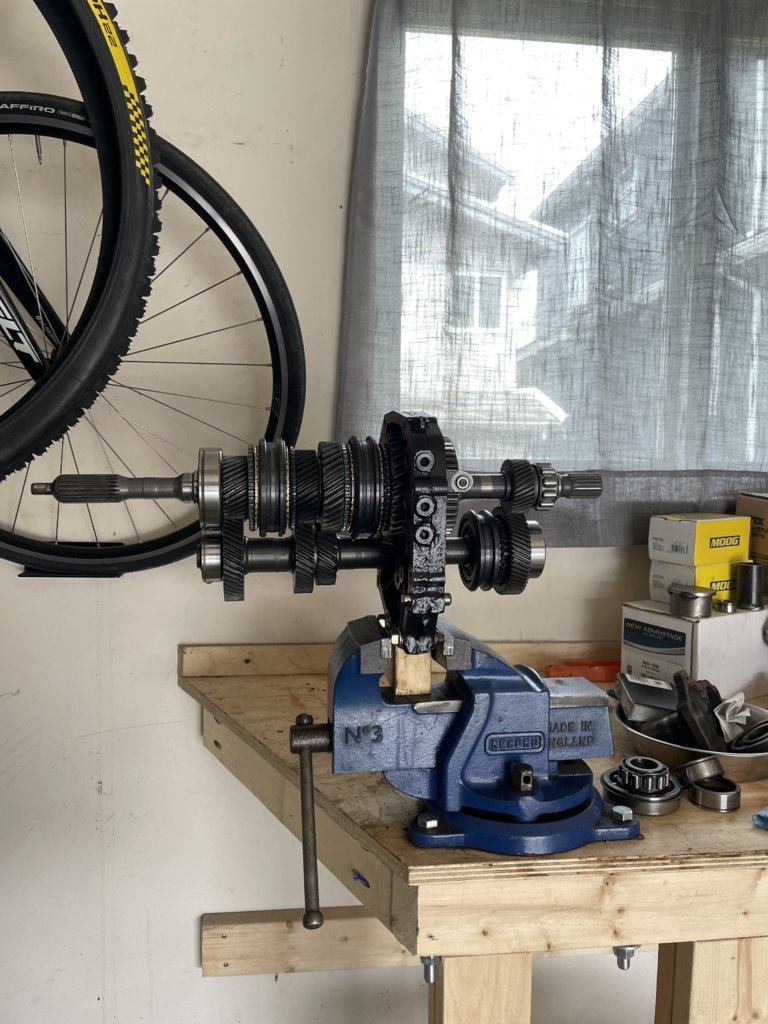

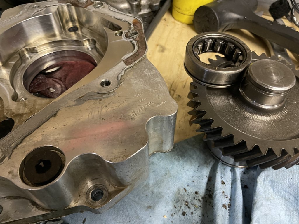

    My 1985 had an r151 which I regrettably sold. But I still had a spare low mileage W56B. Unfortunately the transfercase and transmission bolts were so corroded it ruined the rear case of the transmission when splitting them. So I rebuild it anyways.IMG_5007.jpg IMG_5130.jpg
    Running the R151F in my 1985 allowed me to run a 23 spline 4.7 single case. At the time I ordered the gears Marlin was out of the standard gears so I got the competition 4.7’s on sale. Sweet.
    After my 85 I used its case along with a Trail-Gear Verso kit to flip the case and bolt it in my 1996 4runner. Using the case I kept from my 85 and the spare one on the w56 gave me everything I needed for duals.
    onto the teardown…

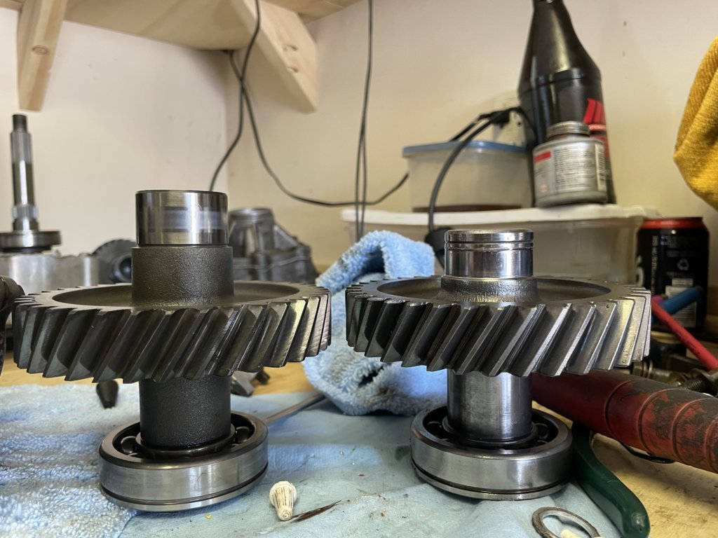

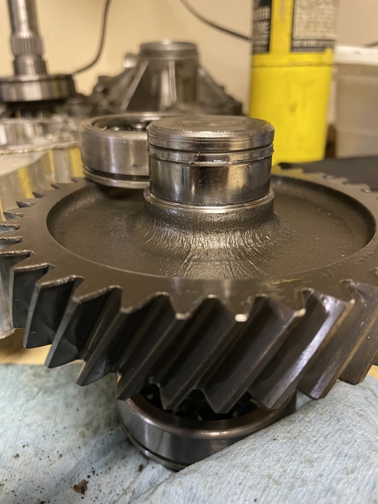

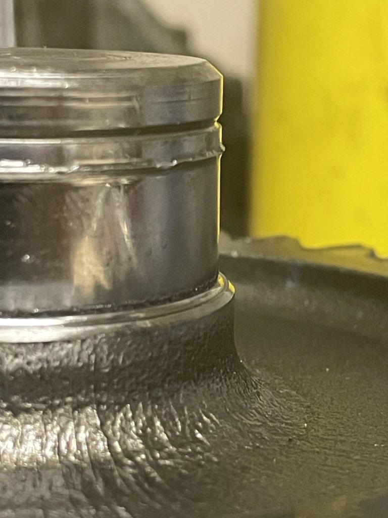

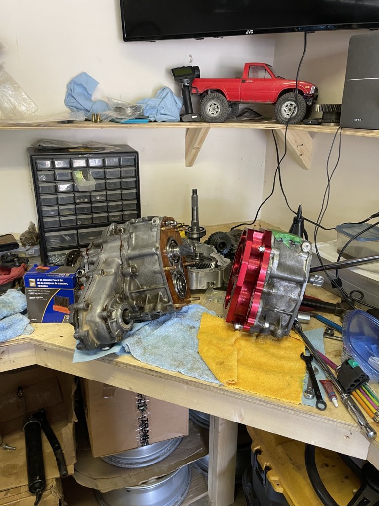

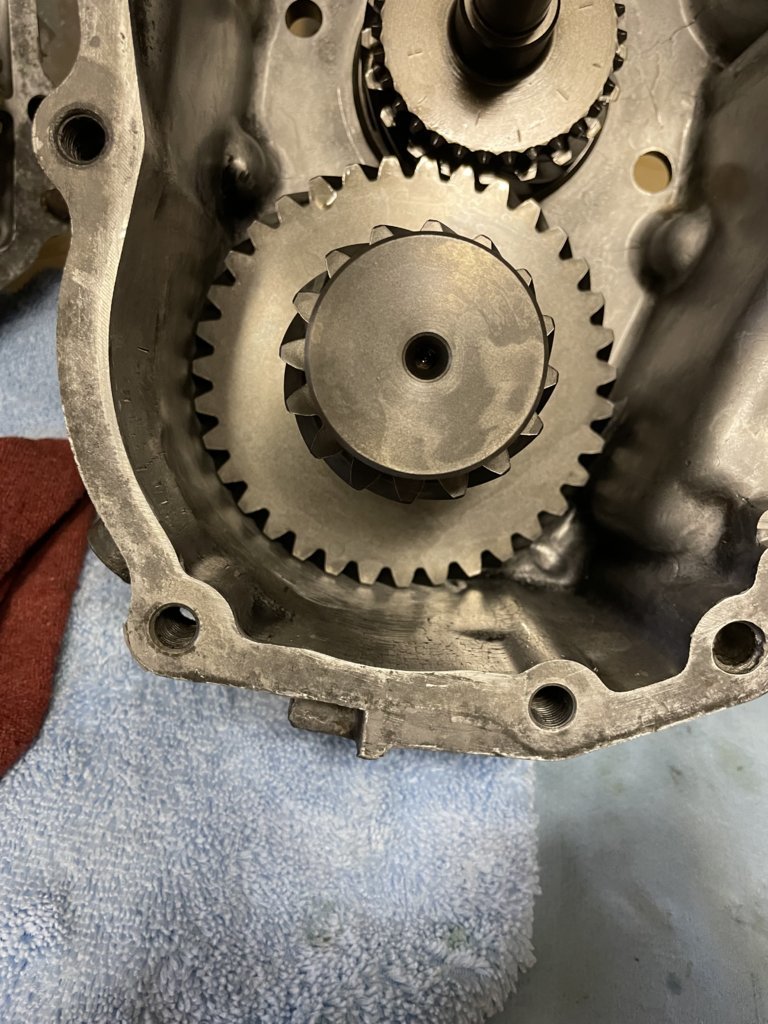

    Unfortunately I found an issue I had suspected. I while back I read on the forums that Trail-gear modified one of the stock gears for the verso without and heat treat after machining. I’m no expert but I believe these gears are case hardens so once you machine them past the hardened layer your back to regular steel. Here’s a picture of that issue. My case had probably 15000 miles on it.
    I don’t need these parts but it makes the Verso kit a paperweight.

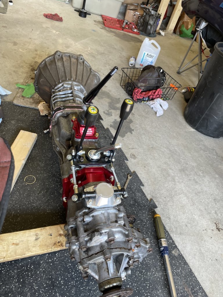

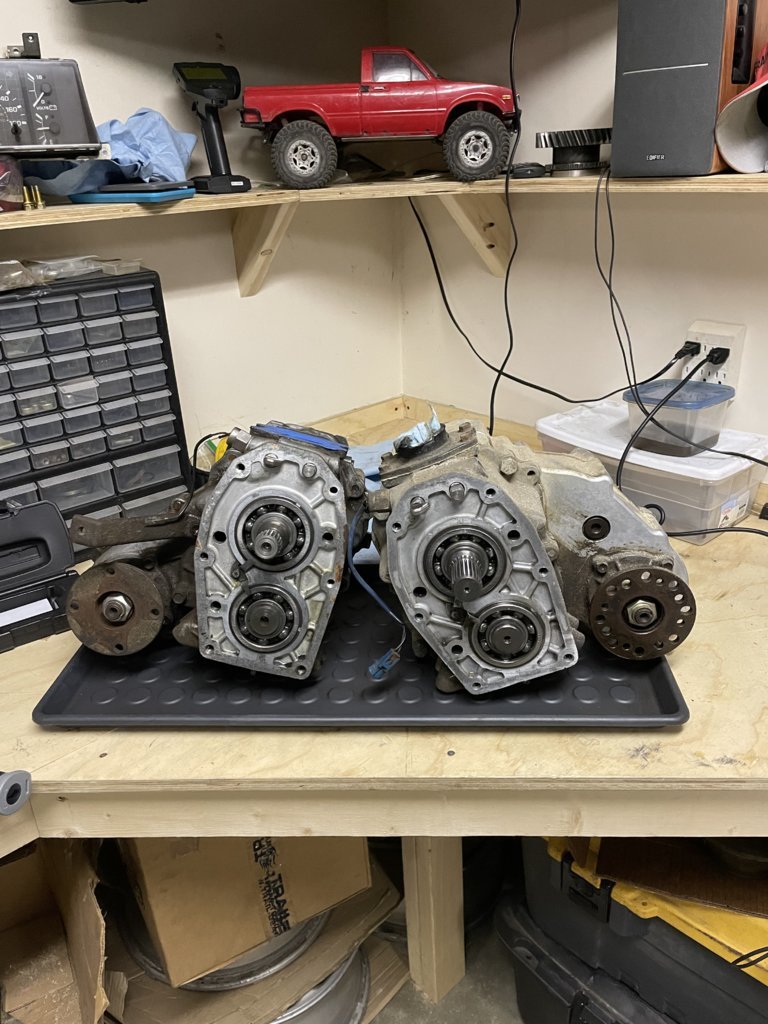

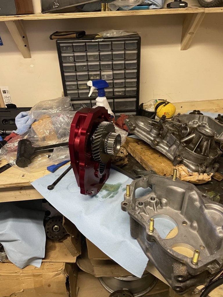

    Here’s the rest of the cases going together. The Triple shifter will need some work as none of the shifters are in quite the right spot. Everything is steel so easily modified with a MIG welder and a grinder.

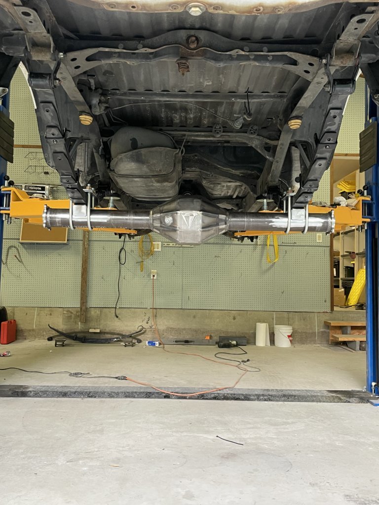

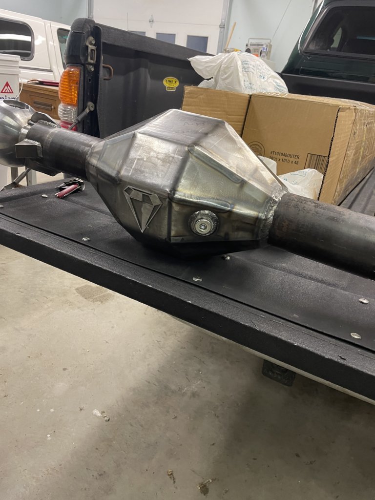

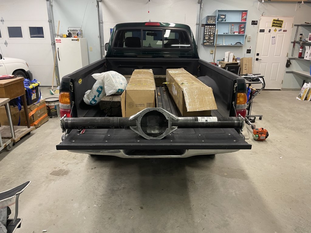

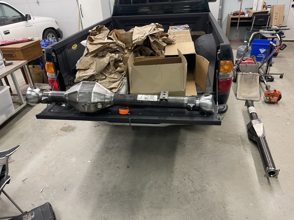

    Axles.
    I’m a Toyota nerd through and through and for as long as I’ve had a Toyota truck I’ve wanted Diamond axles for it. There’s a pretty good chance if you have custom axles I’ve sent you a PM or message on Instagram quizzing you about your axle width, wheel offset, what you like about it etc.
    My goal was to be just wide enough to maximizing the steering of a Toyota axle, reduce the scrub from spacing out a stock housing and still be as narrow as I can so it looks okay on the street.
    I had a pile of mini truck spares and originally the plan was to run IFS hubs front, full float rear with 4runner disc brakes and internal drum Ebrake. I initially contacted Brian at Front Range Off-road and things were looking good. We sent a few emails back and forth and then silence. I couldn’t get a response even when I request a total and that I would like to place an order. In a desperate attempt to get in the queue for housings as I already knew they would take a while I placed an order on the website and sent an email regarding the remaining parts. I followed up every few weeks but I received no response for about 6 months. Then I received a simple reply that they would get to me soon. Sometime last fall I learned that someone had recently received a housing that they had ordered 2 months prior. I was upset, and sent an angry email. I received a phone call from Brian the next day and we hashed out the final details.
    Sometime in the middle of all of this a FJ80 Elocker axle popped up for sale and I purchased it knowing the width would be close to what I need and it would have no custom parts that may be hard to track down.
    I specd the front housing to suit the fj80 shafts and outers. Bigger birfs, trunion bearings and knuckle balls are all a bonus of going to an 80 series axle. Not well known is that they have a higher KPI (13° vs 9.5°) and therefore a much better scrub than a mini truck with IFS Hubs. I determined that with the wheel offset to create the width I wanted I would have the same scrub radius as a stock FJ80.
    For the rear, Brian seemed unsure about the rear full float stuff being available. Not wanting to wait any longer and fearing custom parts may be hard to replace in the future I switched to a standard semi-float with drums. The housings themselves provide so much support that the durability of the components in them goes up. I’ve never broken a stock rear shaft so I am not too worried about this. However it is known Tacoma axle shafts can bend at the wheel mount surface so either 4runner or chromoly aftermarket shafts will be swapped in.
    After all that, they still took another 2.5 months to get. Really sucks to go through such an ordeal but over the last year I’ve had a lot going on between changing jobs, buying a my first home and moving 400km. I didn’t have the time to work on the truck too much anyways.
    Here they are.

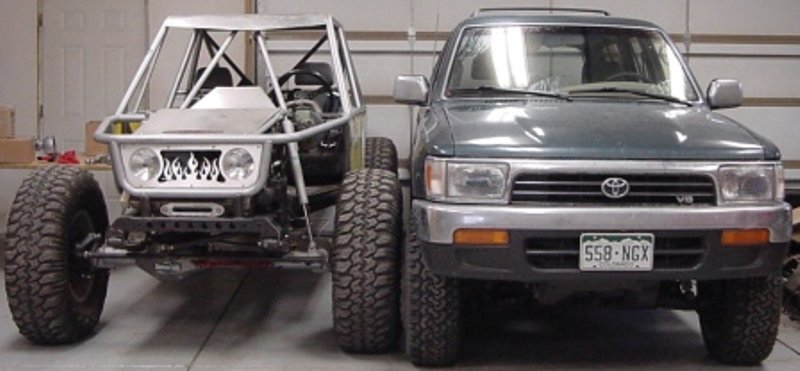

    Some Inspirational photos. IMG_3404.jpg IMG_1462.jpg IMG_1461.jpg IMG_6378.jpg IMG_6130.jpg IMG_3204.jpg IMG_3388.png IMG_6510.pngIMG_6509.jpg

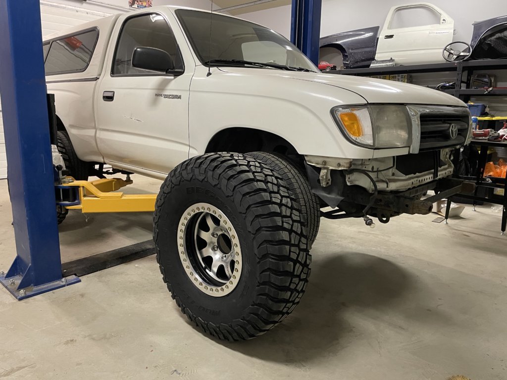

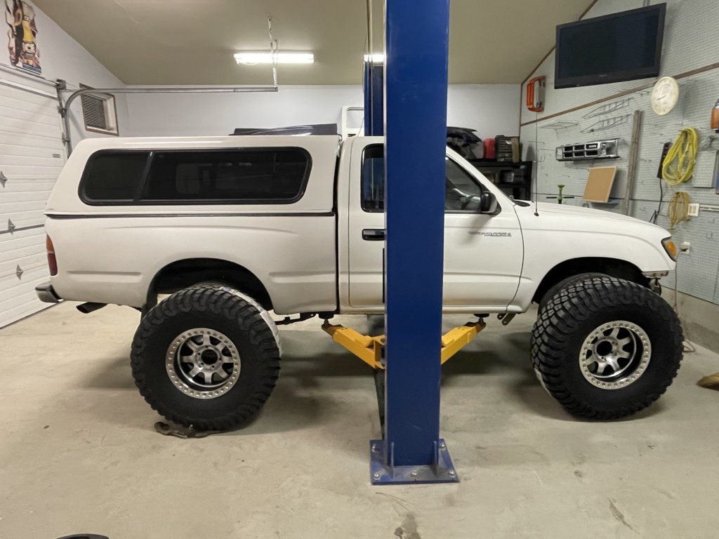

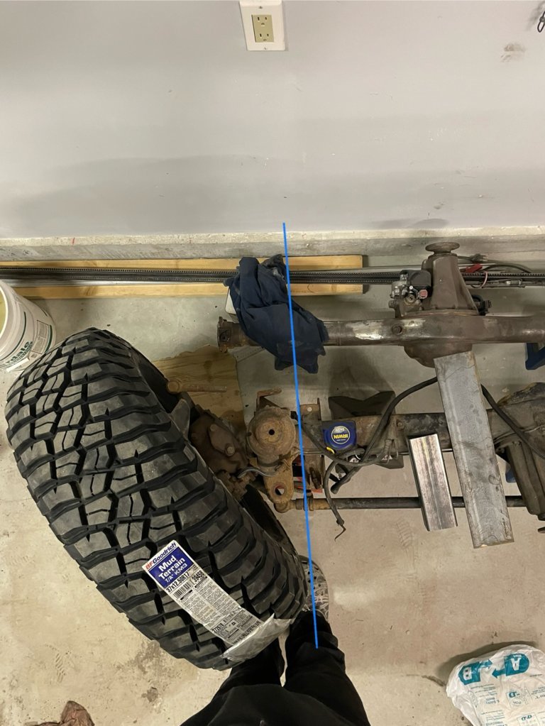

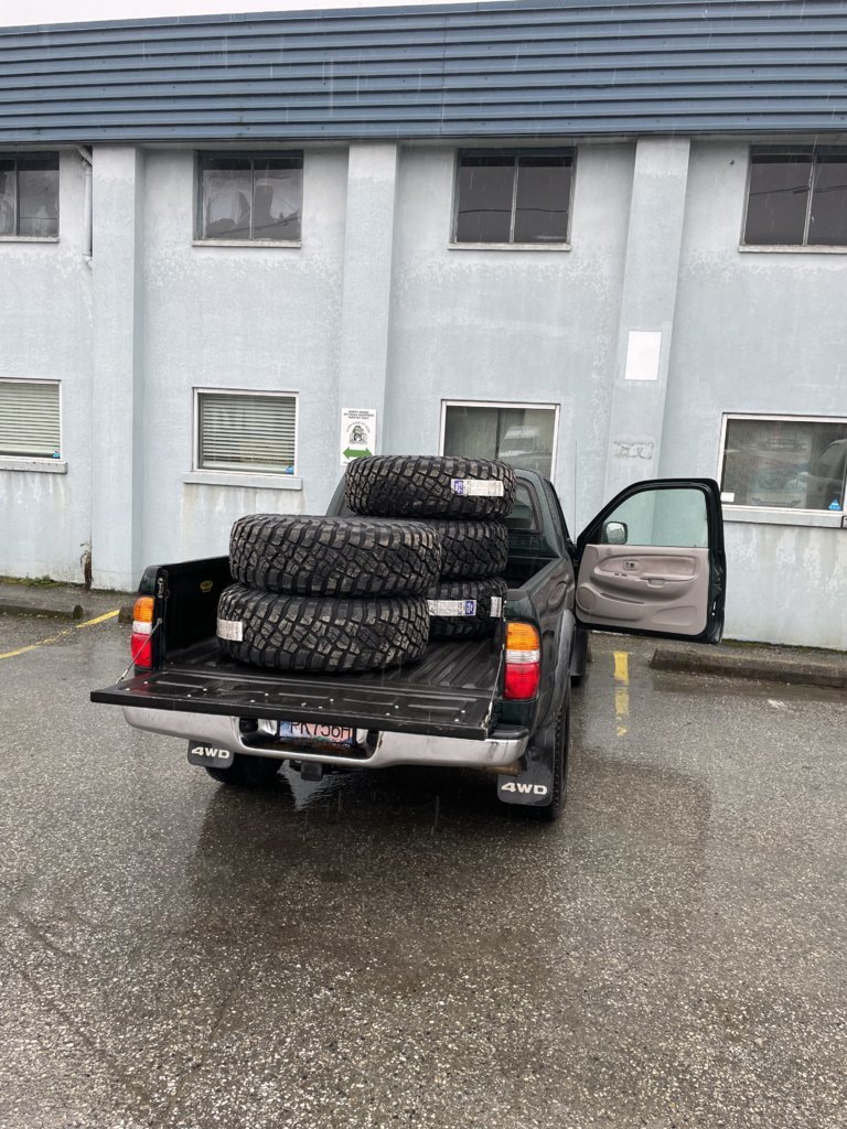

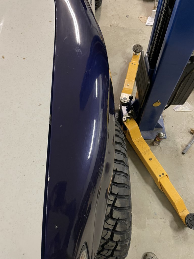

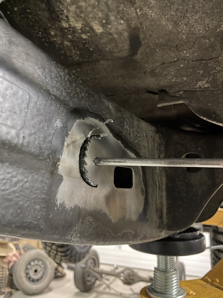

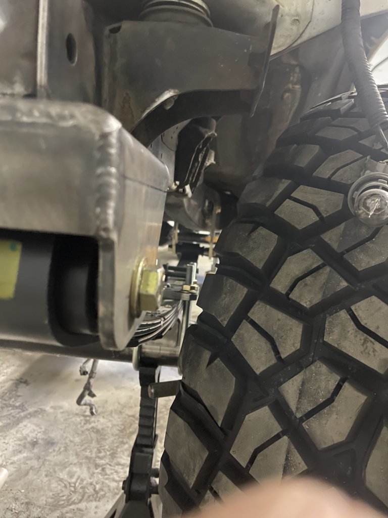

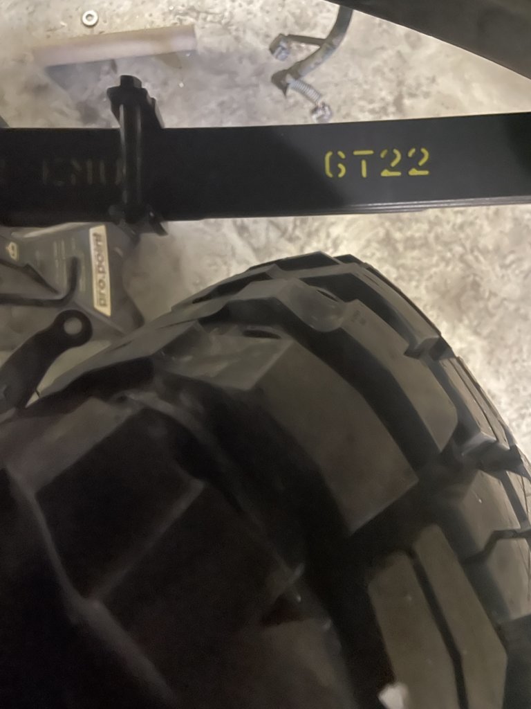

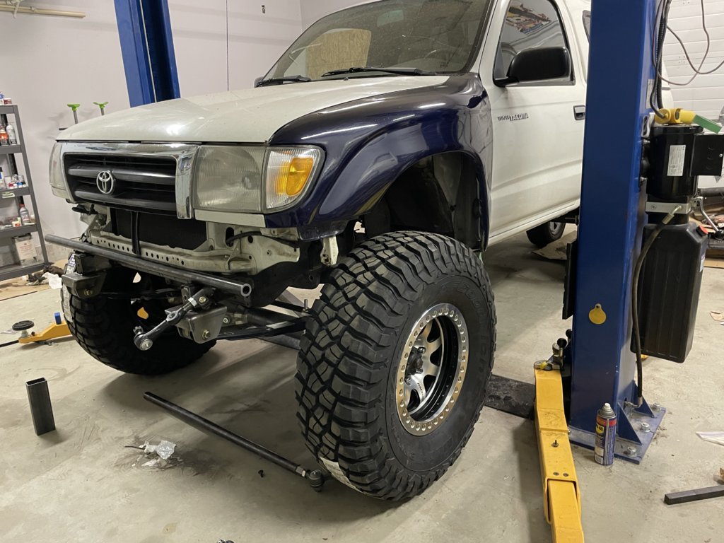

    I’m at a point now where I’ll be making more steady progress so it’s time for an update.

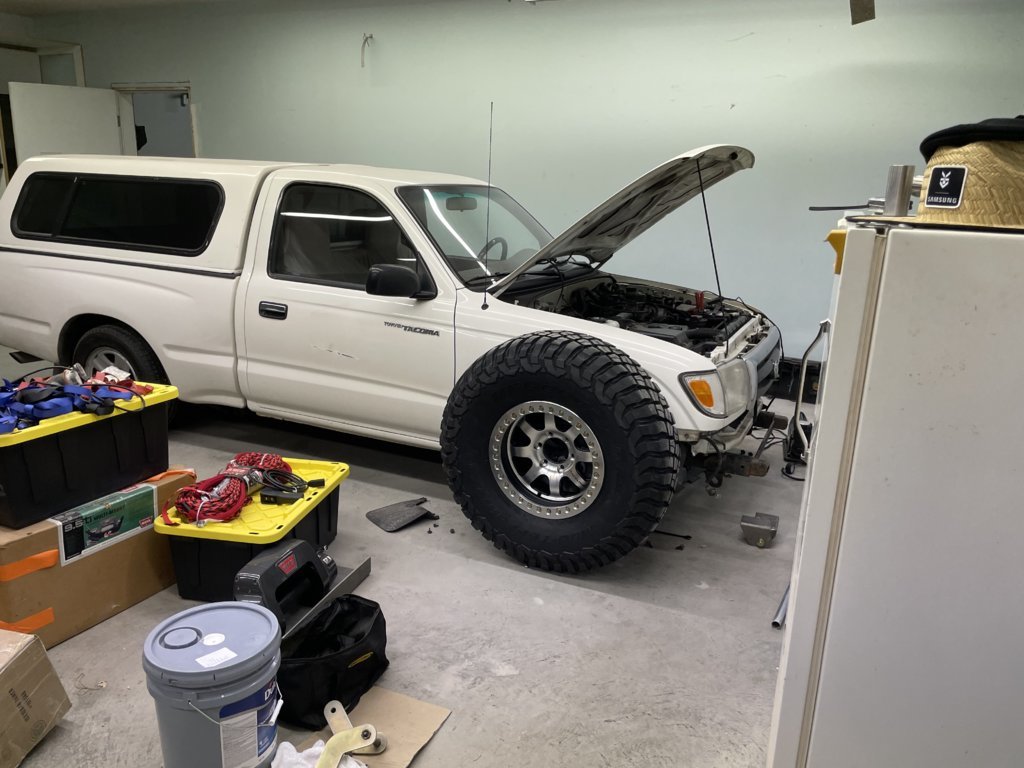

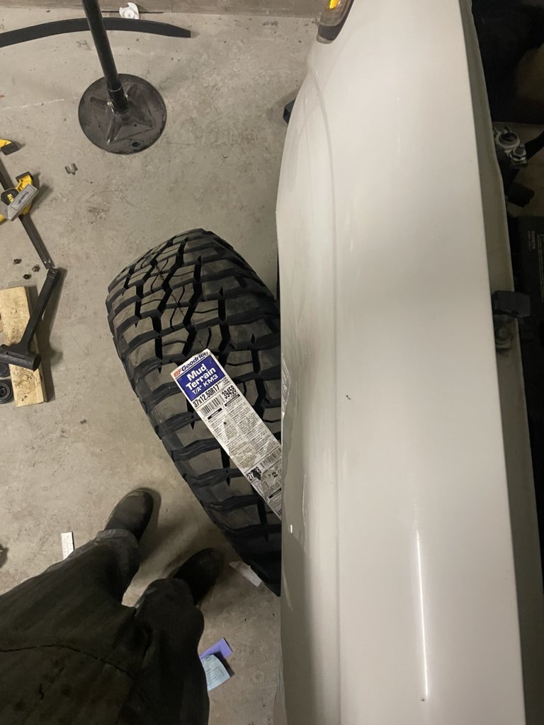

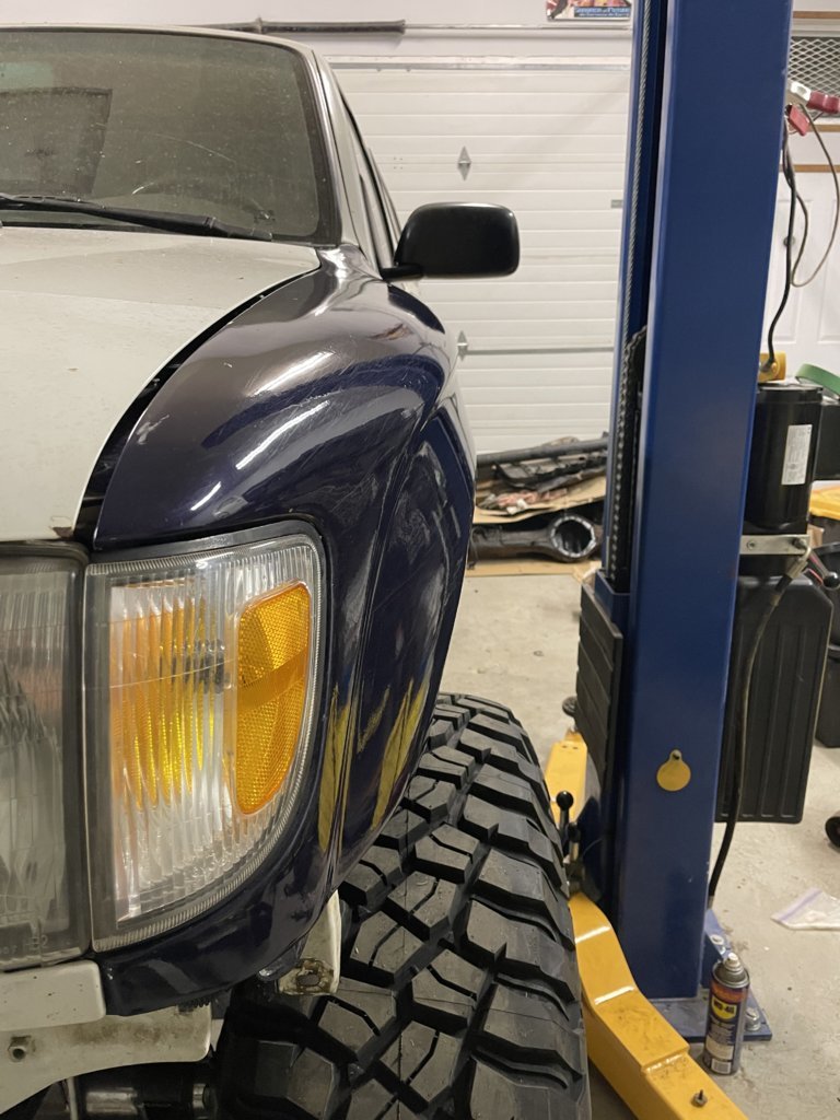

    Picked up wheels and tires.

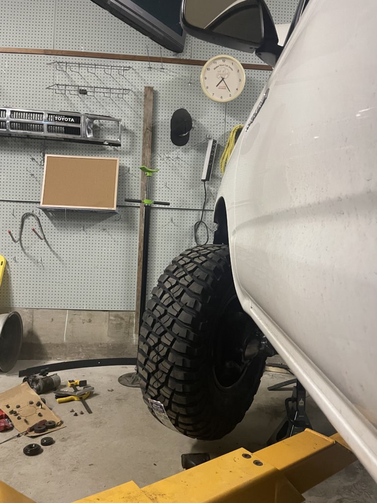

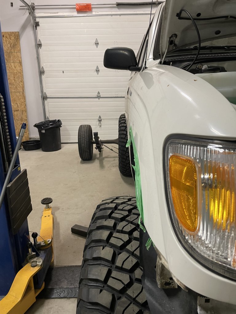

    The wheels are 17x8.5 -19mm offset. This works out to about stock scrub radius on an 80 series axle.
    I went with 37” KM3’s. I like the look and the narrow tread width. I’ve had good luck with BFG’s in the past despite others experiences so I decided to go with them again.

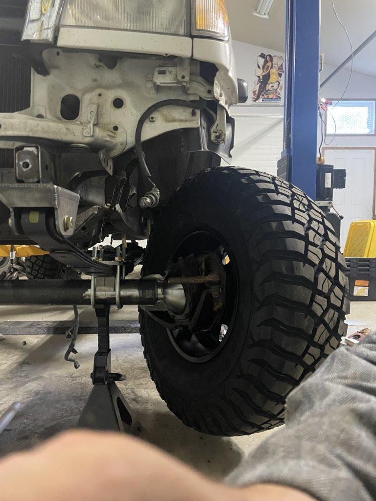

    Mocked up on a stock 80 series housing. The knuckles turn 35° give or take when the wipers start to smoosh. The blue line represents the outside edge of the leaf spring. The rounded profile of the KM3’s should really help maximize the steering angle.

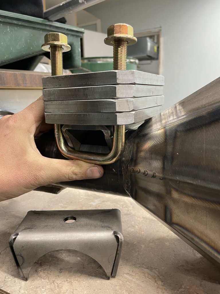

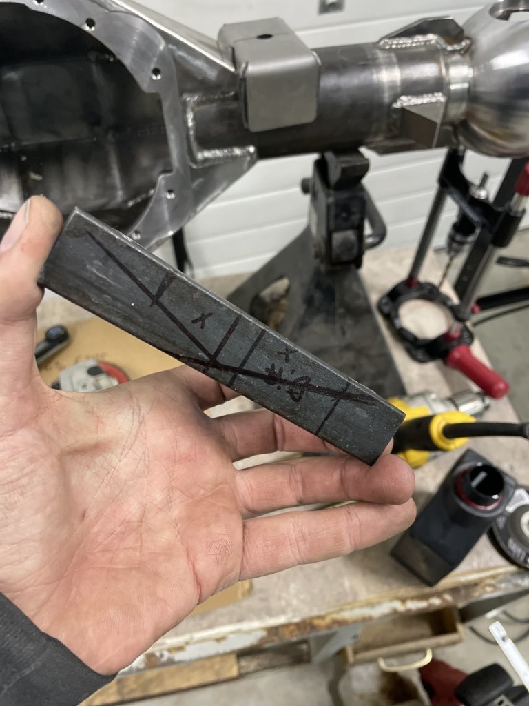

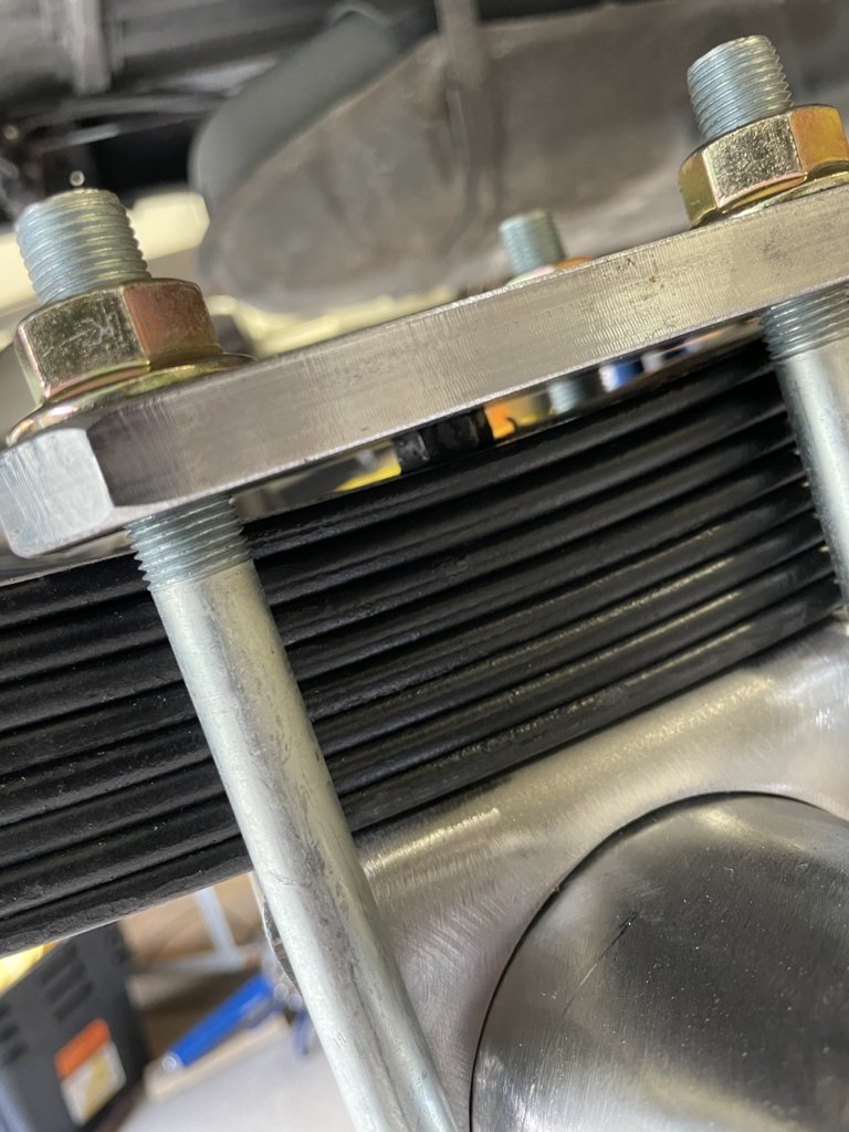

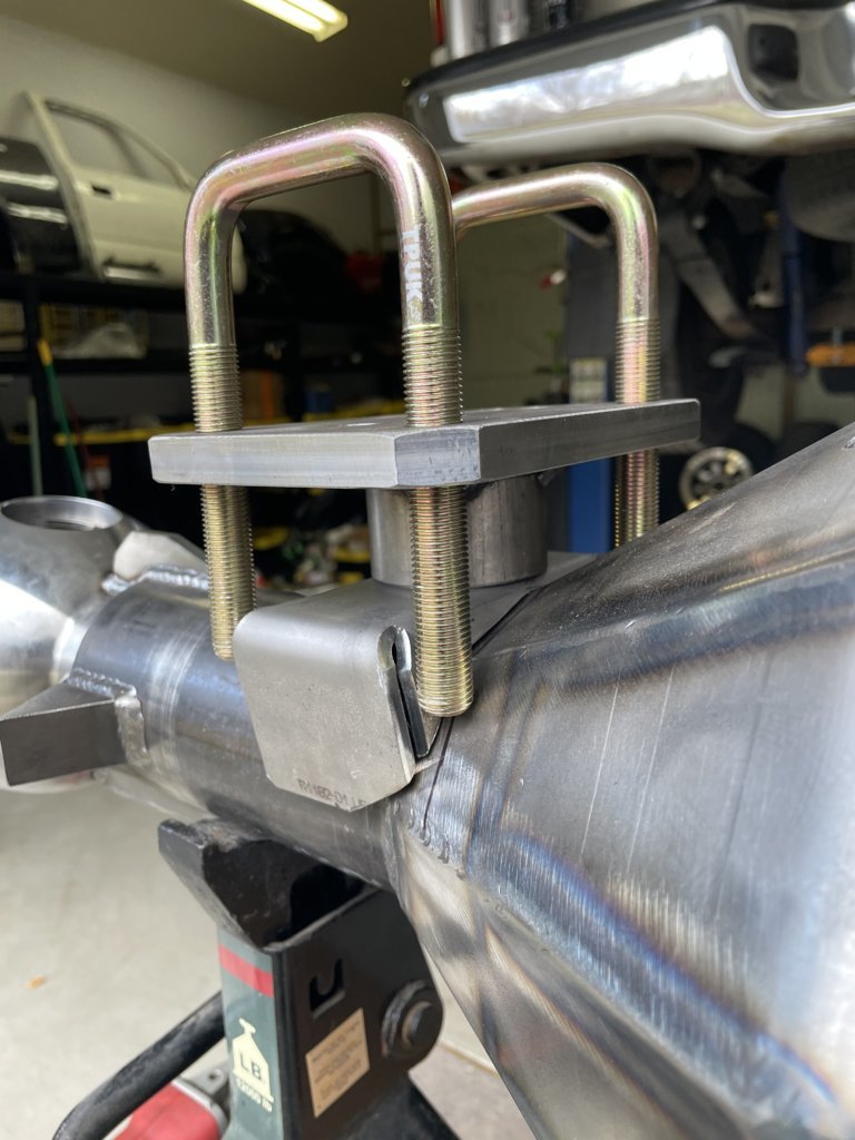

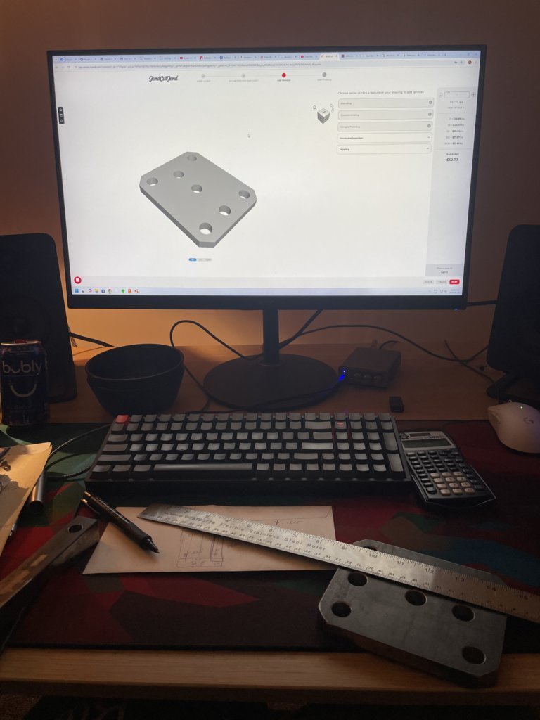

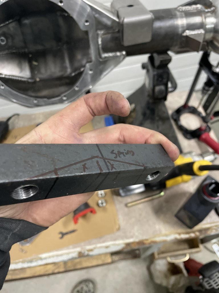

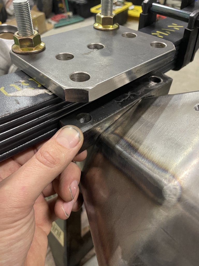

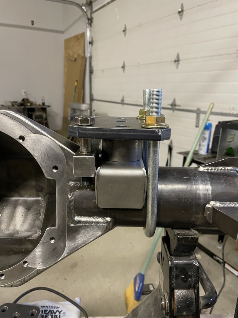

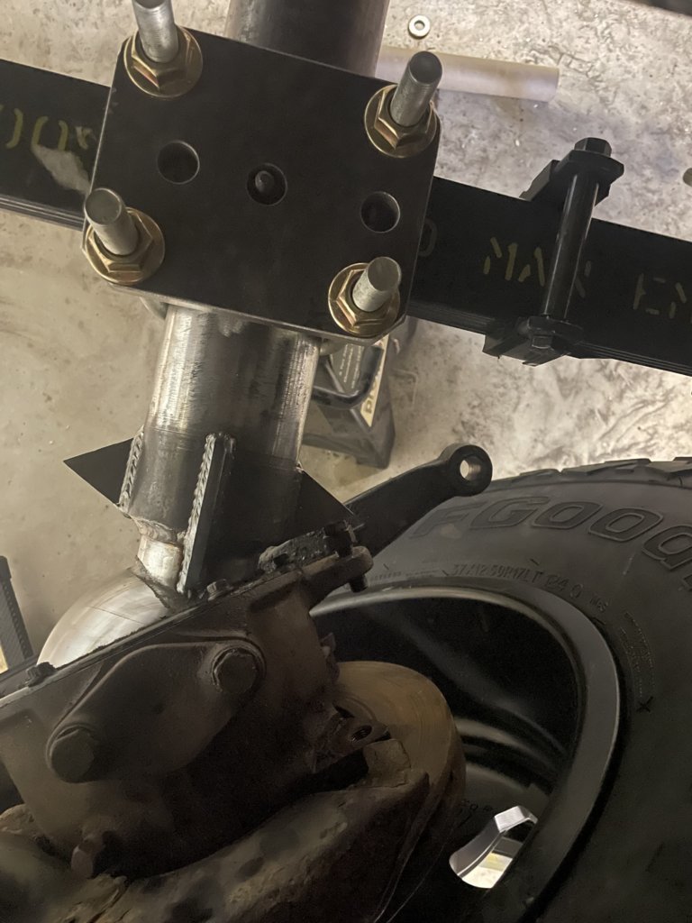

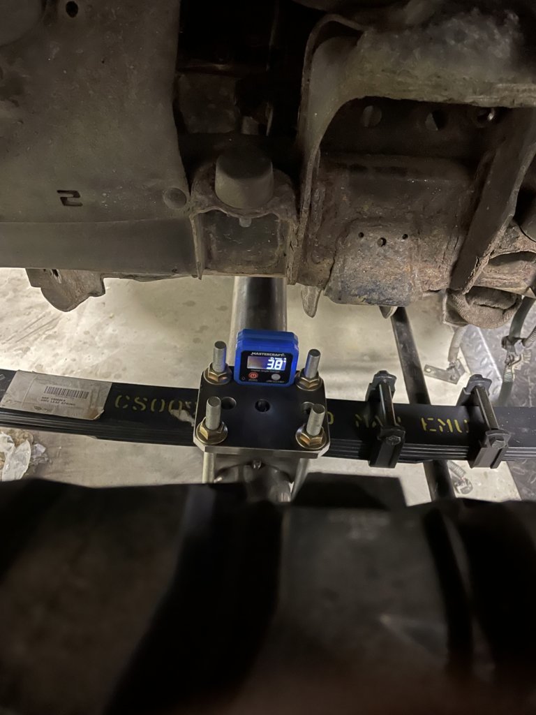

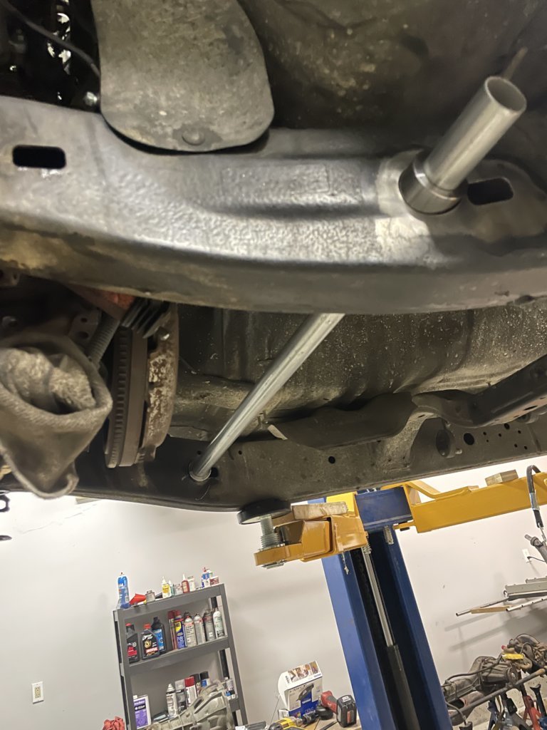

    Moving on from the wheels and tires I started on the passenger front spring perch. It’s a bit tricky to come up with a leaf spring mounting solution since it rides up the centre section.
    Originally I had planned to make these stubby u-bolts work with some kind of retaining device.
    After shaping the perch to fit the housing at the width I needed I realized I just didn’t have the room.

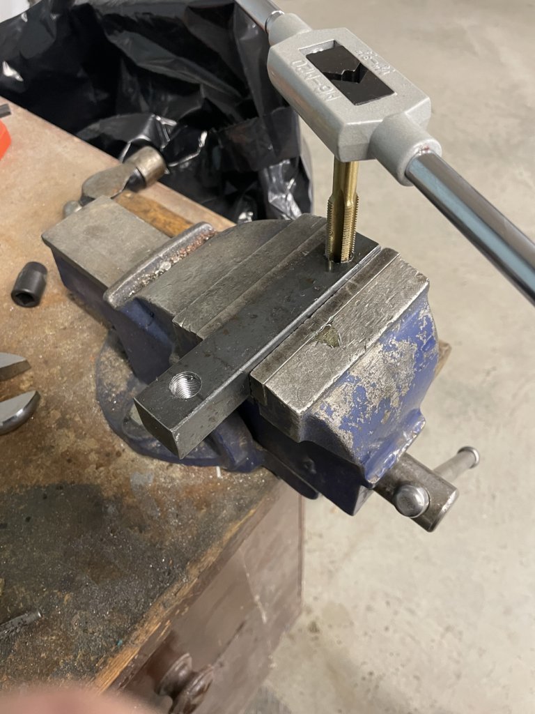

    Plan B…IMG_6629.jpg IMG_6630.jpg IMG_6631.jpg IMG_6656.jpg IMG_6669.jpg IMG_6673.jpg IMG_6729.jpg
    I drilled and tapped a chunk of 1” square stock, and contoured it to fit the housing as well. I went 1” over something 1/2” like the Ruffstuff u-bolt eliminators. I was concerned the mild steel threads would strip much easier than the hardware that threaded into it.
    Since this moved the mounting holes on this side over, I had to create a new “special” U-bolt plate with offset holes.

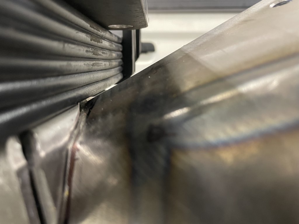

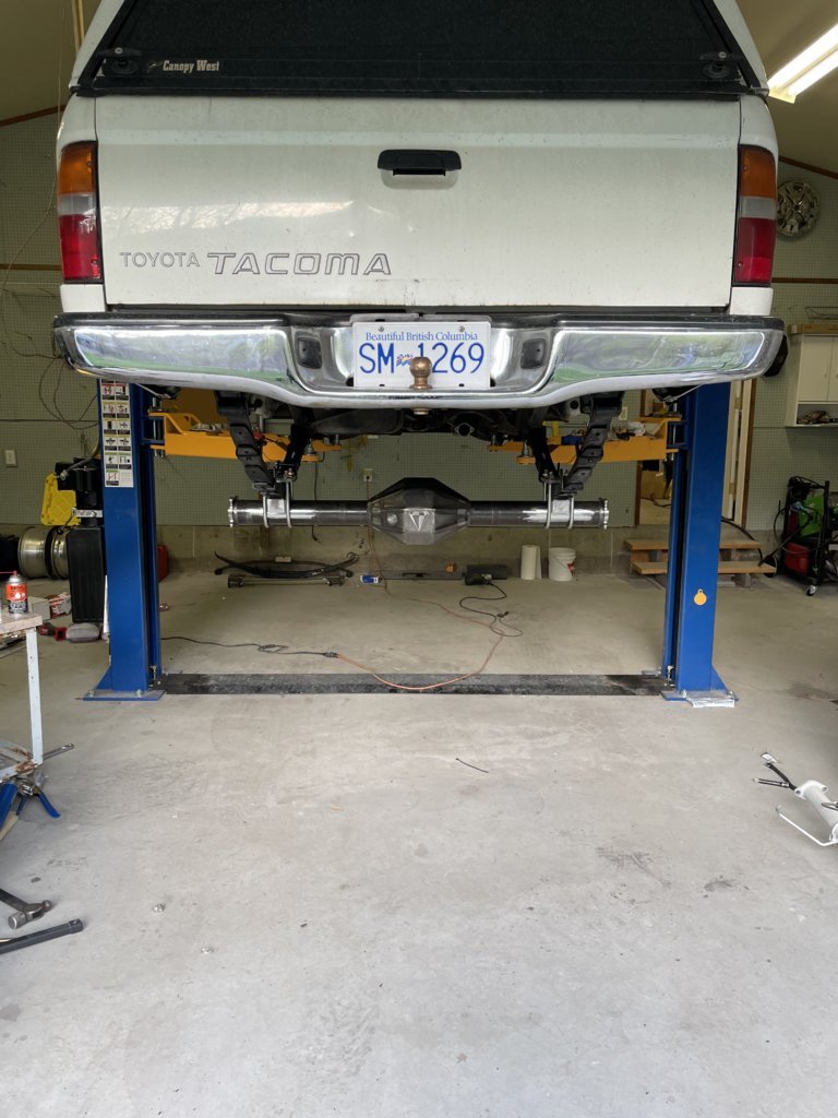

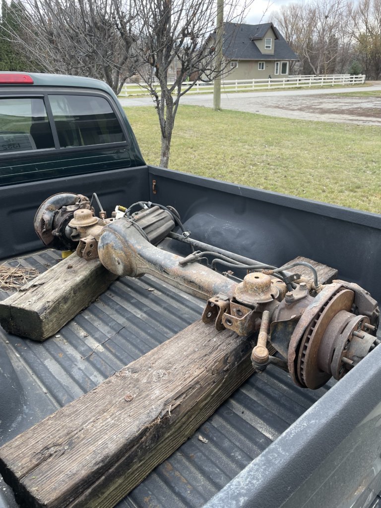

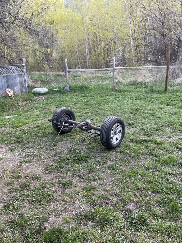

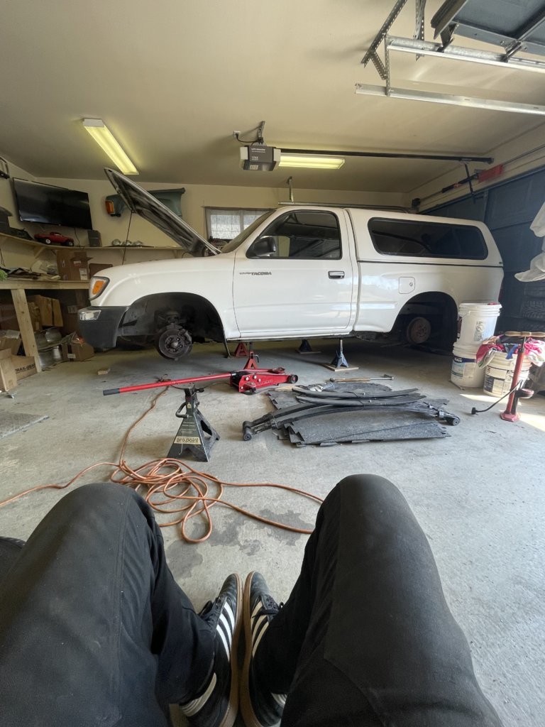

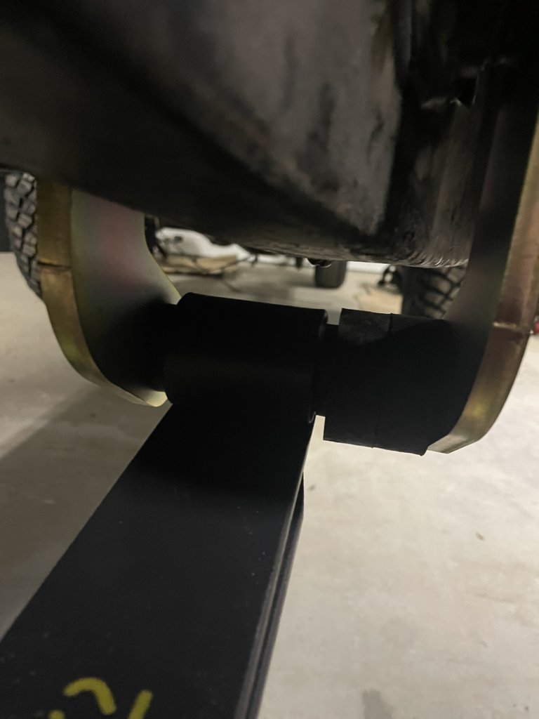

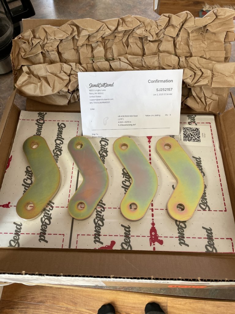

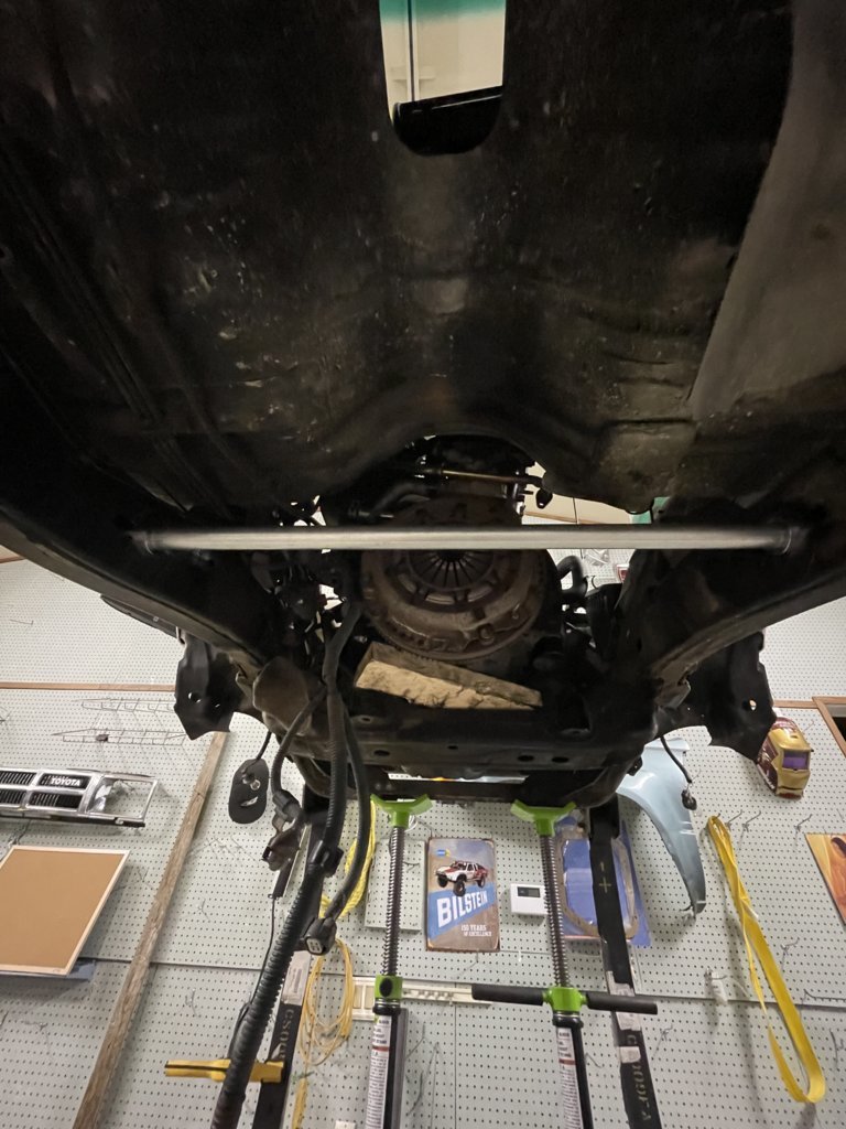

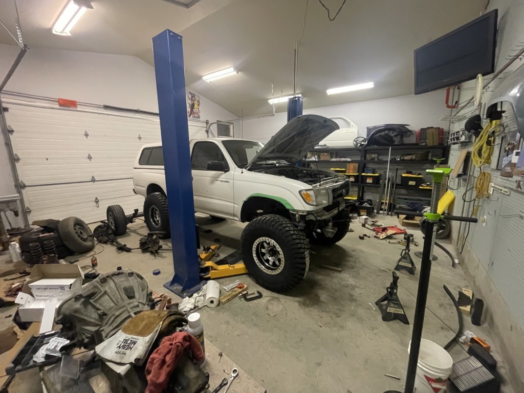

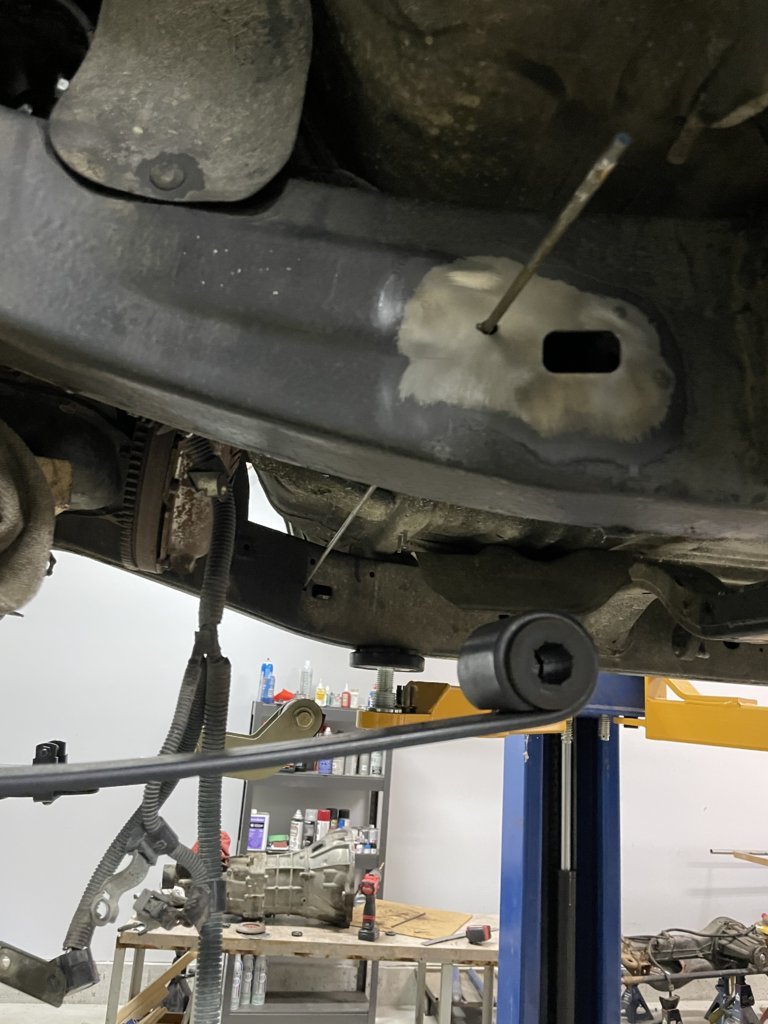

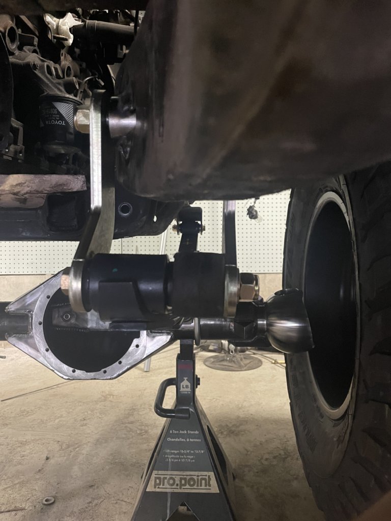

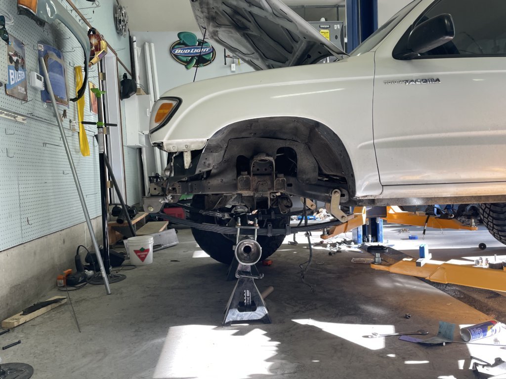

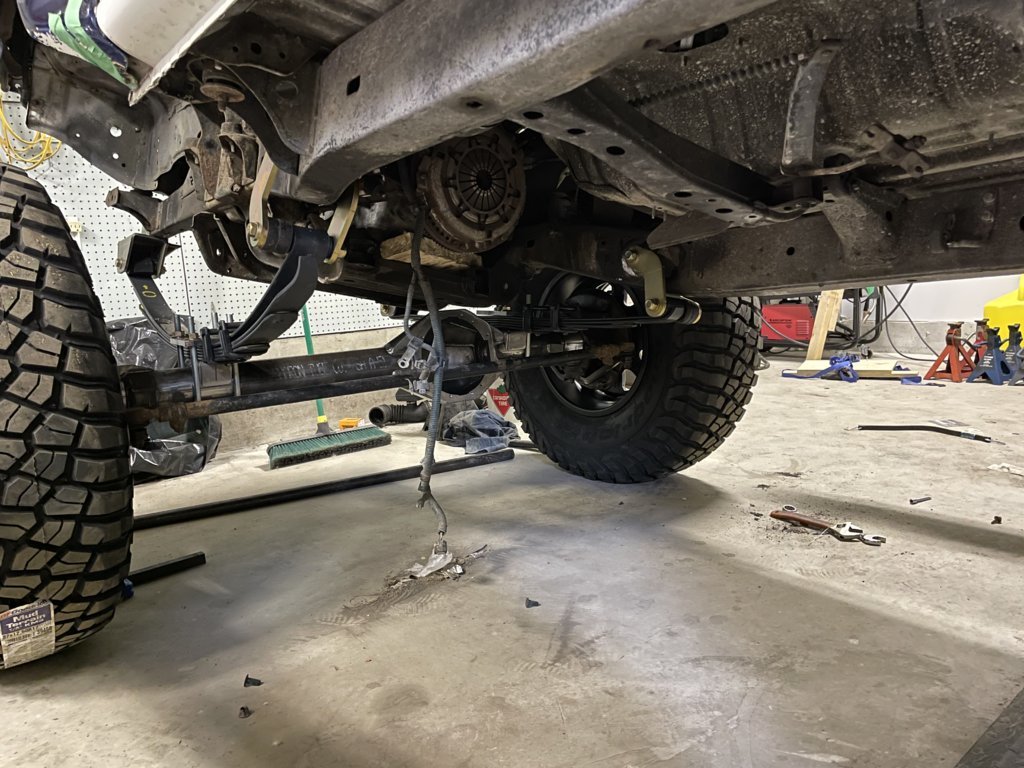

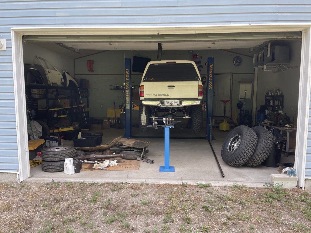

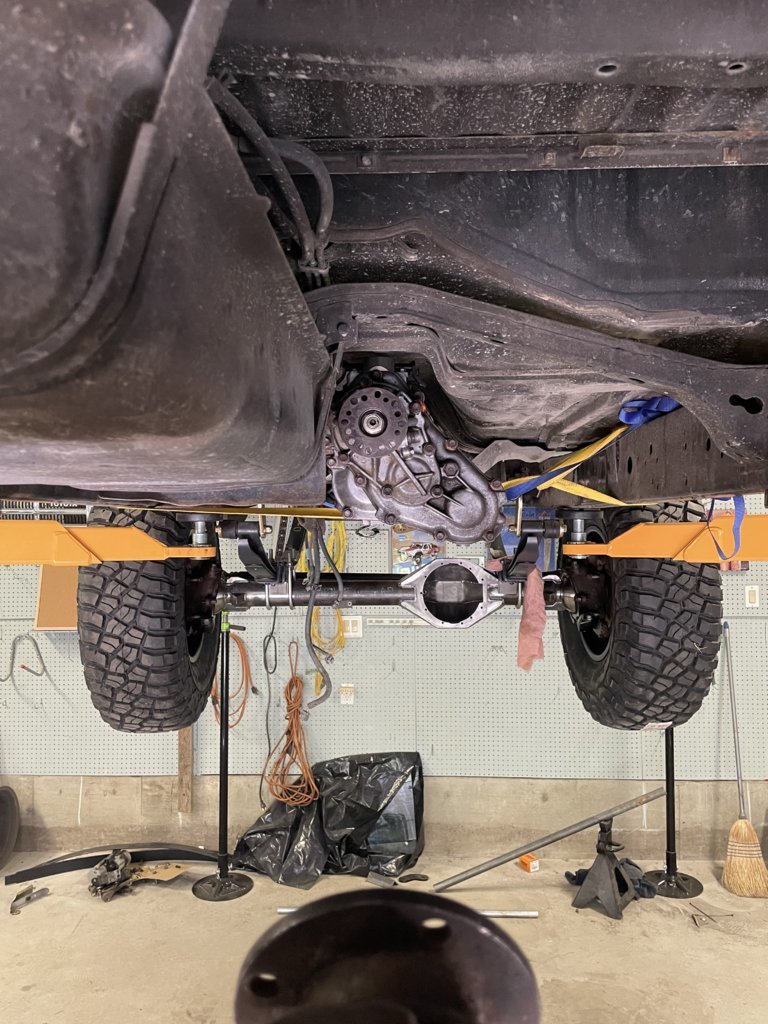

    Drove the truck around a little bit for the past couple weeks and then yeeted the rear axle out to get things under way. Mounted the 3” All-pro springs and rear housing.
    I have to cut the abs rings off my Tacoma axles for mock up and the centre pins don’t fit the u-bolt plates. :frusty:
    IMG_6696.jpg IMG_6715.jpg IMG_6762.jpg IMG_6780.jpg IMG_6781.jpg IMG_6782.jpg
