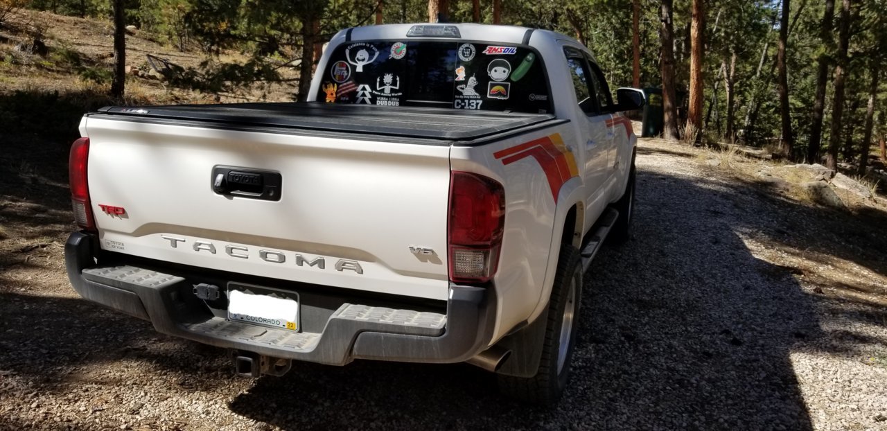

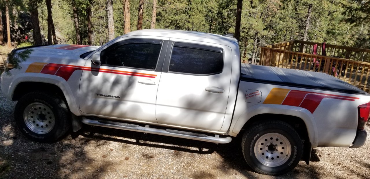

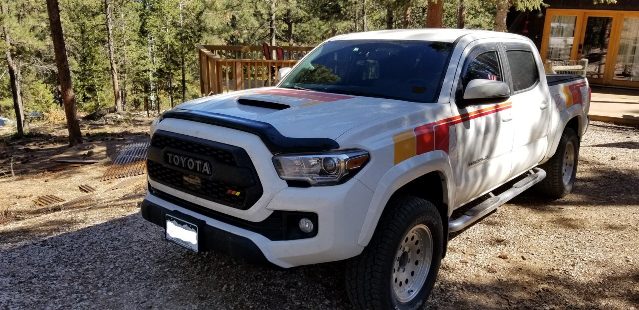

    Late to the post. But that is what I aim to accomplish with my 18'. I'll attach some phots including the closest match rims I could find to match some of the photos I could find. Not quite as detailed as some of the dealer trucks, but this cost me $200.00 total for the decals.

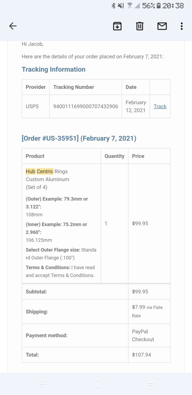

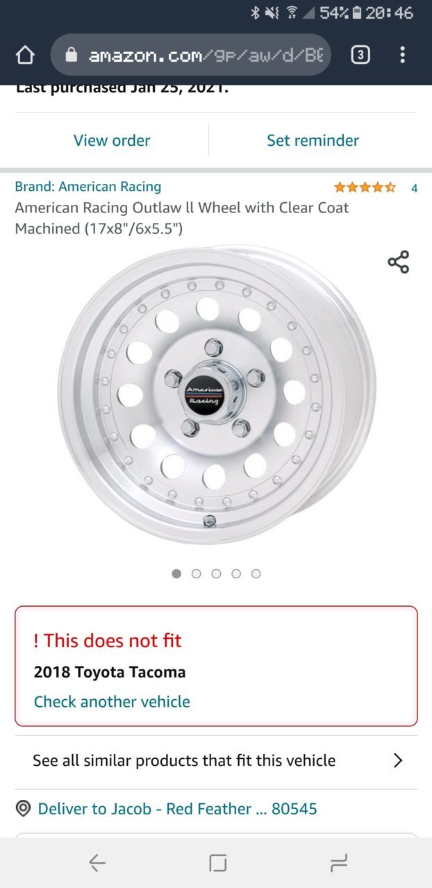

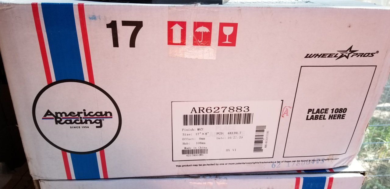

    American Racing's own website said these rims would not fit my '18. I belive it was because of the negative offset. On the second gens the hubs are more narrow and so the calipers would rub the inside of the rim. I have about 1/4" of space before that would happen. Totally stock btw. 6x1.39 I belive was the bolt pattern *[EDIT* I WAS WRONG IT IS 6X5.5"]* and I needed 108mm outer and 106.125mm inner hub centric rings for mine to fit. Along with new acorn lugs. I had my rings custom made out of aluminium because the plastic ones were shitty, and 106.125mm is not a standard size. And yes, I know 106mm would have worked just fine, but I did the math and it came out to 106.1254378mm and they let you go to the thousandths so I did. Partly OCD partly because it fits that much better. I went through US Wheel adapters. Great customer service and I got my order within 10 days.... pre corona freakout though. Roughly $100.00 for the set of 4 after tax. Haven't had any trouble with them, so worth the money to me. I'll post a picture of the ones I got. I went through Amazon because it saved me $60 a rim vs American Racing directly. Even Amazon said they won't fit. Mine did. Let me know if you need any more info. I can take pictures of wheel fitment too if you want before you pull the trigger. No gaurentee these fit your '21. The '18-'21 should be the same.... but who knows. *[SECCOND EDIT* THE CENTER CAPS FOR THE AMERICAN RACING RIMS DO NOT FIT, JUST FYI]*
