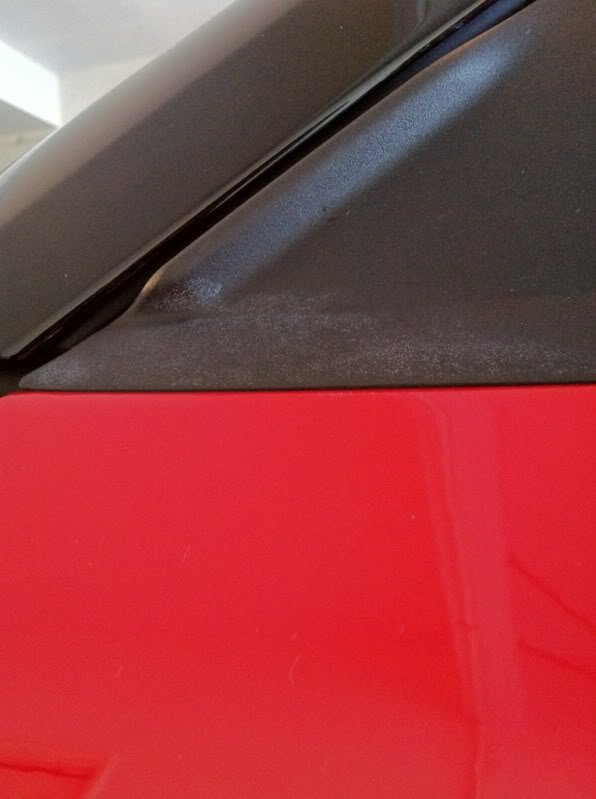

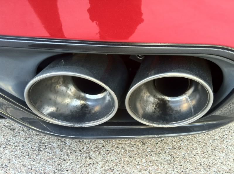

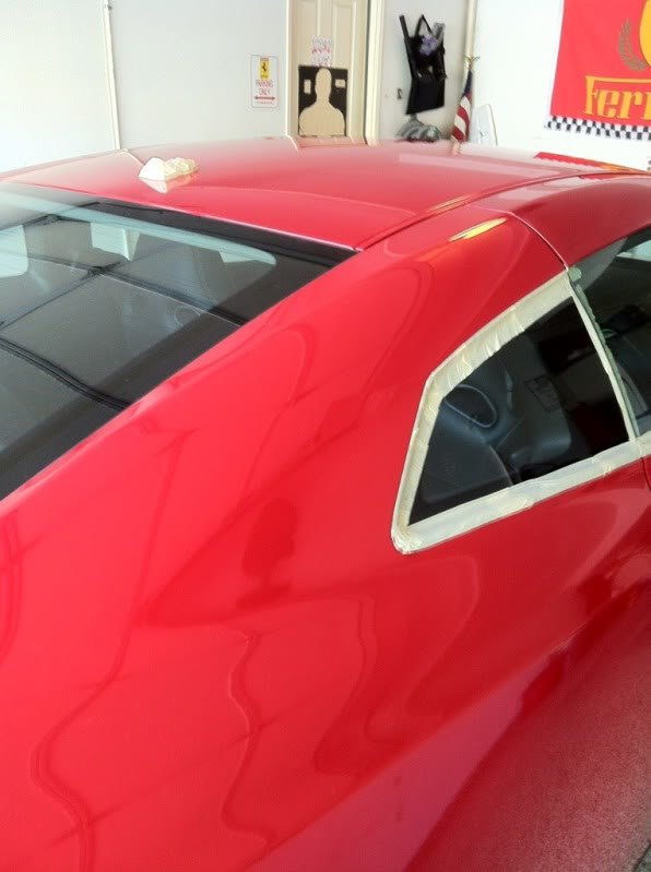

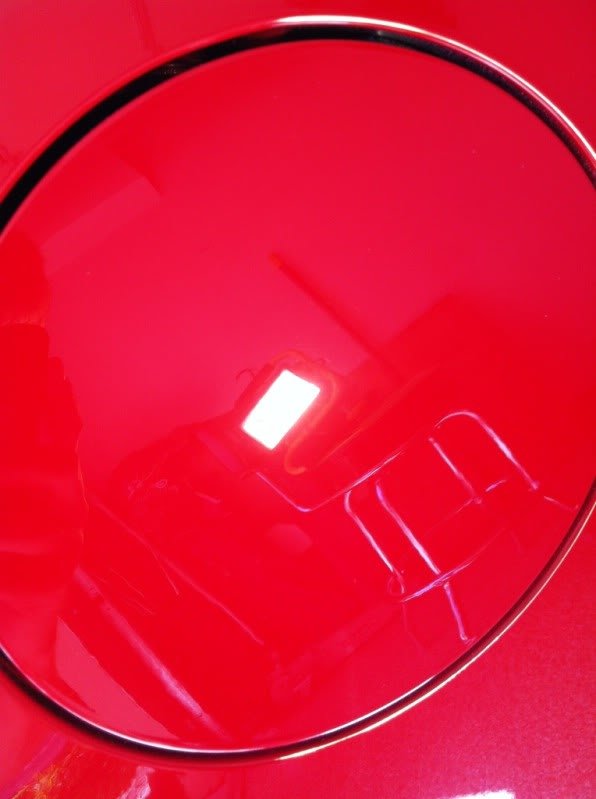

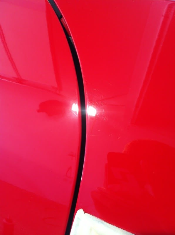

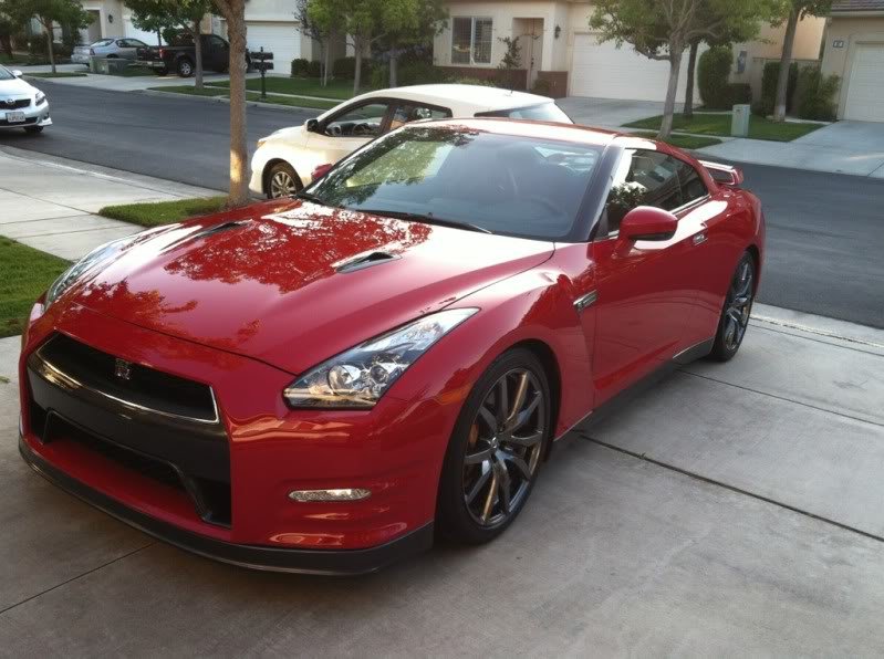

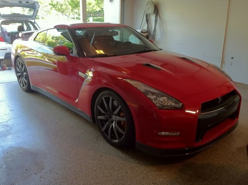

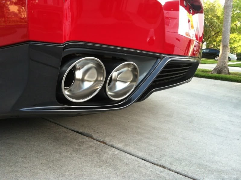

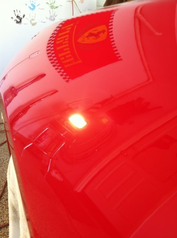

    Proccess used:
    waterless Wash
    IPA wipedown
    Clay
    2 steps of compound with meg's d300 and microfiber pads
    2 steps of polishing with menzerna sf4500 and black and white pads
    IPA wipedown
    Sealant with Blackfire Wet Diamond and blue sealant pad
    C/G paste wax
    The first thing I thought to myself was, how in the world could this thing get any cleaner?!?
    buuuut then I took a closer look
    love me some leftovers
    taped up ready for action
    pillar swirls
    testing out the flash on my phone
    split, before polishing
    thought this was cool
    split before polishing
    Afters
