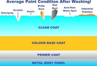

    First off, for previous disputes. When you remove swirls, depending on the clear coat you ARE removing clear, making it thinner. Think of it this way, you have a 1 foot by 1 foot by 1 inch deep box filled evenly with sand. Swipe your hand through the sand box while removing dirt (imitating a scratch/swirl) When you go to even out your sand box, it will be lower. Thus when you correct a scratch?swirl, you are heating the paint up, and pushing around clear coat into the scratch/swirl crevice, reducing the amount of clear coat.

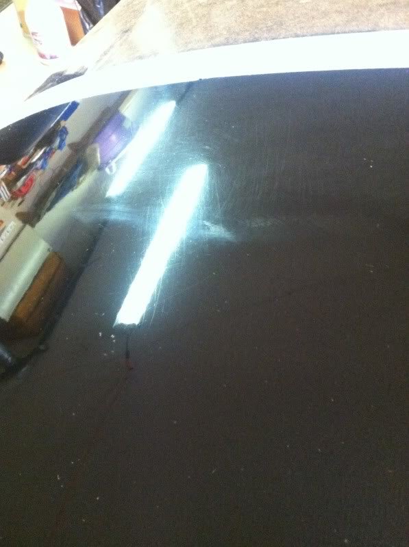

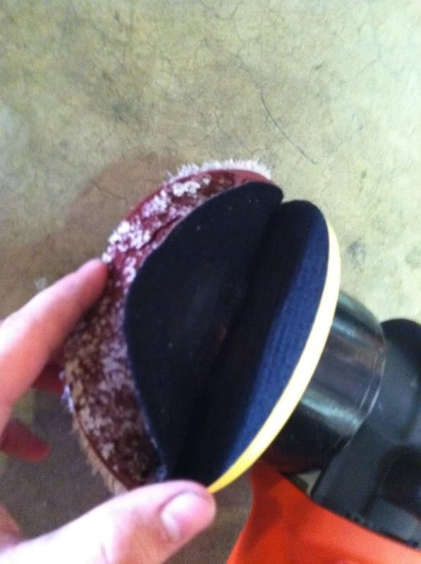

    **NOTE: Not all defects were removed for this writeup. Especially after the second half the only cutting pad I used started to deteriorate(velcro melted and came apart)

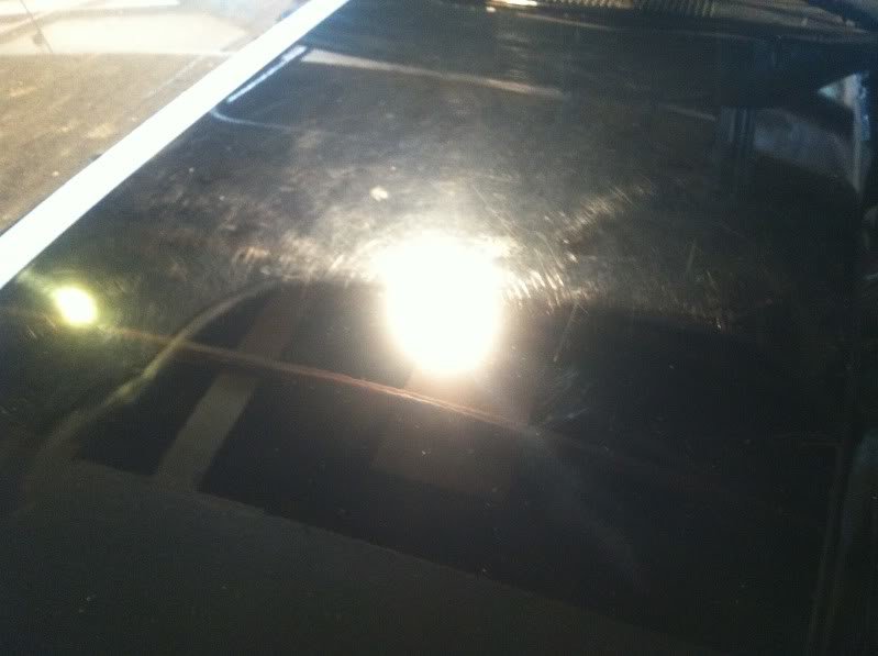

    The red line is what the clear coat is expected to be leveled to( givin the amount of damage to the clear)

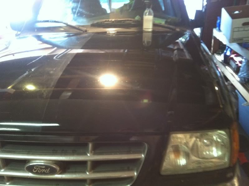

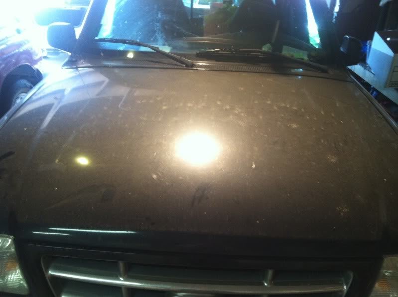

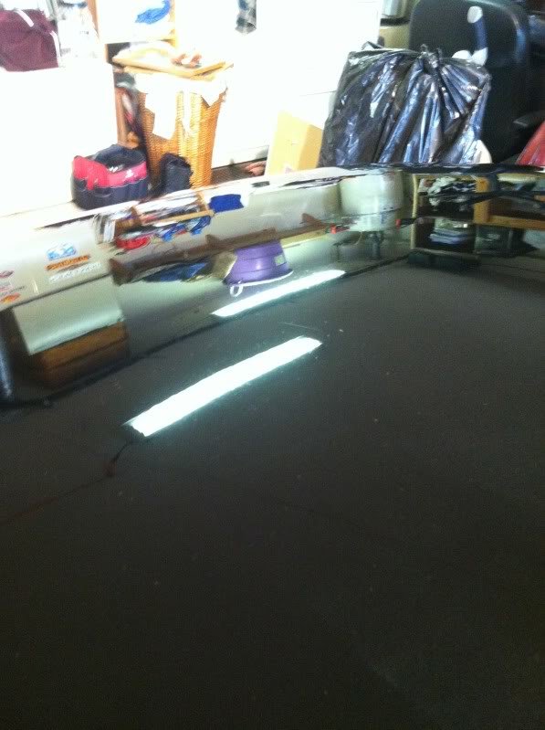

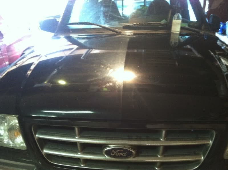

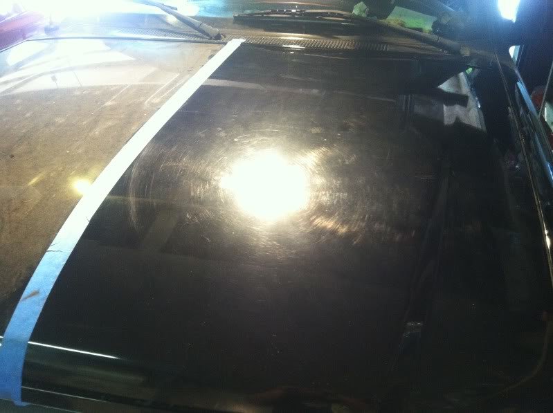

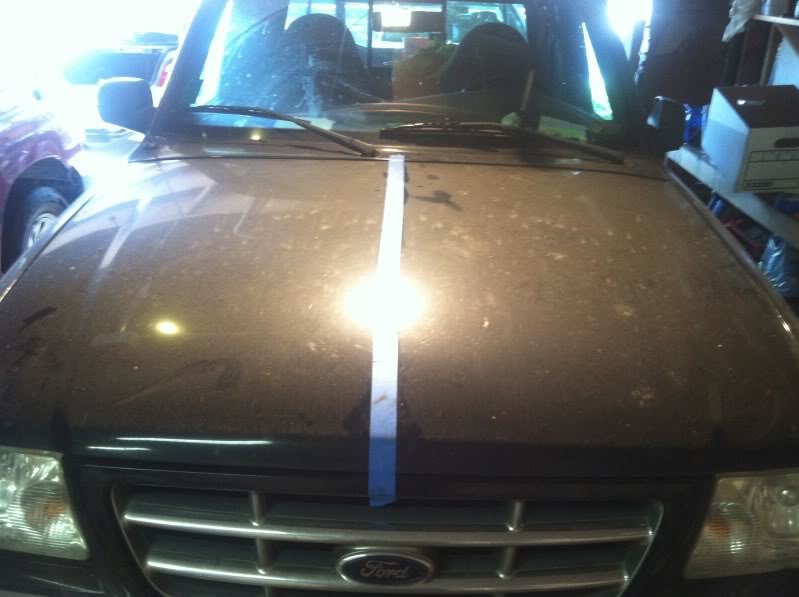

    Here is a ford ranger that hasn't seen wax in who knows how long, and i will do a step by step of the correction process.

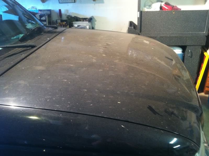

    After being washed and clay

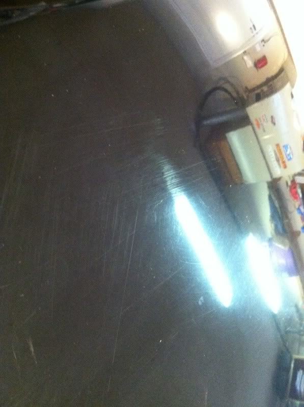

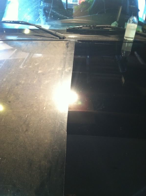

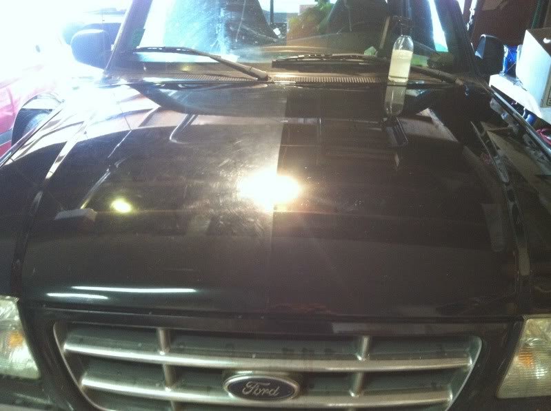

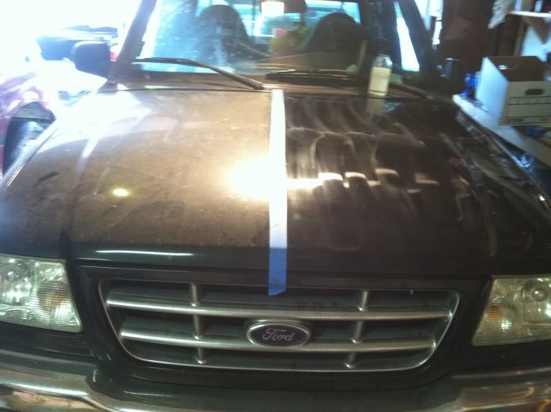

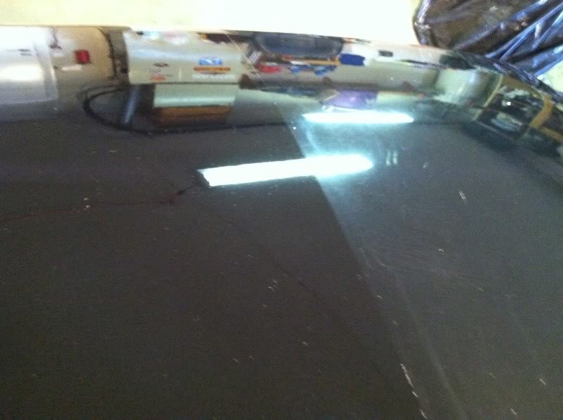

    after about 15 minutes with a compound

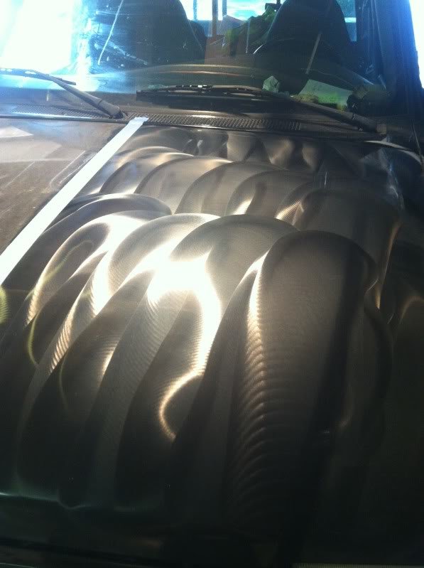

    after compound, before polish so there is haze

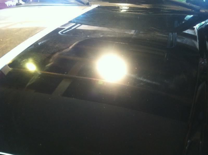

    the polish steps after compounding to remove hazing and possible holograms..
    forgot to take pictures between polish and sealant.
    after the polish I did the IPA wipedown to remove polish oils so the sealant and wax will bond to the paint.
    after sealant before wax

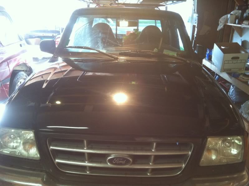

    letting the wax set

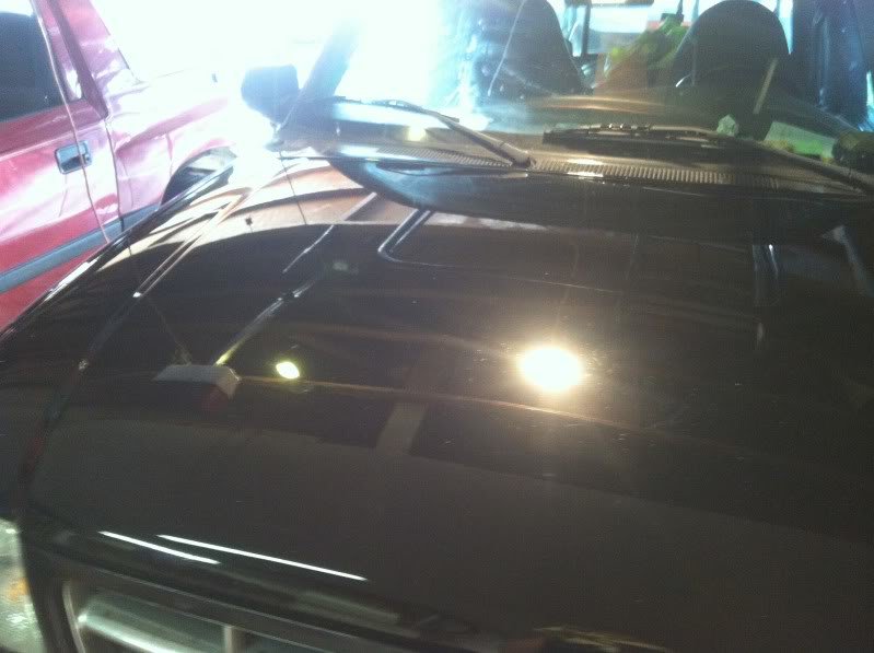

    all done

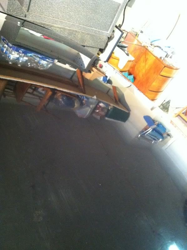

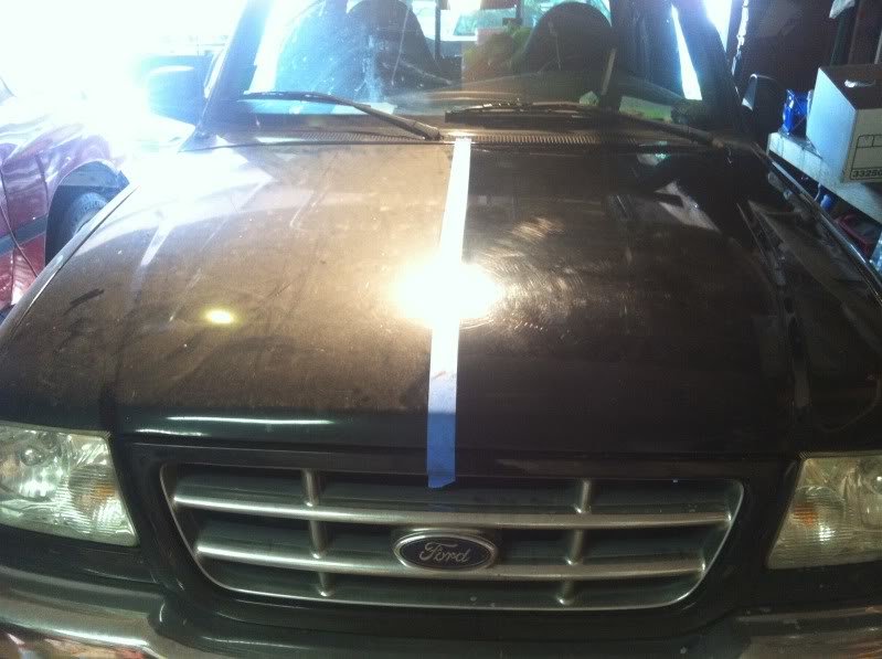

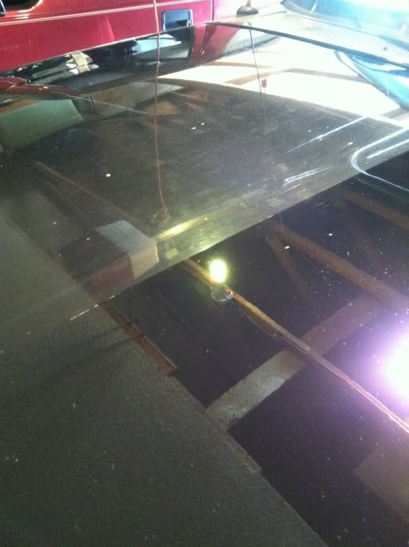

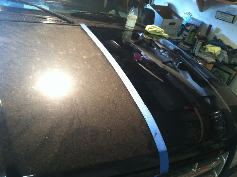

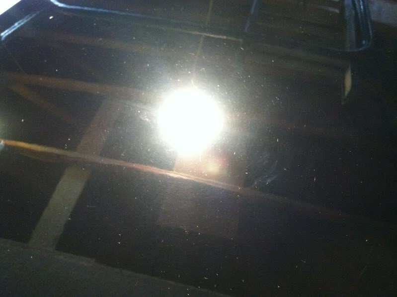

    Washed and clayed

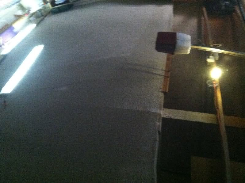

    had to call cutting on the left side quits early, so it doesnt look near as good as the right side.
