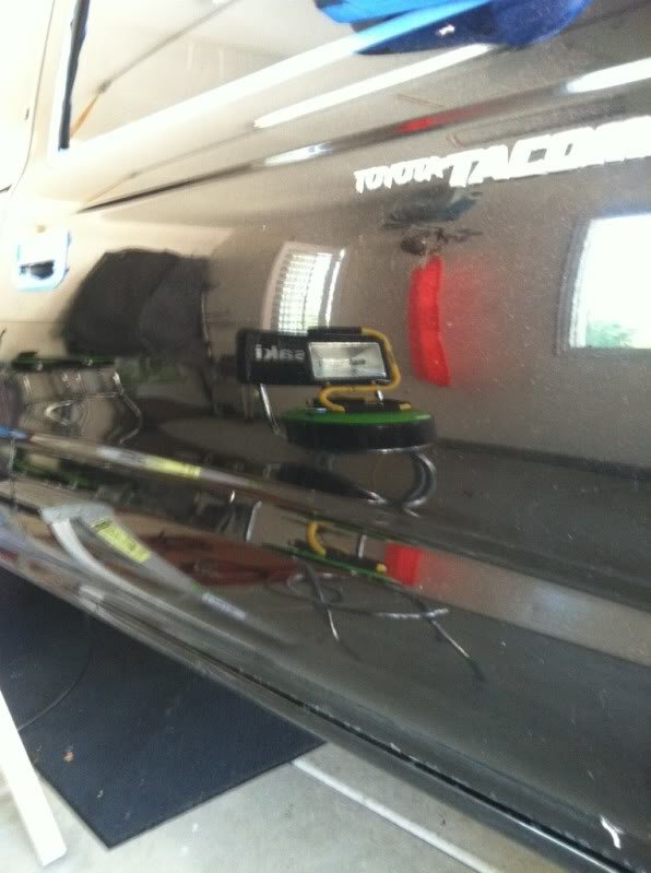

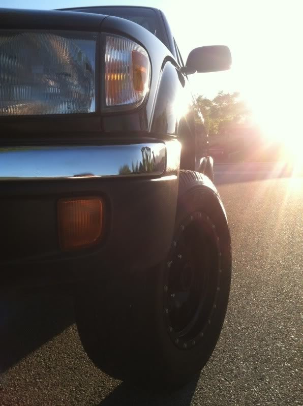

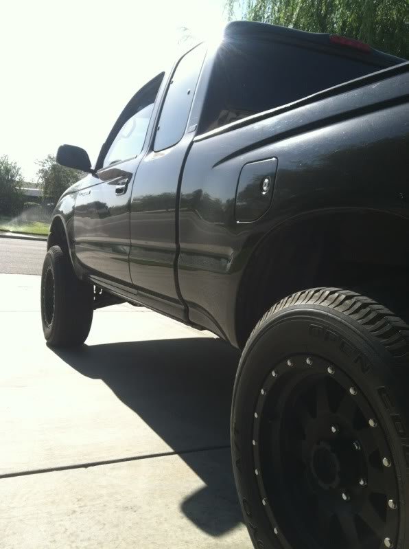

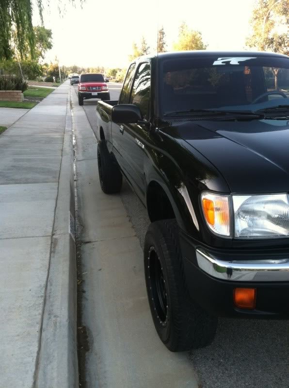

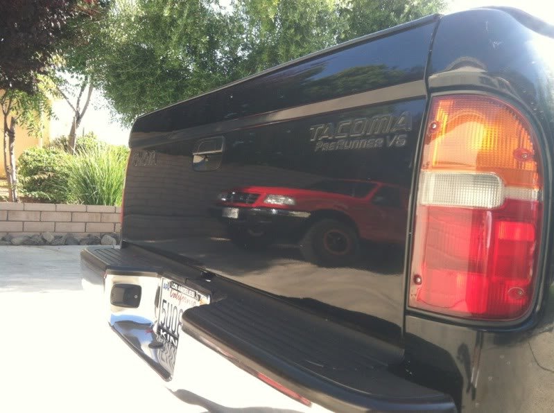

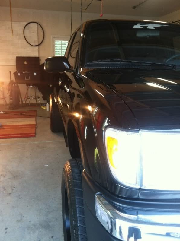

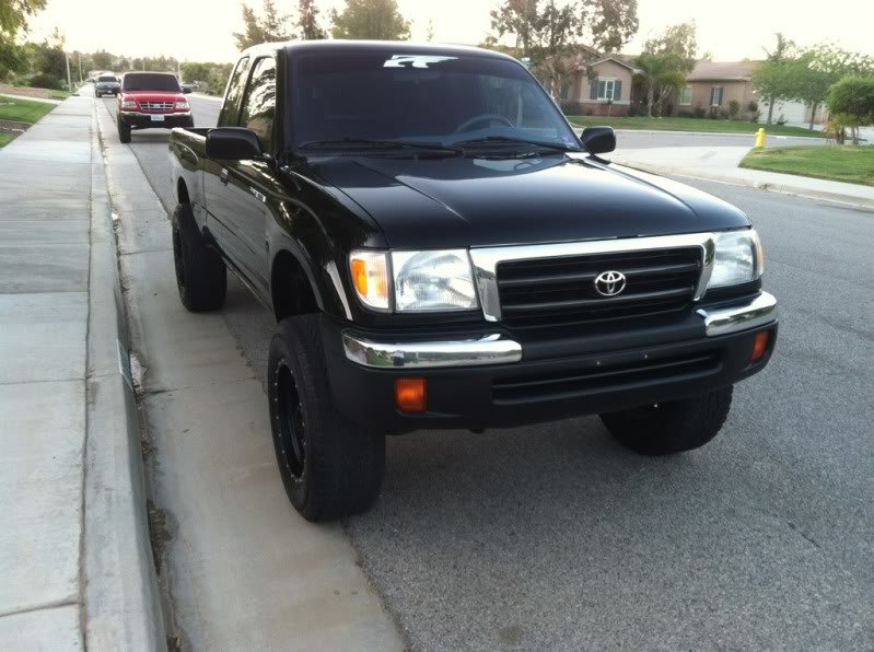

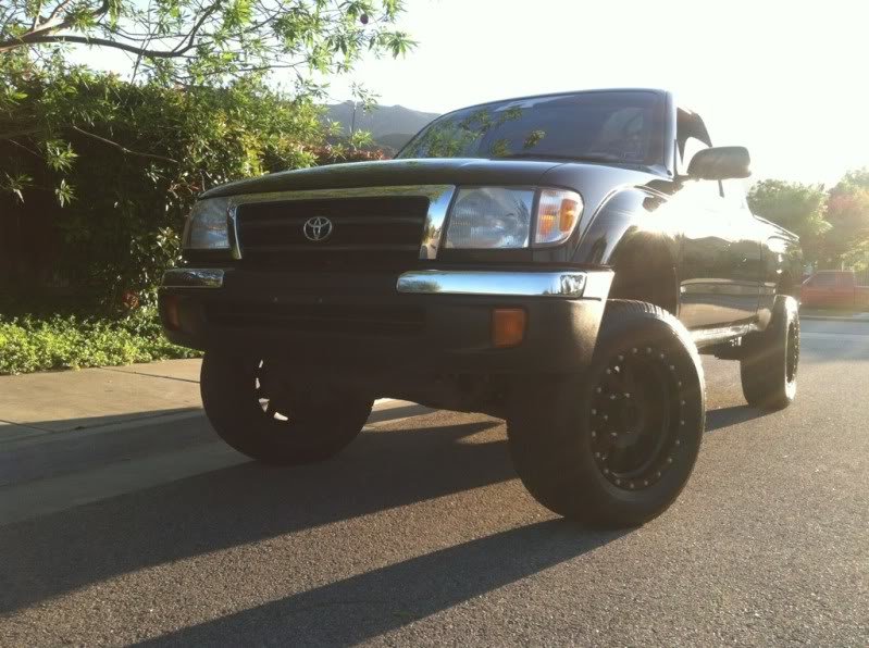

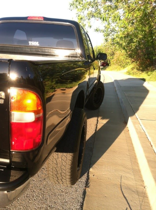

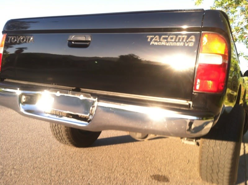

    Anyways, took about 14 hours with help.
    Process used:
    Hand wash with a wax and polish oil remover
    removed tail lights, TBL, license plate and wheel bolts
    Taped all the rubber off
    Megs MF disk and D300 compound
    Black and White pads and Menzerna SF4000
    IPA wipedown
    Menzerna Powerlock sealant
    C/G paste wax

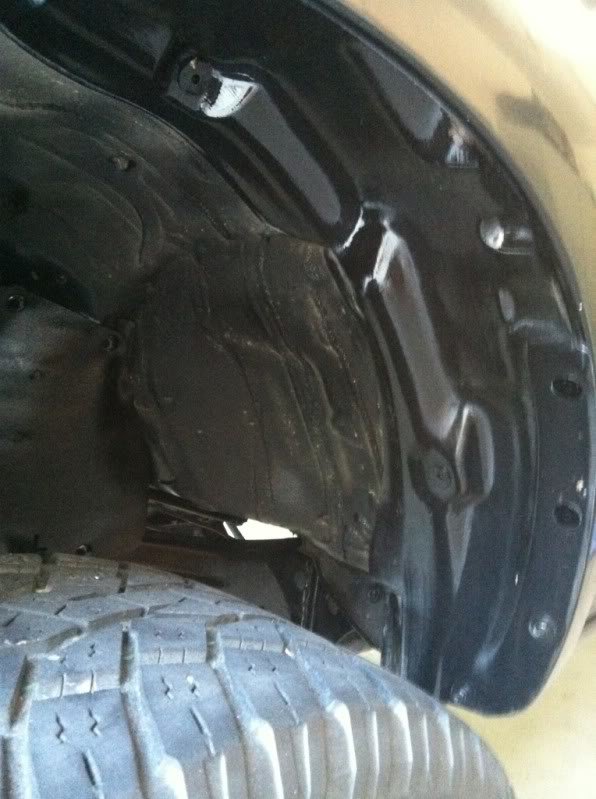

    Dressed the tires, wheel wells, frame, leaf springs basically the whole undercarriage

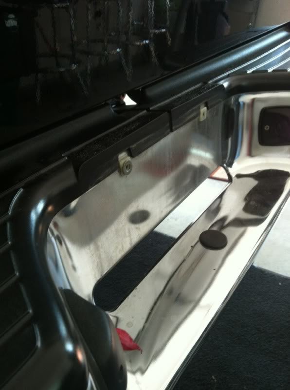

    Polished chrome
    Polished, sealed, and waxed door jambs by hand
    all plastic (headlights, tails etc) were sealed and waxed as well
    Didn't touch the interior or engine bay (ran out of time)
    Sorry for not getting very good quality of pictures, was pressed on time.

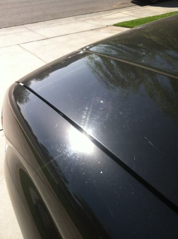

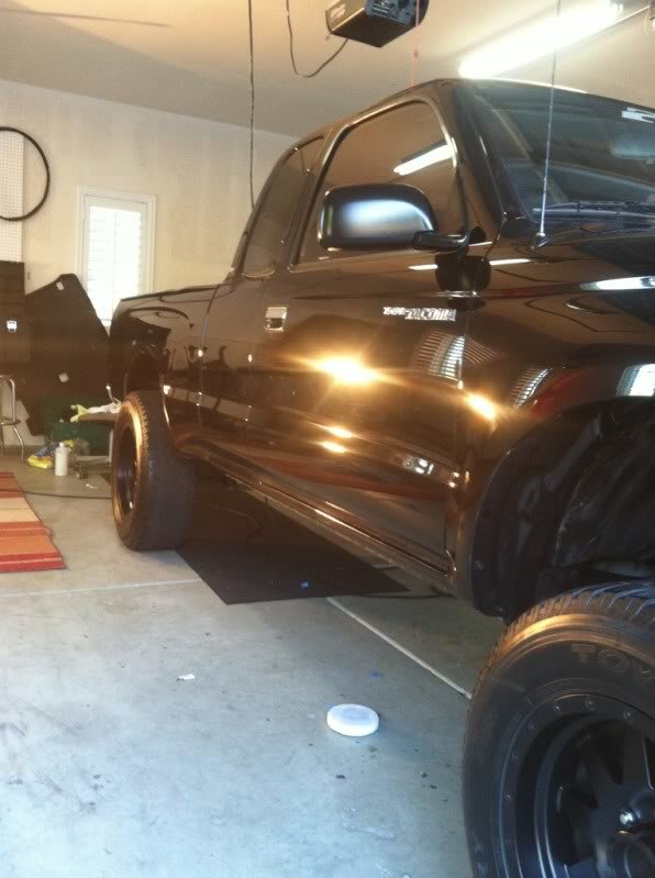

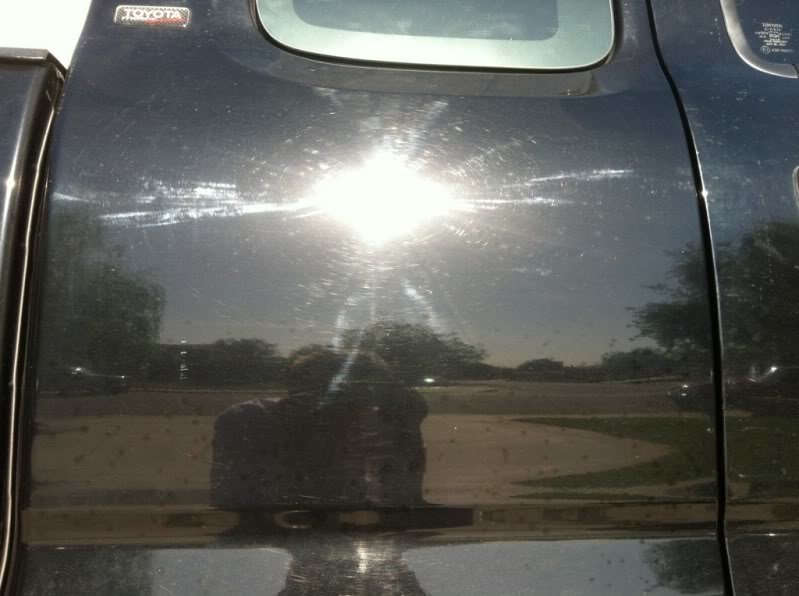

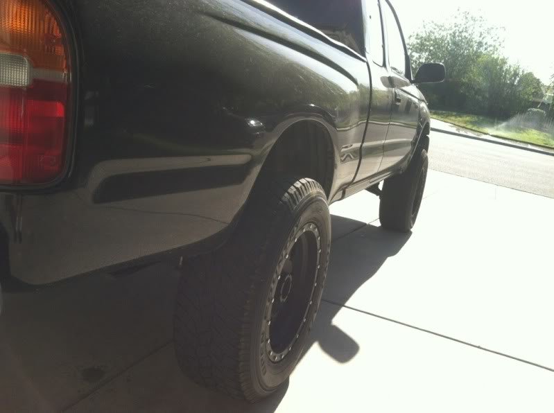

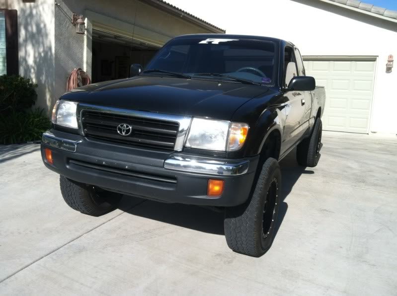

    Here she is as she showed up

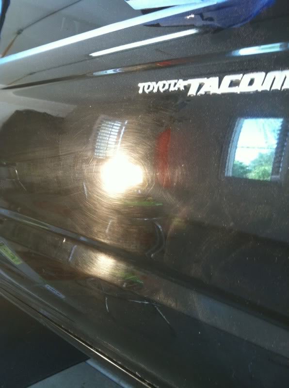

    Holograms and hard water spots

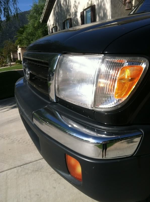

    faded bumper and chrome

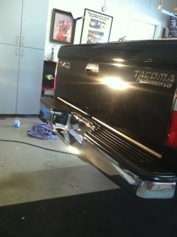

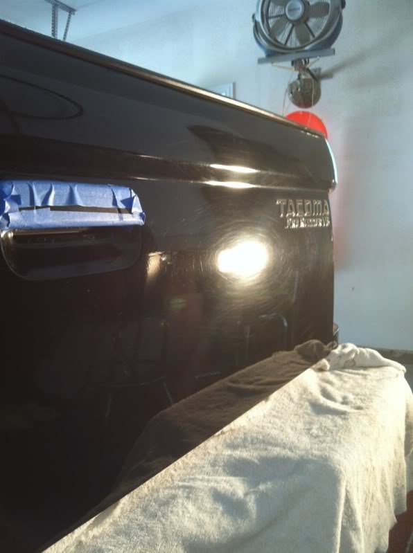

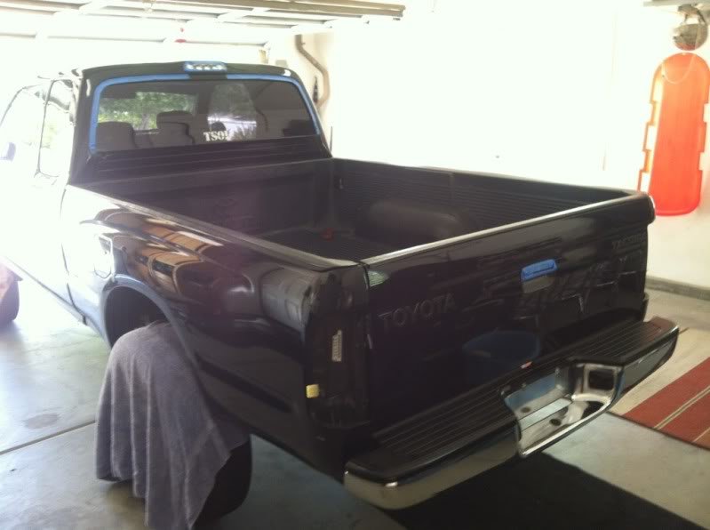

    all taped up

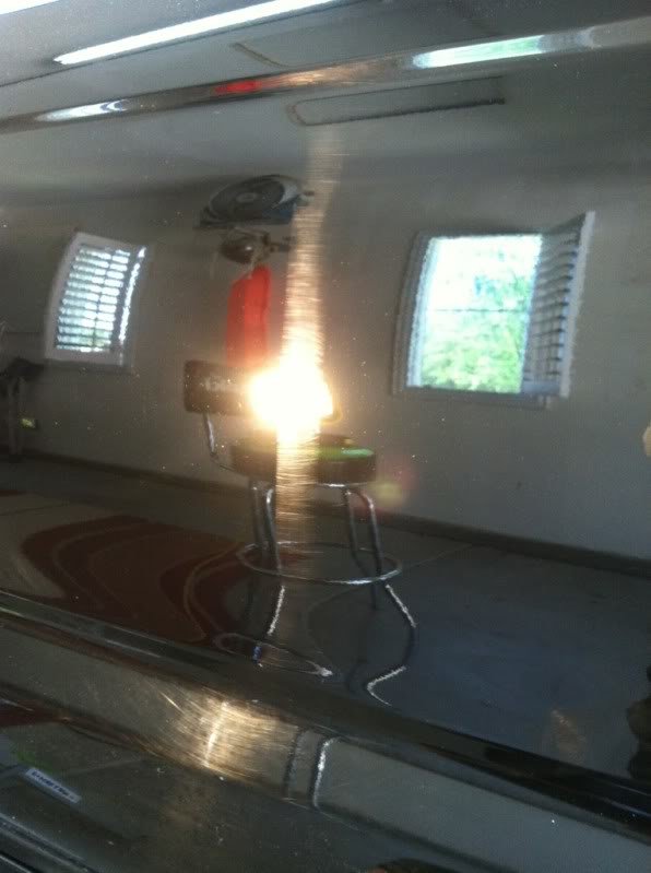

    clean right?
    wrong.

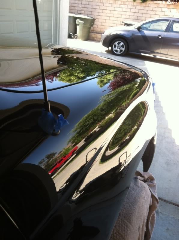

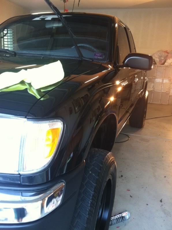

    little bit better

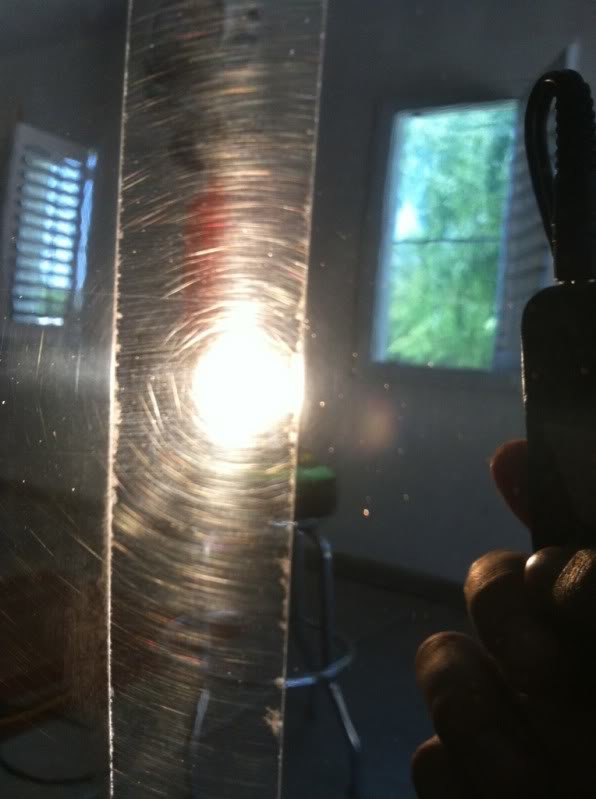

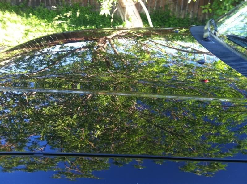

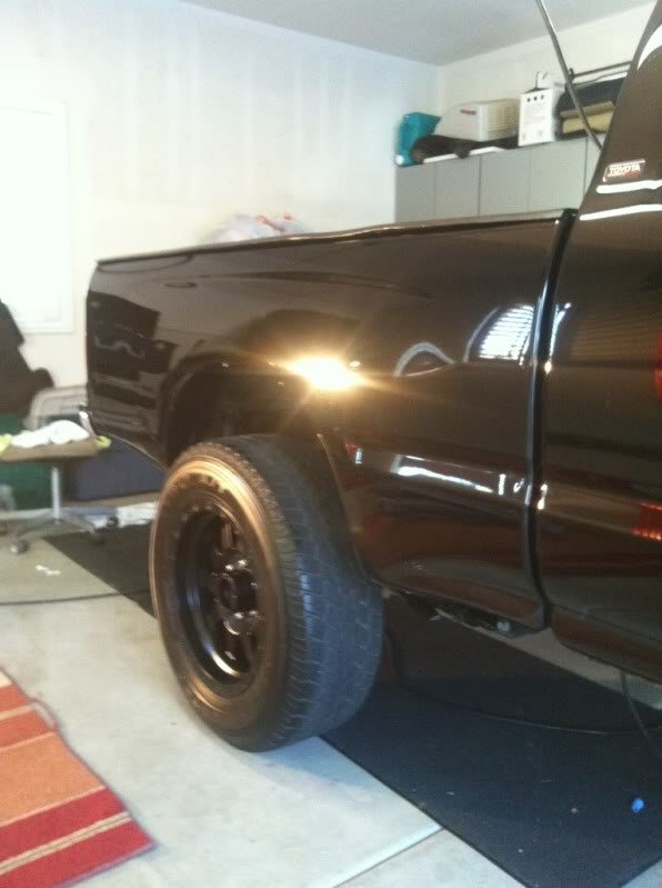

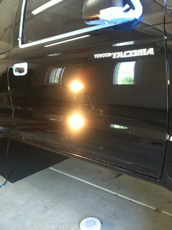

    Left side is after compound, before polishing. middle is un touched, and the right is after compounding and polish.

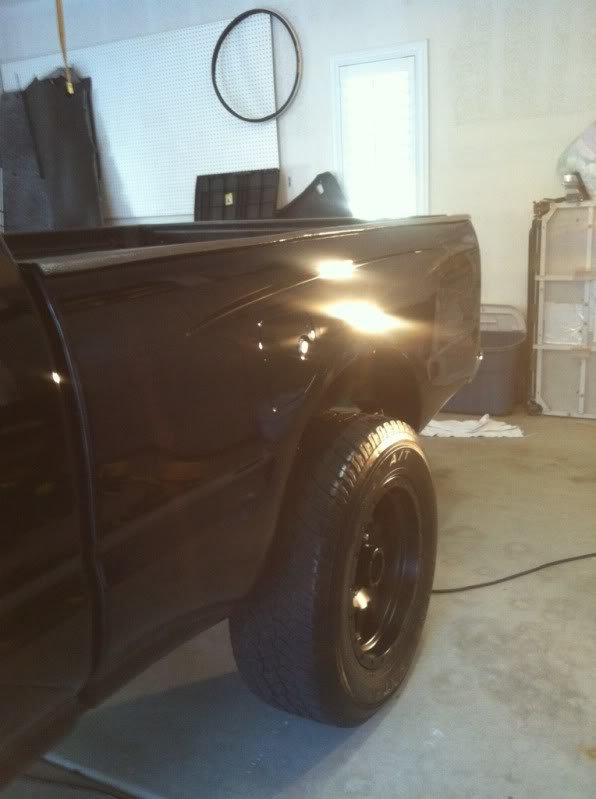

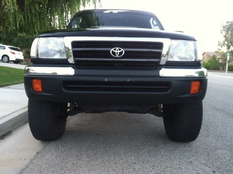

    Time to move her out side.

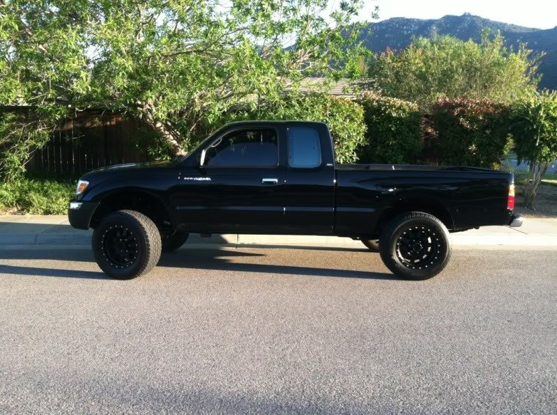

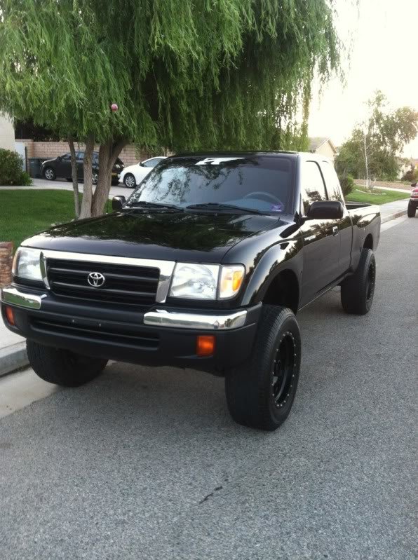

    my baby at the time
