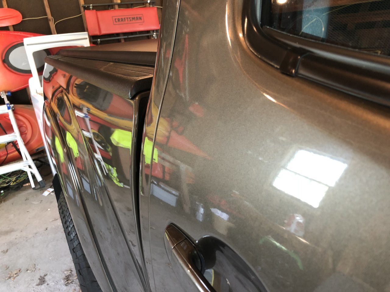

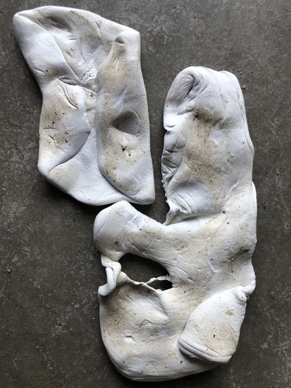

    This is the first time I’ve ever tried a clay bar kit. This stuff really works and works well. There was all kinds of junk stuck to lower sides of my doors. Absolutely wouldn’t come off when washing. Clay bars took it off. Had to work it a little on the bad spots, but got about 95% of the crap off. Cleaned the clear coat up really well. Truck looks nice and glassy now after waxing it.

    I was a little paranoid at first. Just seems like it would damage the paint rubbing something like that on the clear coat. But it worked. The kit I bought came with the meguiars quick detailer spray as the lubricant.
