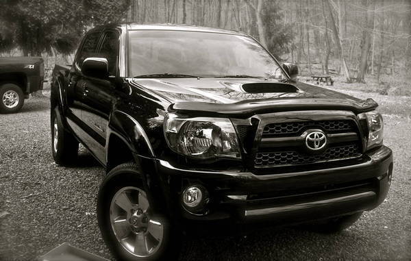

    Hand wash, CLAY, seal, wax...
    It was amazing what the clay took off..
