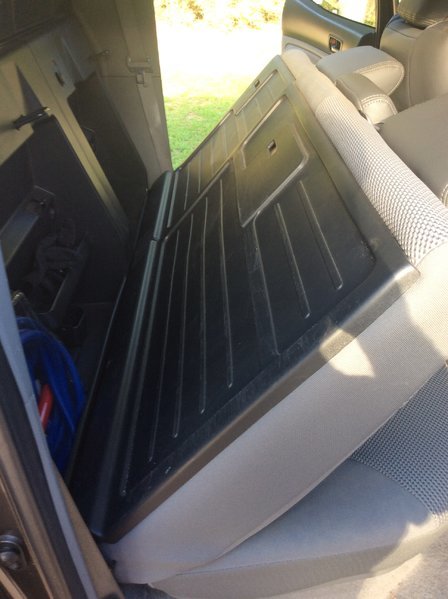

    They just go over the trays. Hardest part will be middle seatbelt top trim piece. It takes time and use the tool but it will go over it. They look great don't they.

    Thanks for the info. Where the storage box is behind the left rear seat back I couldn't pull the cover by it and then I removed the storage box and it still seemed way too tight. I try again tomorrow afternoon.
    I'm impressed with the whole kit except for the center console cover.
    I would have liked better instructions but YouTube was there LOL
    They look and feel a lot better than the front seats with 155k miles on them. They are awesome!!!

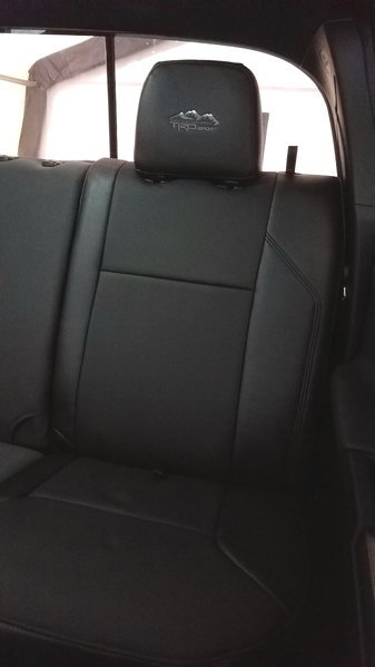

    Did you turn it halfway inside out first. Mine is a 3rd gen but should be the same.

    Man that looks great. Thanks for posting the pictures. I guess I'm being too careful. Watched a Ytube video of a guy from Clazzio installing the right side on a Tacoma. I'll get the backseat done this afternoon.

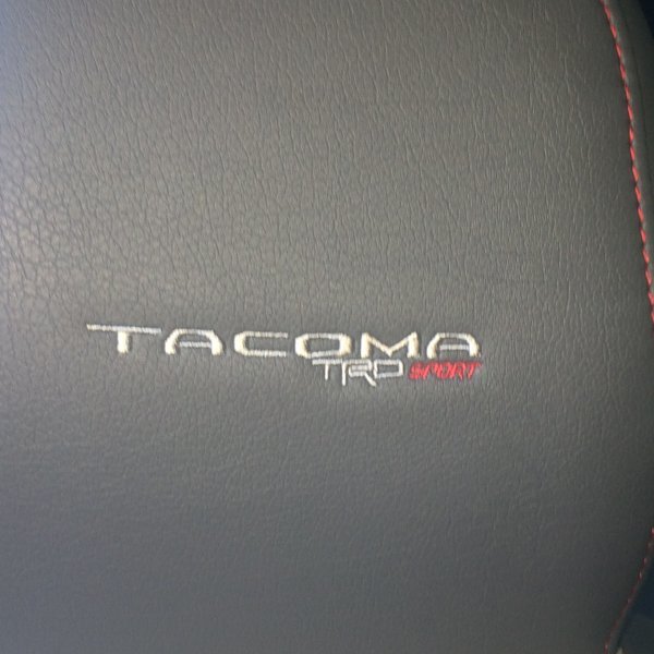

    Oh, and can you send a pic of those headrests? That is pretty much what I have settled on for the Clazzio's. PM me and I will give you my email.

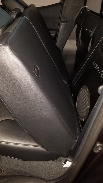

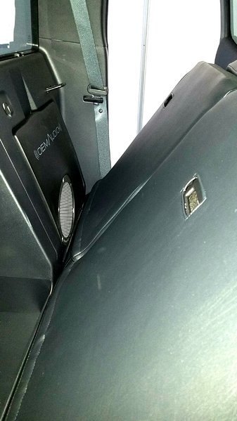

    I am a stereo nut. I have put systems in everything. My 98 Ranger has a $7k system. I like clean, clear, realistic reproduction music. My ranger can thump if I want it too...if you want to thump, the 450 is not for you but it does have great bass. I'm very impressed with the 450 and with the install taking hours instead of weeks makes it worth the money for me. I did the clazzio's first. Just have to undo the Velcro bottom to unbolt the seat. The clazzio's will not interfere with the sub.
    This is just part of my ranger system.

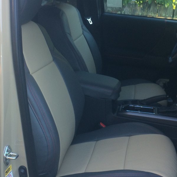

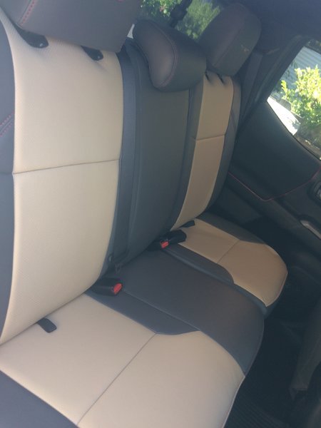

    Custom leather Clazzio seat covers

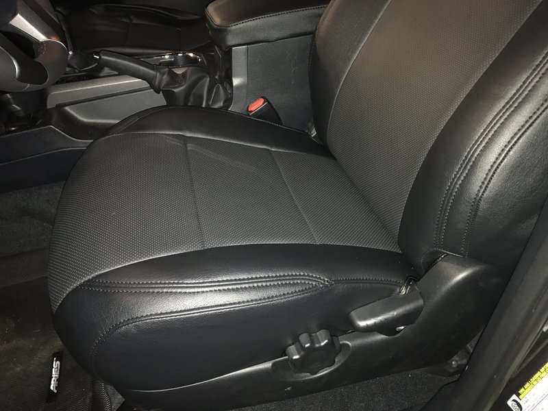

    Got one installed. This is the second set of clazzio covers I've had and again, couldn't be happier.
    DrFunker and 20tacoma17 like this.
